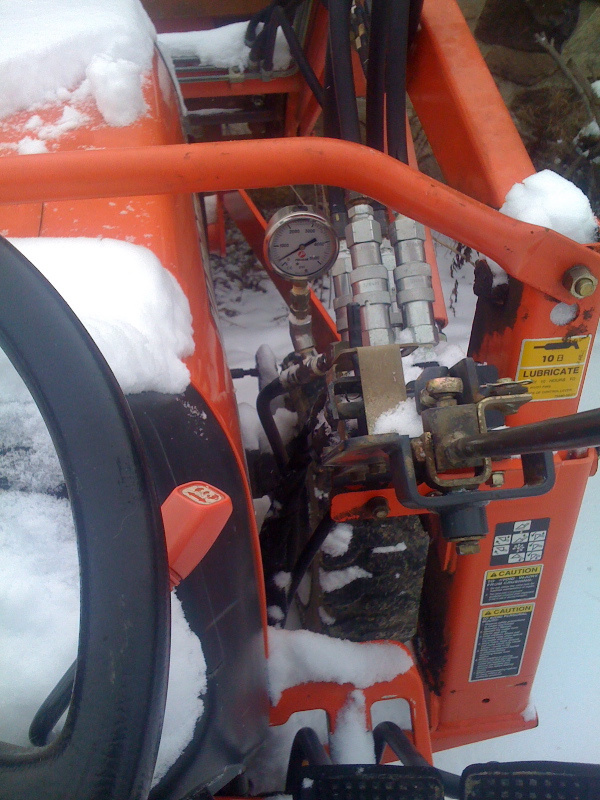

When I first checked mine the pressure was to spec, but sometimes the loader would struggle to break out with a bucket load of compost. Decided to shim the regulator 15 thousandths, so pulled the relief valve, inserted a shim, seated and torqued the valve, and checked the pressure. Wow, 3300 psi. It turns out the dealer put four shims in the relief valve and only turned in the valve enough to set the pressure at spec. When adding the shim, I bottomed the valve and instant, unexpected pressure boost. Ended up removing the added shim and two of the dealer shims to get 2650 psi. Thank goodness for gauges. At least I have to give the dealer credit for checking and setting pressure to spec when the tractor was new.
   / Bump up lift capacity of L3400/LA463 Loader #113
Changed the hydraulic fluid in my tractor tonight. Could not think of a better time to check the hydraulic pressure. It was set at 2350#.
Bought an assortment of washers at the hardware store, but couldn't find the little bag they were in when I got home. I looked all over the garage, and the best thing I could come up with was a backup washer for some 3/16 rivets. Too much pressure, went to 3000#.
Finally went to the truck & found the washers (they ended up under the seat:confused:).
Put one stainless #10 washer in (quite a bit thinner than the washer for the rivet. I hit 2500# on the dot. I quickly drained the rest of the fluid, changed the filter & re-filled the tractor. It was getting dark at this point.
Hit my sand bank & got a huge bucket full of sand. No problem getting the bucket out of the pile. I'll do some more testing tomorrow night to confirm. I may end up with one more washer before I am done, hopefully this will give me another 150# increase. The SS washers seem to be quite uniform in thickness, so this should get me close to 2650#.
There was no shim at all in my relief, just the spring.

If one more washer gets you to 2650, that sould be about 300lbs additional capacity at the bucket vs your 2350psi. Not to bad. But it It sure would have been nice if kubota had just made an adjustable valve. Like on most other hydraulic systems. Just loosen a jam nut, tighten a bit, an re-lock jam nut. Boy that would be nice:D
   / Bump up lift capacity of L3400/LA463 Loader #116
I bought the washers from Kubota for a few dollars and in the manual for the L4400.
The shims add aprox. 38.4PSI for each 0.1mm added.
It only takes 30 minutes start to finish to make the adjustment.
I would not exceed the upper pressure limit by much.
Here is a link to making the adjustment that I did foir a friend of mine who has a L4400HST just like mine only he has a Backhoe on his.
FEL PRESSURE CHECK and ADJUSTMENT
