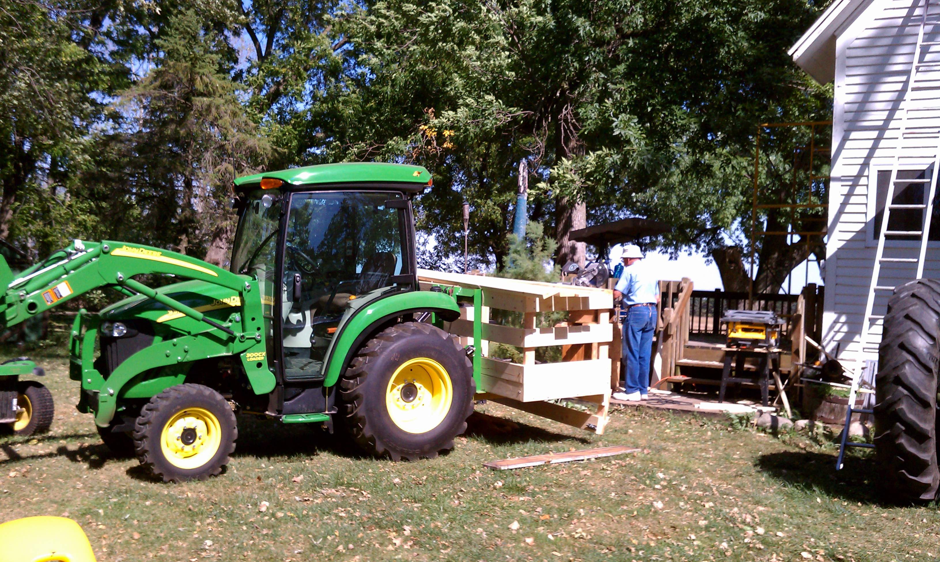

Today I had my first try out for the "carry all"View attachment 278215View attachment 278216. It i worked perfectly along with the Kioti tractor. I know these logs weren't the biggest but the 3 point lifted it with no problem.The front end didn't seem light and there was no logs in the FEL. The best part is my welds held up to the weight. ( I'm not a welder)

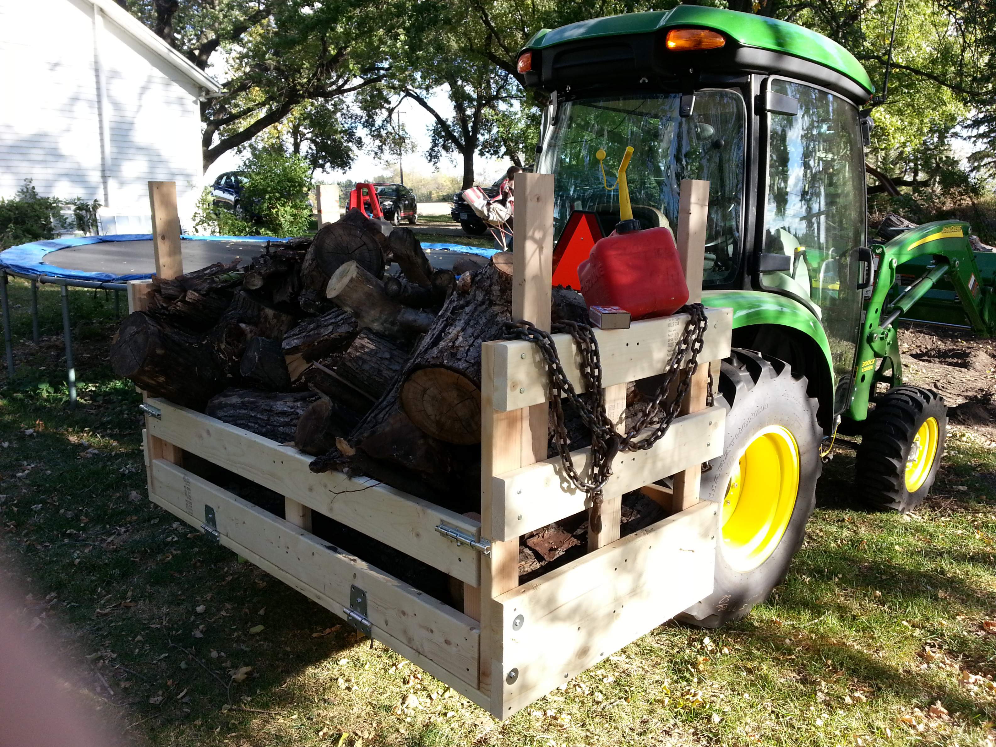

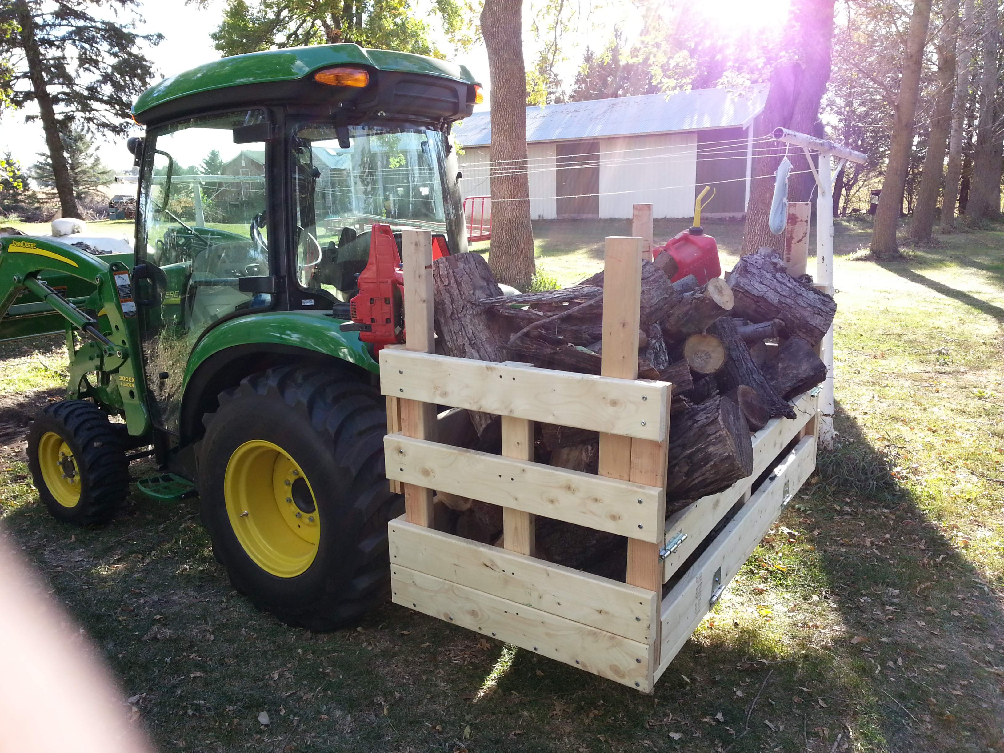

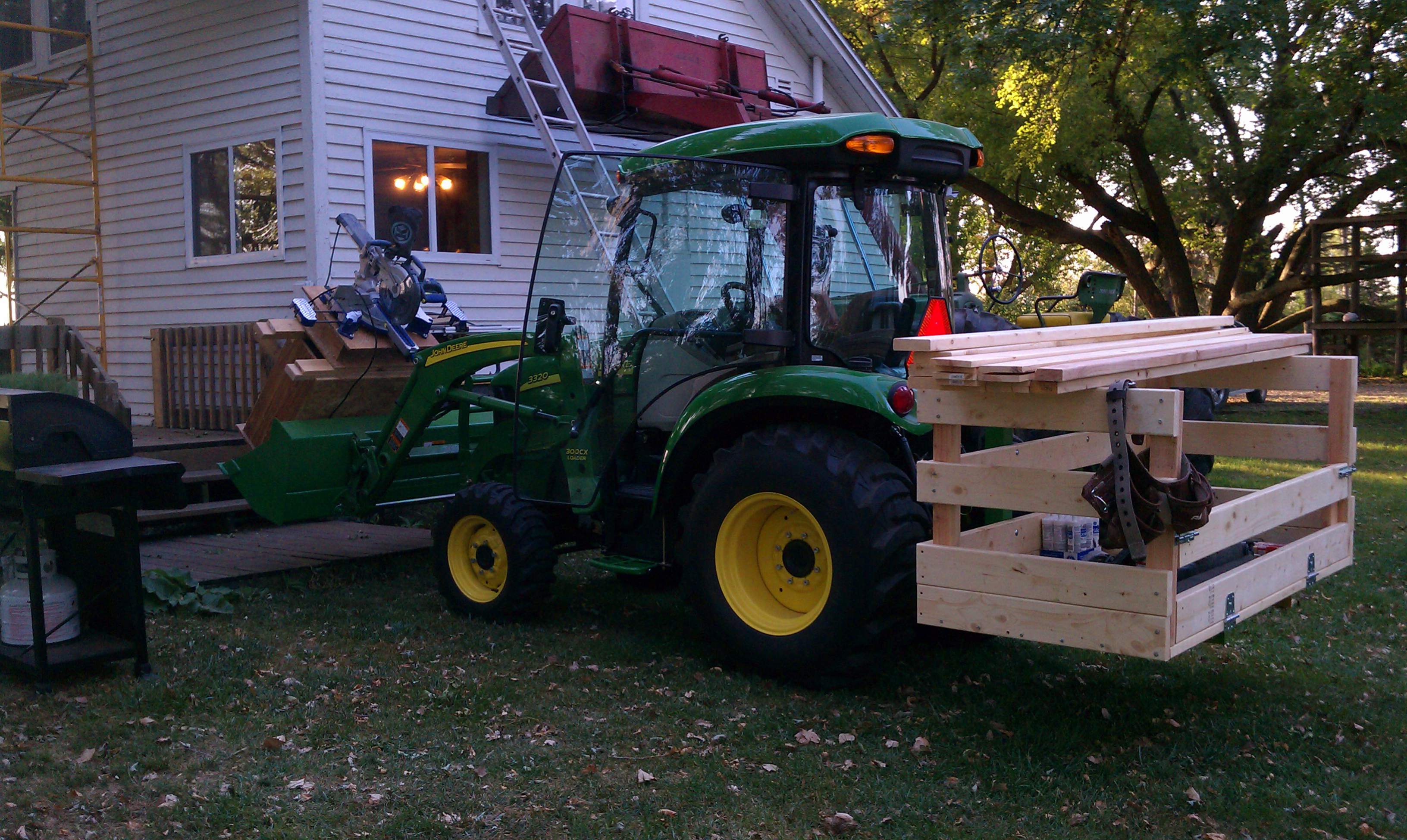

I figured i would post into this threat VS making my own seeing as i took 90% of the design points from you.
I'm not finished yet but here is what i have so far. The upright 2X4's are for when i carry plywood. The last picture was before i added those and the wood kept sliding off. and yes thats gas and matches next to each other don't ask haha. just kidding i found the match book sitting somewhere and i tossed it on the carry all to bring to the shed.

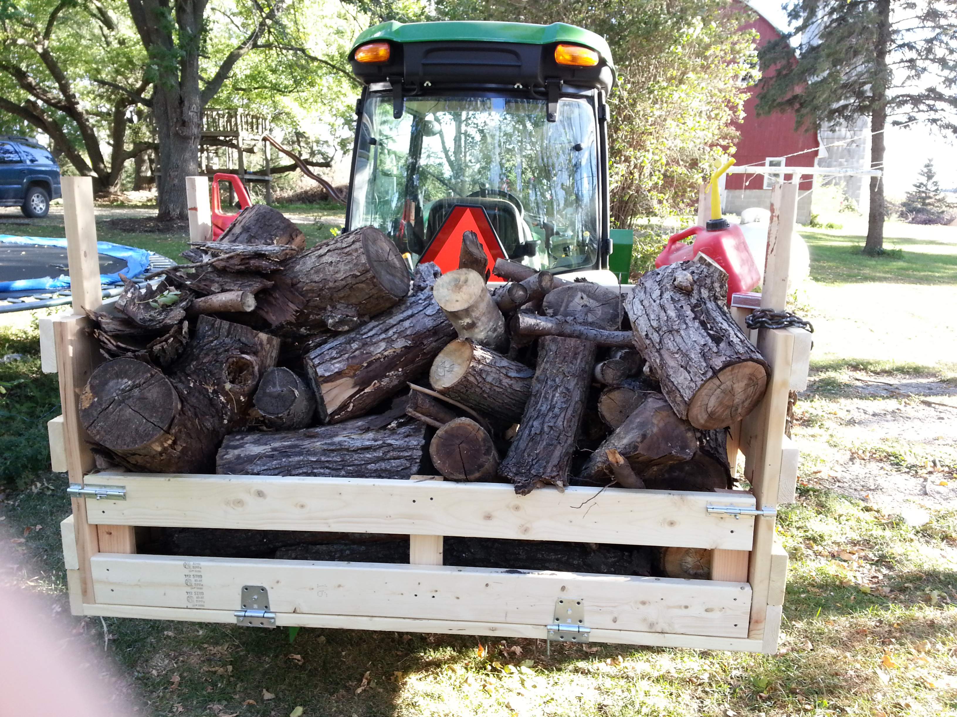

It looks great!!! I love mine. I use it for a ton of stuff. ( firewood, garbage out to road, add a couple of chairs and cooler for tours of the property etc.) I was worried about the tractor having enough power but with the box heaping with firewood ,saw, gas the thing has no problem with the load. It was a great add for the tractor.

The last thing i want to do is add a reciver hitch to it so i can move a trailer from time to time without having to remove the carry all. The thing is i need it tucked under so the little door can still swing down.
But a hitch for me is a must. that should be the last little add item i think. but who knows i keep thinking of things to add to it.

That's funny you mention a receiver. That's exactly what I was going to do also.I figured I could tow the splitter right behind the box.
