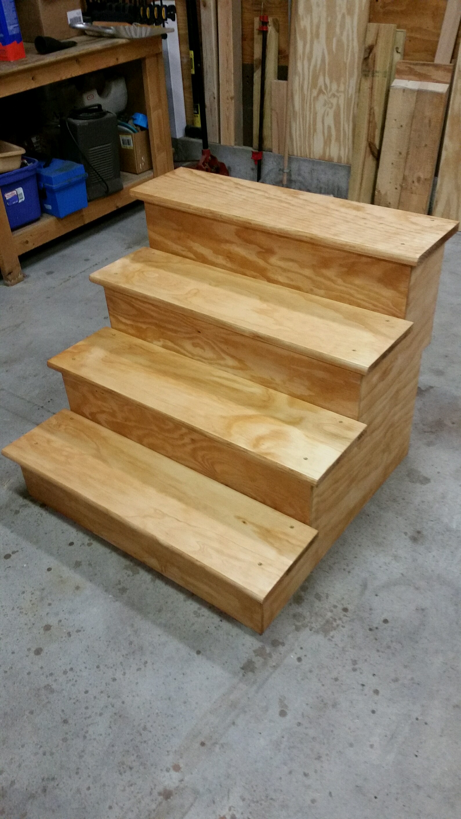

I have built several stair units around the house. Mainly for the deck but I did just build these. They are for the garage to house entrance.
I had the plywood laying around the garage but the steps are the 5/4's pine from Home Depot. Nice wood for 9 bucks each.
