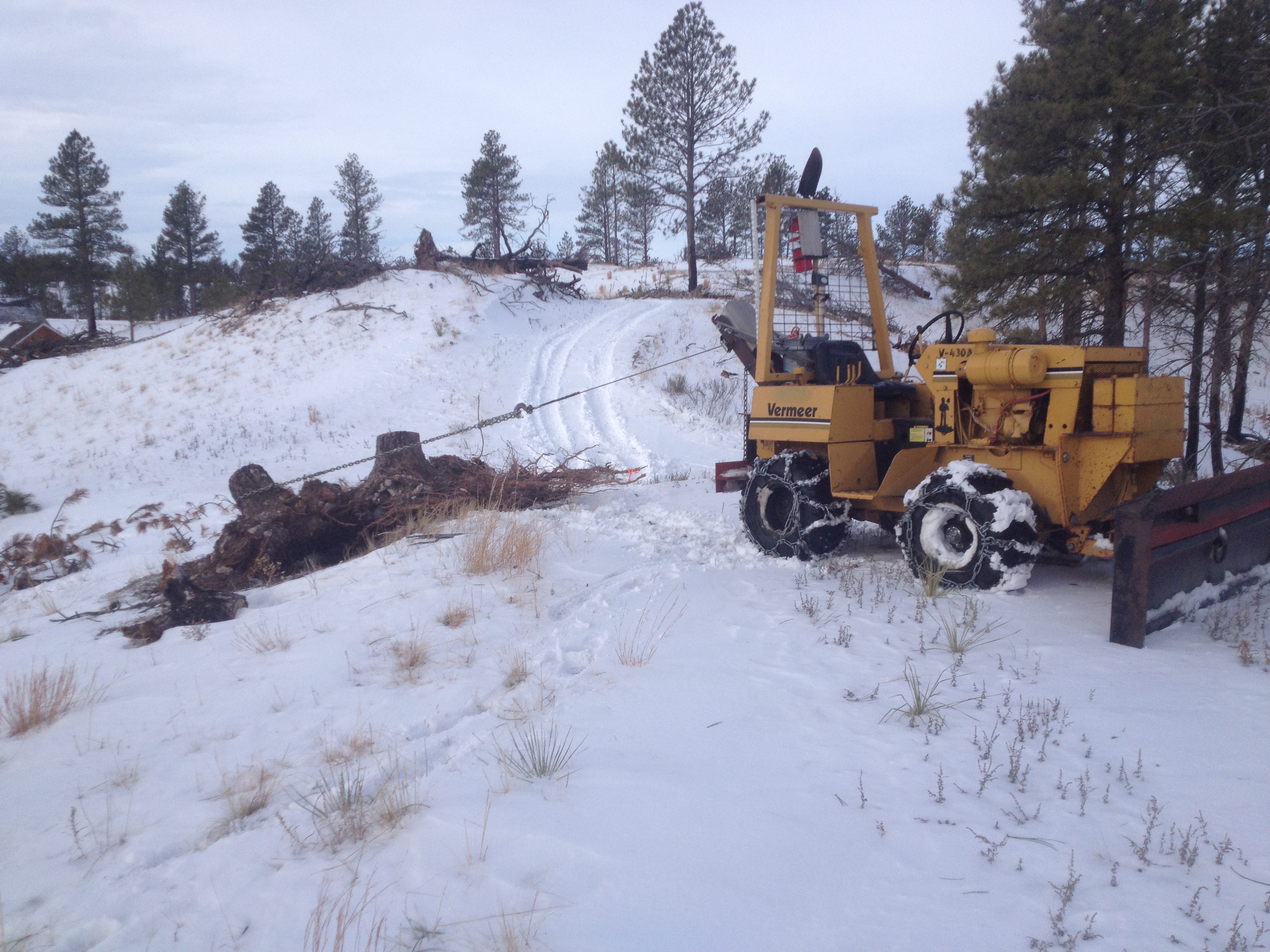

Im building a 8x8 articulating mini forwarder, the only ones you can purchase are in Europe and are very expensive, i believe i can build it far cheaper.
So, you are looking to build something like this?

That is a cool forwarder. I need one of those to go with my mini skidder
