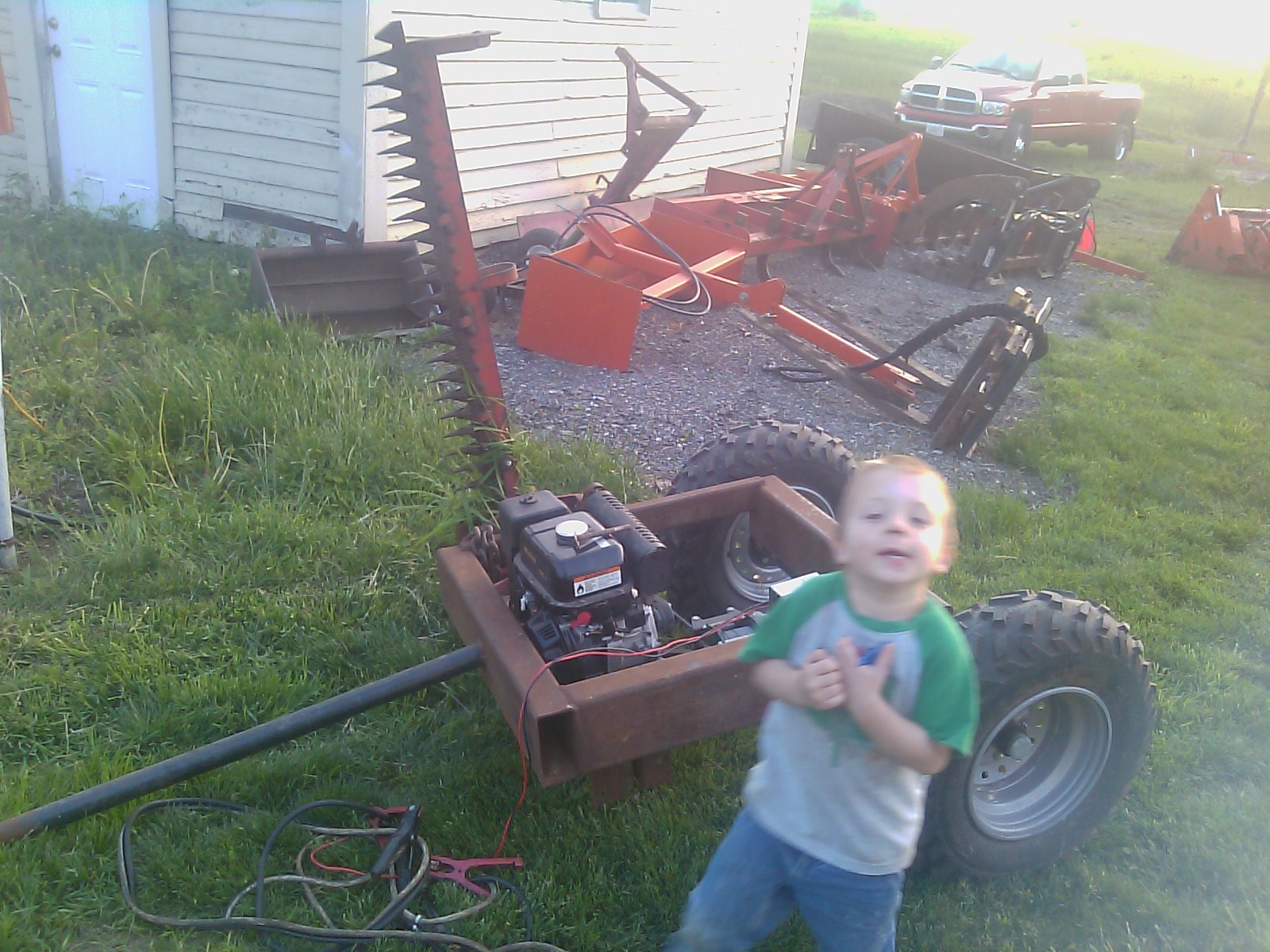

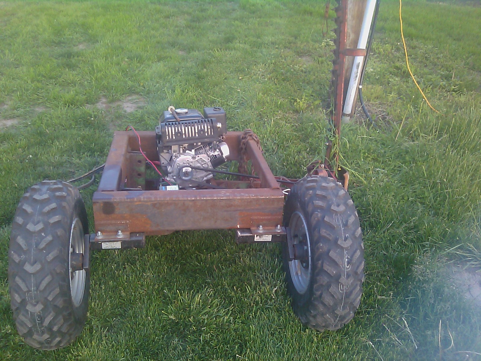

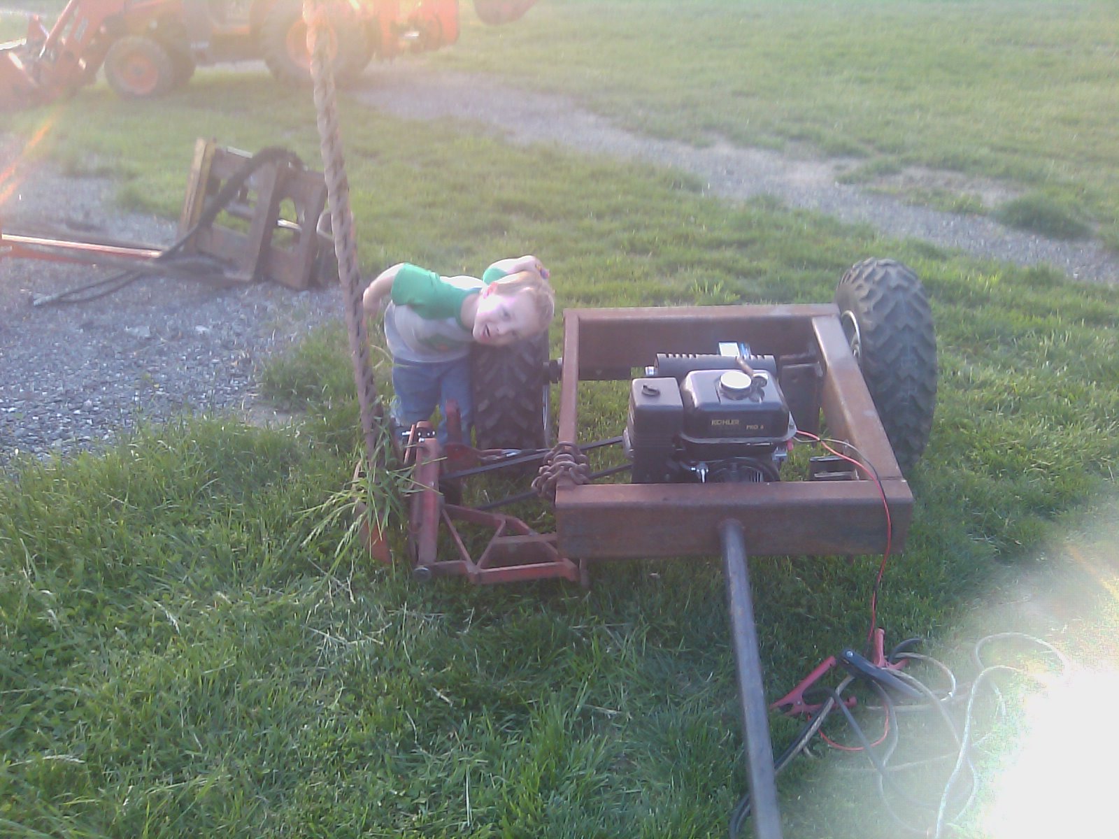

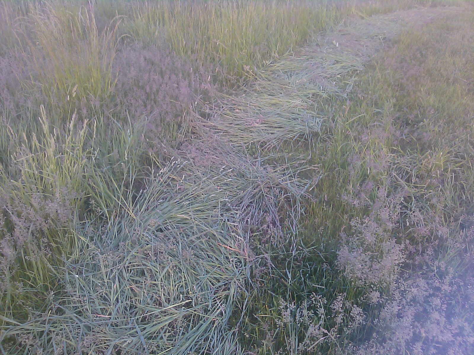

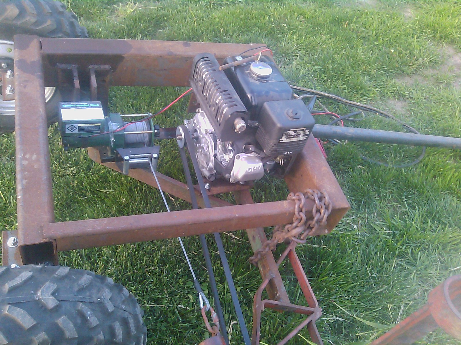

FINALLY finished it just needs paint.
Used it tonight on the driveway and cut a little spot on edge of hay field it worked well. This weekend I will take it to the pond and see how it does. I ended up going with a belt and no clutch. it works well and handled off cambers and the break away works good.
