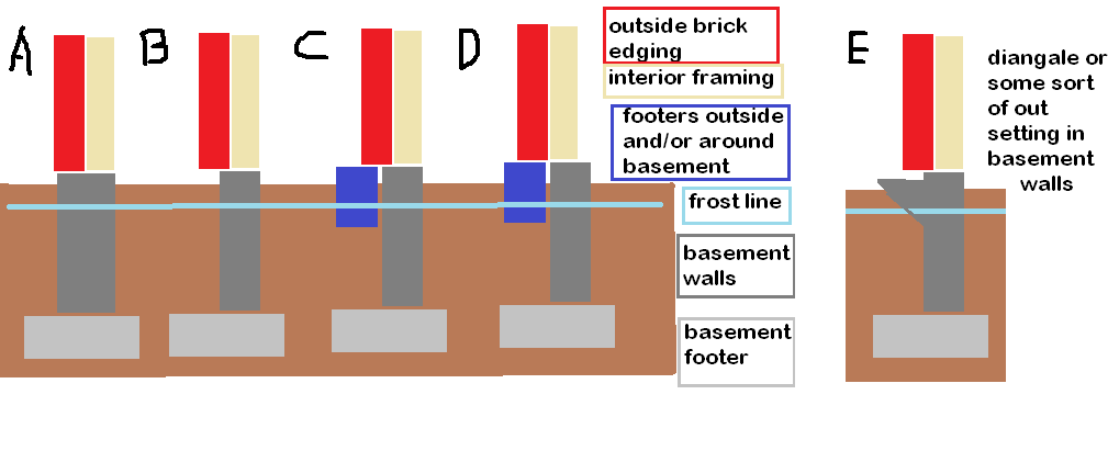

I've been staring at online diagrams and think I finally understand ... duhhhh. The front and rear basement walls align with the front and rear walls of the house. "IF" they build a ledge into those basement walls for the brick, they have to do the same for the rest of the house to keep everything in line. OK. These basement walls will span about 30 feet.
I may have them pour those walls without the ledge. I can then have them enlarge the rest of the pour for a ledge. I'll have to add a separate footing along the 30 foot basement spans that will line up with the rest. Hey ... It makes sense to me! LOL I guess my meeting tomorrow will be to explain what I need done.

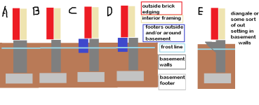

different configurations. might help get something out of your contractors.
i am a tad confused on basement floor plus footings. i am more use to seeing "monolithic pouring" were basement is dug down to grade, then a mini ex (mini excavator) or like comes in and digs a little trench were footers will go. and then footers and basement floor is all poured at one time.
but from what it looks like, they poured footers, and you are going to need to "fill back in with dirt. or having the concrete floor of basement setting inside the footers. are they going to bring in rock, and compact it inside the footers. and then pour concrete for a floor. so concrete pad rests on edge of the footers?
i am also confused by a footer down the center, and the square box area of a footer.
Thanks for the image. My plan above was the "D" diagram you shared - although I will make that support piece somewhat wider for stability.

Thanks for the image. My plan above was the "C" diagram you shared - although I will make that support piece somewhat wider for stability.
If I were you I would strongly suggest digging your heals in and making the contractor go with plan "A". There may be some extra expense with wider walls and more concrete but this lets the stone rest on the foundation wall and carries the weight directly onto the footer.
The problem with plan C is soil compaction. The basement is overdug and needs to be backfilled before pouring your extra footer for plan "C". It is going to settle regardless of how well you think you have compacted the dirt.

If I were you I would strongly suggest digging your heals in ...
Well "A" was the plan - lol.
I just edited my prior post, having meant to say option "D" but it would also suffer from the settling problem. Option "E" looks like a good compromise. I had considered something like it by attaching angle-iron.
Your image will be really helpful. I printed it out so we can talk about the pros/cons and what responsibility he will take for the outcome. I won't force plan "A" unless things get ugly.

I would strongly suggest forcing "A". Also - The 4" ledge would only need to be added to where your stone sits, so If you have 8" walls planned, you would now have 12" walls anywhere you have stone. The extra wall width would be outward from the original plan but it shouldn't make your house dimensions any larger. Original footprint of framed walls stay the same, just gives you a ledge for stone to sit on.
