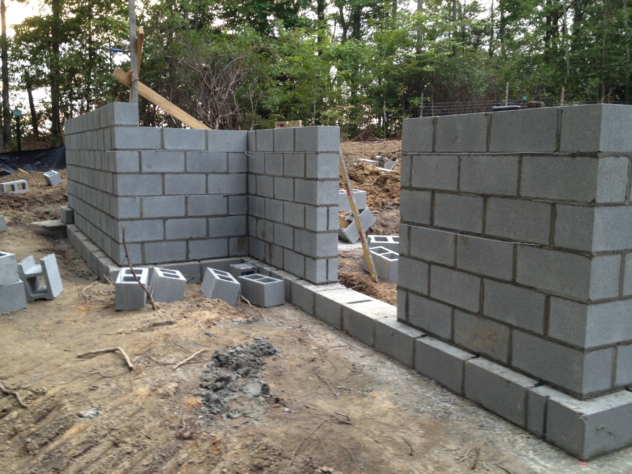

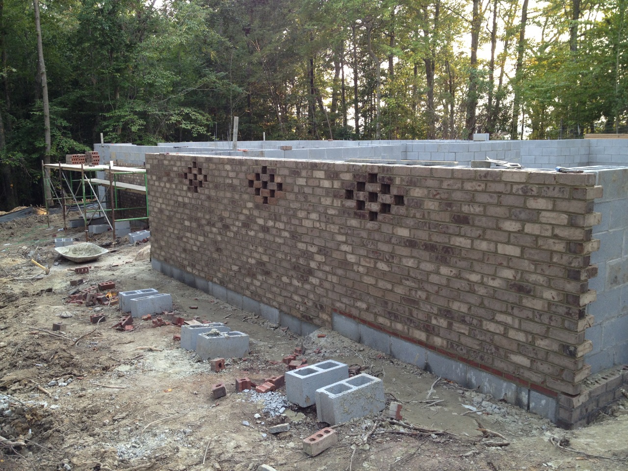

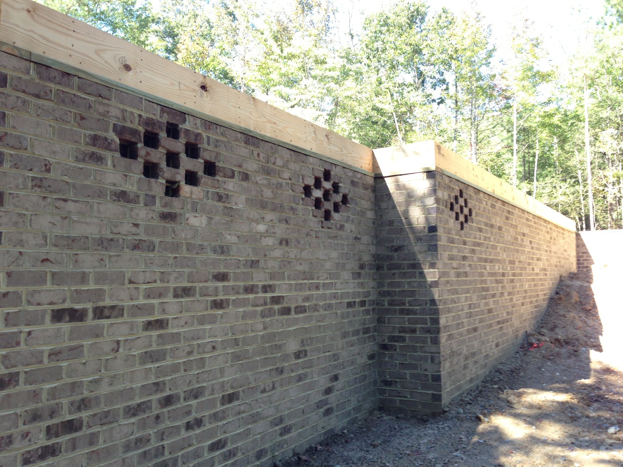

I attached a picture of how ours was done, with block construction. There are large blocks sitting on the footing which serve as the ledge supporting the brick (or stone) for the foundation. Then regular 8" blocks for the foundation walls.
If the home was to have brick or stone over the whole exterior, it would continue up the same plane, resting on the lower ledge, and then framing would be just to the inside of that, flush with the 8" block outside edge (there's actually a small gap between brick and framing/sheathing, but you get the idea).
If the home was to have regular siding, the brick/stone would only go to the top of the foundation. The floor framing wall would sit on the block but overlap onto on the brick. Siding would run on the outside of the framing and lap down over the top course of brick a little.
Anyhow, ours was sized for sheating/siding exterior. If we were to do brick/stone exterior with the same arrangement, the interior walls would indeed move inward the width of the brick/stone and gap (so about 4"). To maintain the same interior space, the foundation would want to be sized 4" wider all around.
