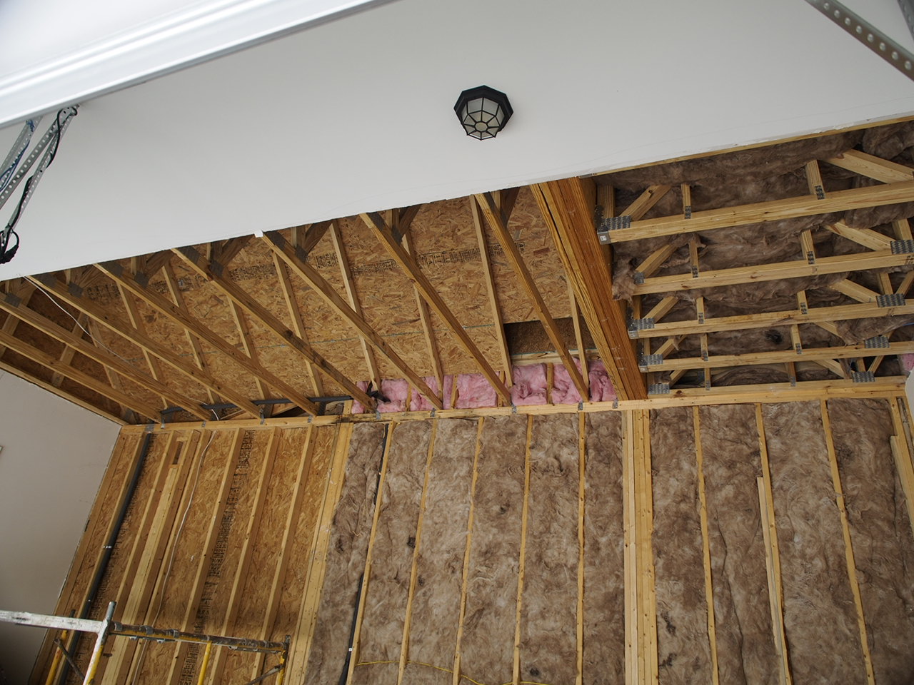

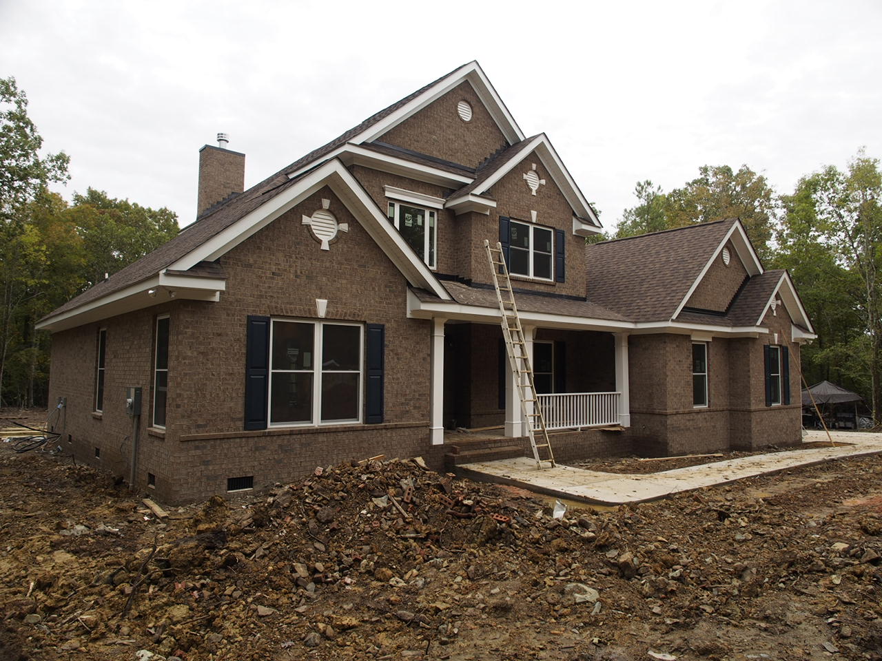

I was taking a picture of my chimney for another reason, but you can see my ridge vent (Certainteed Mountain Ridge) in the attached picture. My roof is also the hip style and I am getting good overall ventilation. The height transition ridges were also vented, but not the true hip ridges. I think the ridge vent looks fine.
