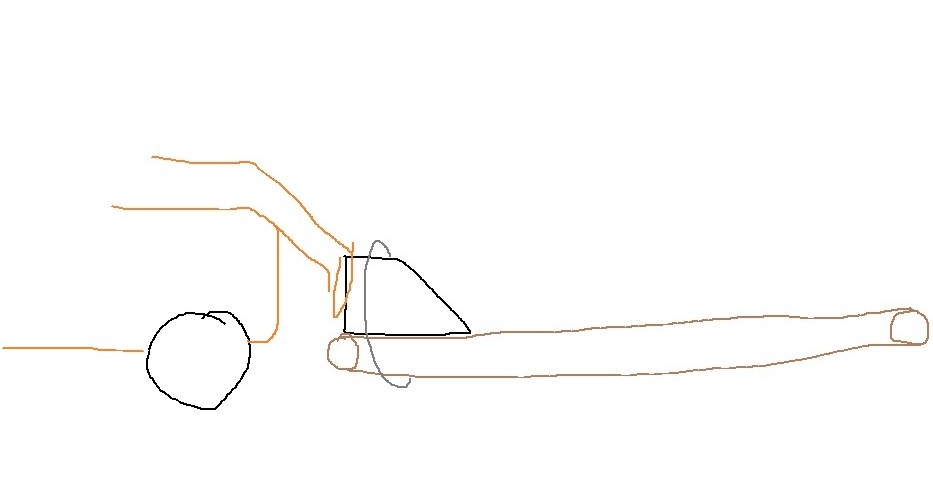

Hey Deezler, I'm new here. Been reading about the bridge you built over your creek. Wanting to do the same but need to know how you dragged those utility poles across the creek. Thanks
   / Building my tractor bridge across the creek
#80
Got your PM and answered there. But in case it helps anyone else too:
Yeah, I wish I had stopped to take a picture of how I did that step - I was too flustered after getting my tractor unstuck from the creek bottom. Here's a crude doodle of it below:
I dragged the poles into a staging position one at a time, as close as I could to the bridge footers on my near side of the creek. Drove up and set my loader down atop the near end of the pole. Chained it up super tight to the loader bucket (pallet forks might probably be better? I didn't have ssqa on my old tractor) - basically like making a boom pole setup on your loader. I couldn't lift the whole pole up in the air, but I could shove it (lifting as much as my little tractor could, to help). So I shoved it up on top of my near-side bridge footer, and then kept going to basically guide it across the creek and finally just above the footer on the far side of the creek, then just set my loader down and unchained it. It worked amazingly well! Any questions, let me know.
I think the same principle will work well with your MX6000 since you have much more loader capacity than I did. But also twice the span. Good luck! Take pics and make a thread here on the forum if you want to get a lot of good advice (and also some bad advice too lol).
