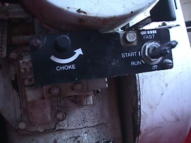

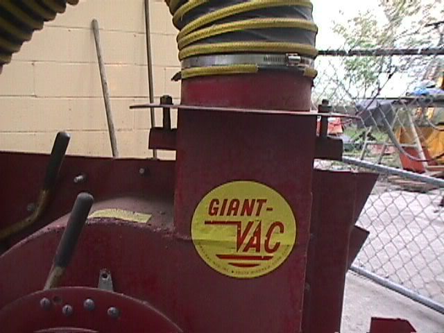

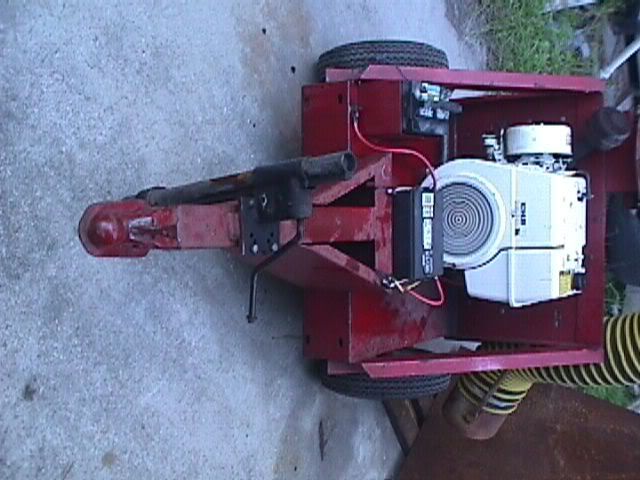

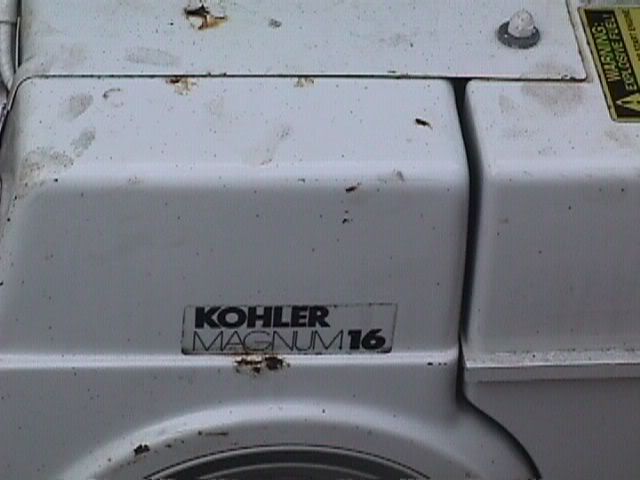

   / Building my own Leaf/Grass Vacuum system #35
Here is the nosecone of the "other" Giant Vac unit I have that has a hopper. I promised Nappy that I would take some pictures of it so he could fabricate a nosecone for the one he purchased from me. They made two sizes of the nosecones, 36" and 42", and this one is the larger one. Due to the size of the blower and the horsepower of the motor on that other blower, I would not hesitate to put at least 42" on it, and maybe think about putting a little bit more than that.
David from jax
   / Building my own Leaf/Grass Vacuum system #36
There are more pictures of the Giant Vac unit with the hopper and nosecone in my Photo Gallery if anyone is interested.
David from jax
