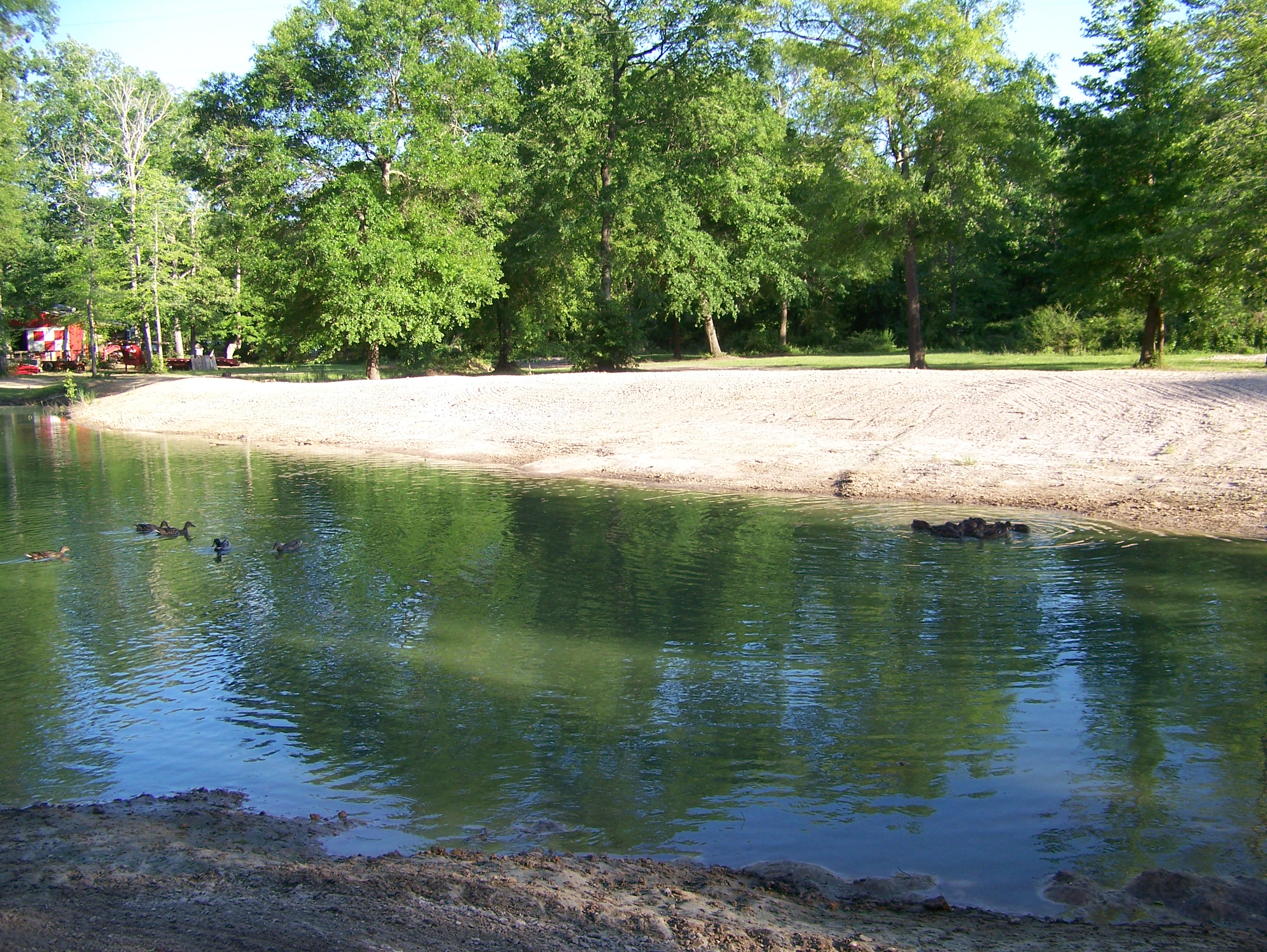

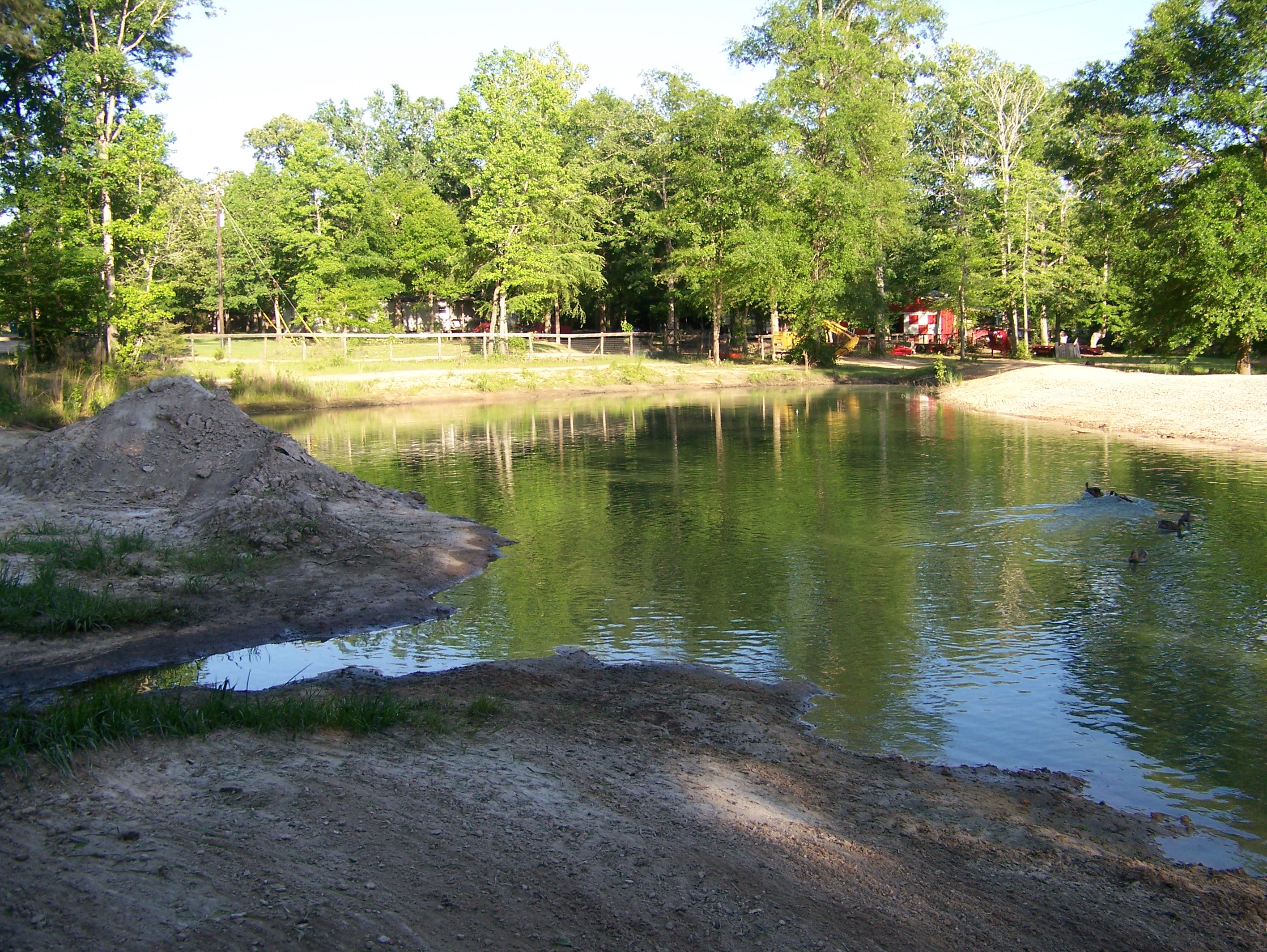

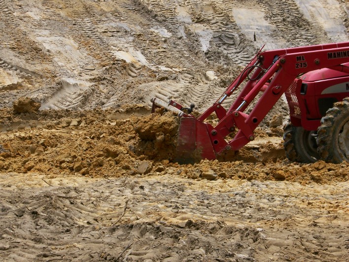

It's not the wrong tool if you only have that one machine. I had a dump truck. If you have more than one person, a loader and dump is great. But for one machine and one person, digging and moving short distances (200-300 feet) a 4WD tractor is not the wrong machine. Also swapping between machines gets old fast. All that time swapping between machines adds up also. My 6520 4WD Mahindra excels at digging ( or pushing dirt) and hauling short distances. The 6520 dug all my pond basins with the loader and moved the dirt.
Don't get me wrong, I would love to own a CTL.

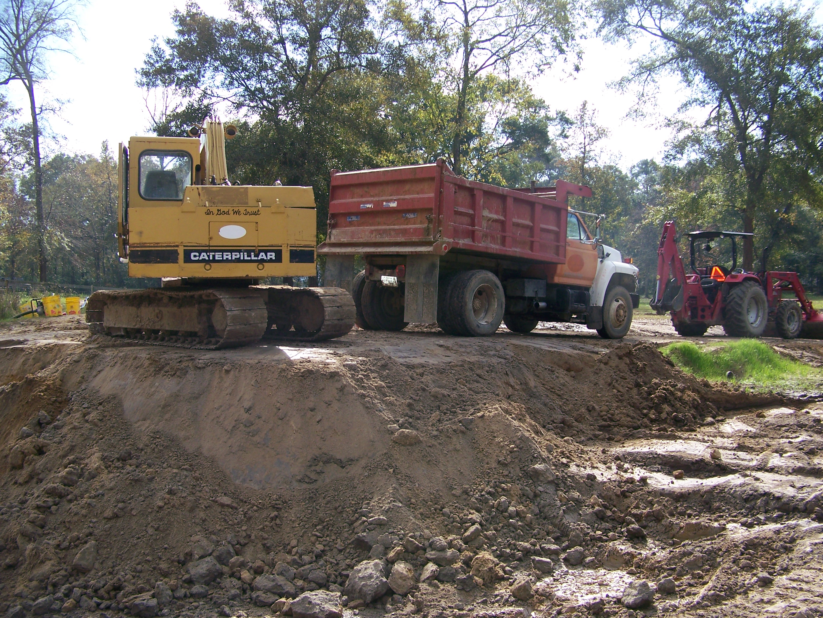

I moved 40 loads on this job. It was taking me 9 minutes a trip to load and haul 10-11 tons. I had 2 operators but it really didn’t help much. I was going about 200 yards. You couldn’t have touched the time it was taking me. And you’d have probably still needed the excavator. It was taking 6 minutes to load and 3 minutes to drive the truck there and back. It would have taken at minimum the same 3 minutes probably longer to drive the tractor and you’re only moving a fraction as much dirt.

I moved dirt faster with my Mahindra for my pond. At first, this was me stating I can move dirt faster than a CTL. Then you said I was using the wrong machine. Then you stretched it out to 200 yards and added a dump and an excavator. Then you added another operator. But on page 33, post 328, you stated.........."My full size backhoe could carry dirt faster, cheaper, and spill less than the 95 Kubota". So are these machines the wrong ones, or just my Mahindra?

How big is the Mahindra bucket? 3/4 yard maybe? My full size backhoe had a 1.3 yard bucket and weighed 8 tons. It still couldn’t hold a candle to the dump truck and excavator approach. And you won’t touch a big CTL at moving dirt with a tractor. Carrying 200 yards or even 50 yards isn’t the CTLs strong suit but they’ll walk all over you doing dirt work. The big CTLs have you beat in weight, HP, hydraulic speed, hydraulic strength, traction, probably bucket volume, way ahead in bucket visibility, and a lot smaller footprint machine. Moving dirt over distance is the only place you might have the slightest chance of winning and yes I said it’s the wrong tool for the job. CTL vs tractor for carrying dirt any distance they’re both terrible options.
