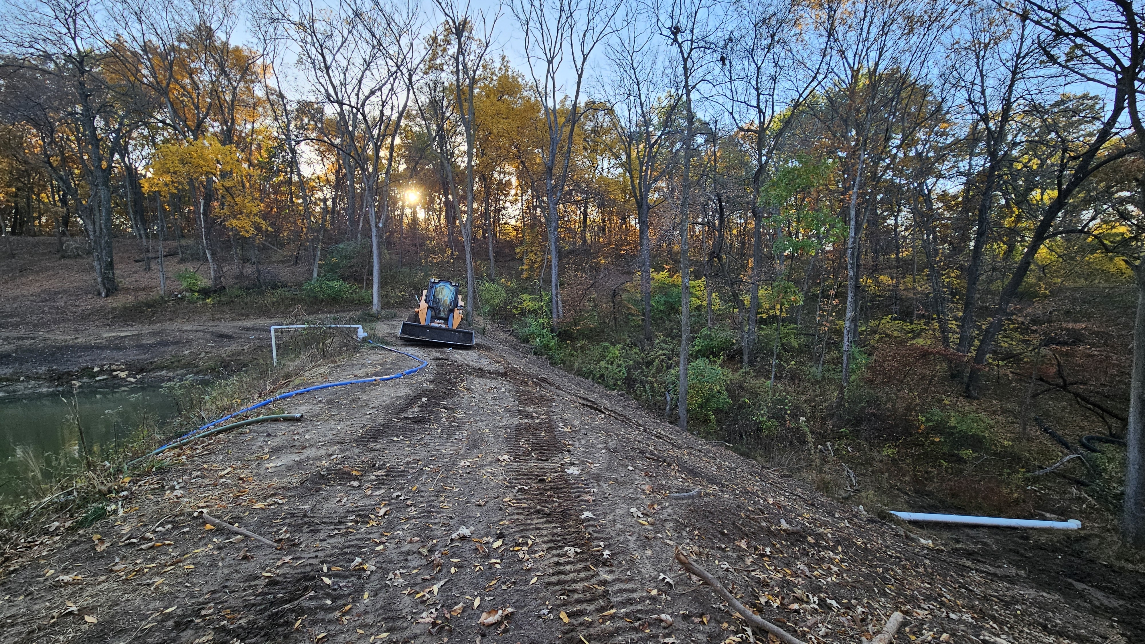

Installed the extra 20ft section on the outlet to the dam this afternoon. Will cap and use my trash pump to fill it tomorrow so I can siphon the water out of the pond. Should drain pretty quick with a 10" outlet provided everything is still connected.
   / Building Lake Corona
#1,183
Ran into a bit of a snag trying to get the pond to siphon. It wouldn't siphon so I knew I had a break. After capping and letting the water run into my T on top of the dam I finally found the break when it came to the surface. It pulled loose at the elbow on top of the dam on the backside. Not real sure what I did on this one. You could only see a couple of spots where the solvent welded. Most was not welded together at all. Probably pulled apart as the backside of the dam settled as I didn't worry about compacting this side much.
20241026_162807
I ended up letting the water run and with a little guidance with the shovel I let it do most of the work excavating the pipe so I could cut it in a few places and rerun it from the top down. Just no real way to reconnect without piecing it back together.
20241027_105359
Reattached and siphoned off the pond this afternoon. I was really happy to find out the pipe on the pond side was good.

On the pipe that failed, my guess is that you didn't hold it together for several minutes after sliding it together. The bigger the fitting, the more it want's to slide apart after gluing it together. The bigger the pipe, the more this happens.

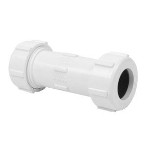

Depending on angles, you may be able to use a PVC compression coupling to put that together.
They'll actually hold pressure, and will work very well in a situation where you have essentially no pressure, though the section you're fixing does need to be mostly straight. I used one recently to fix a 2" line where a tree fell and dislodged/broke a coupling in the ground; in my case there was a bit of a bend in the pipe (it had been laid under tension in a bit of a curve) and when it popped it looked like it wanted a 11° elbow... I used a weed torch to slowly warm up the pipe so that I could gradually bend it to point mostly straight end then used the compression coupling.
In larger size they're not cheap, but could save a lot of digging.

Already fixed and pond drained. This was a 10" line.
