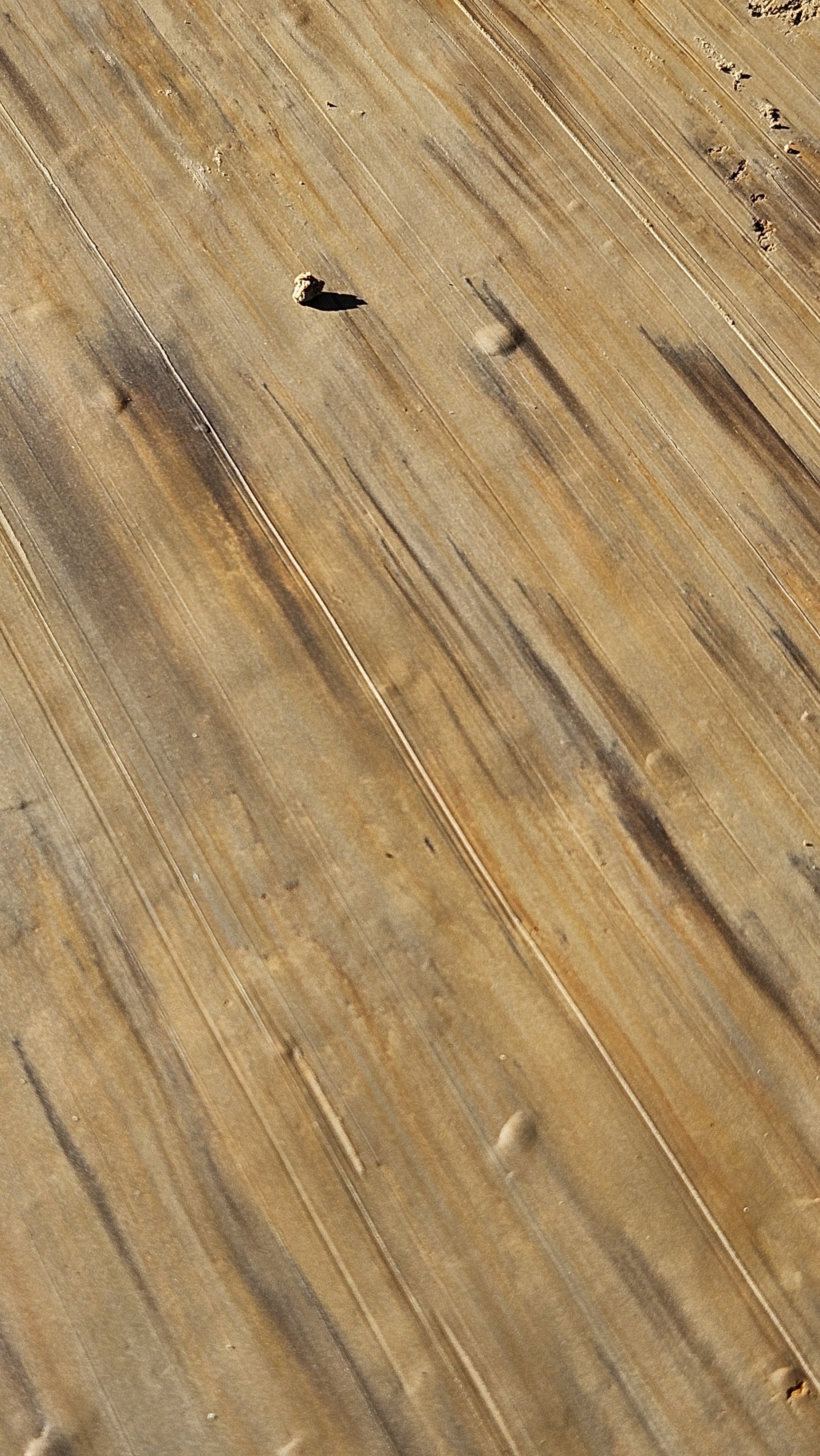

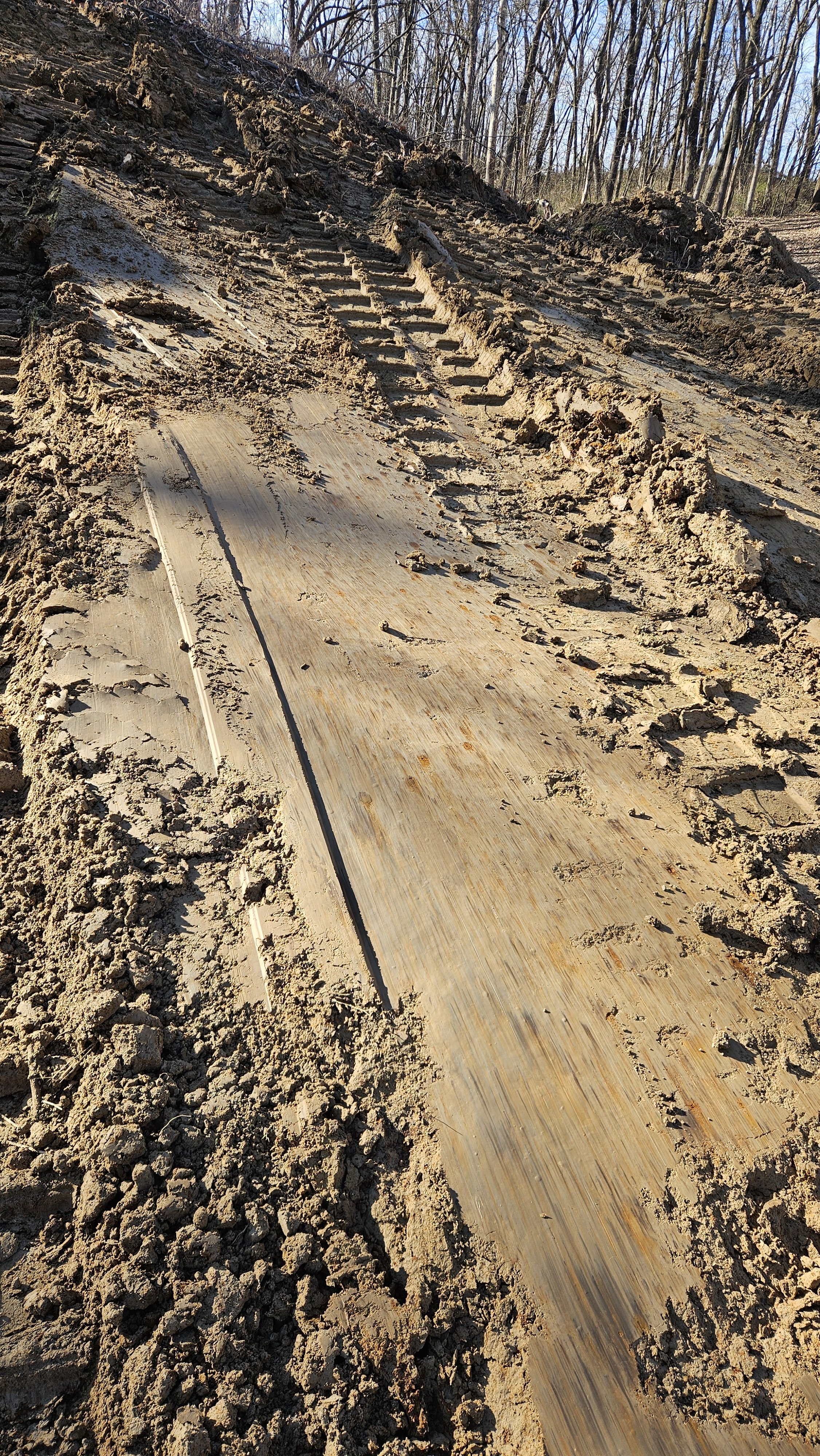

Well Eddy has been telling my from the start of this long saga to build a dock and I just didnt want to mess with it or rebuild it in 10 years when it rots. This week I finally came around to the idea in a somewhat limited fashion. Just got back home from the limestone quarry a couple hours from us. Picked up this roughly 7ft x 10ft piece of limestone. Going to pour some concrete posts before my water comes up any higher to place it on and cantilever this slab out over the water. It's not much but won't rot and will give me a space for a couple of chairs off the dirt and out of the weeds. Fixing some lunch then going out to see if my CTL will lift it. Scaled at 5,100 lbs so hoping the width is not too much weight away from the machine to move it.
   / Building Lake Corona
#1,385
No issues getting it off the trailer. This machine continues to amaze me. Weather looks fantastic here at the moment so hoping to get as soon as it dries out a bit more. We are calling for 67 at the moment on Christmas.

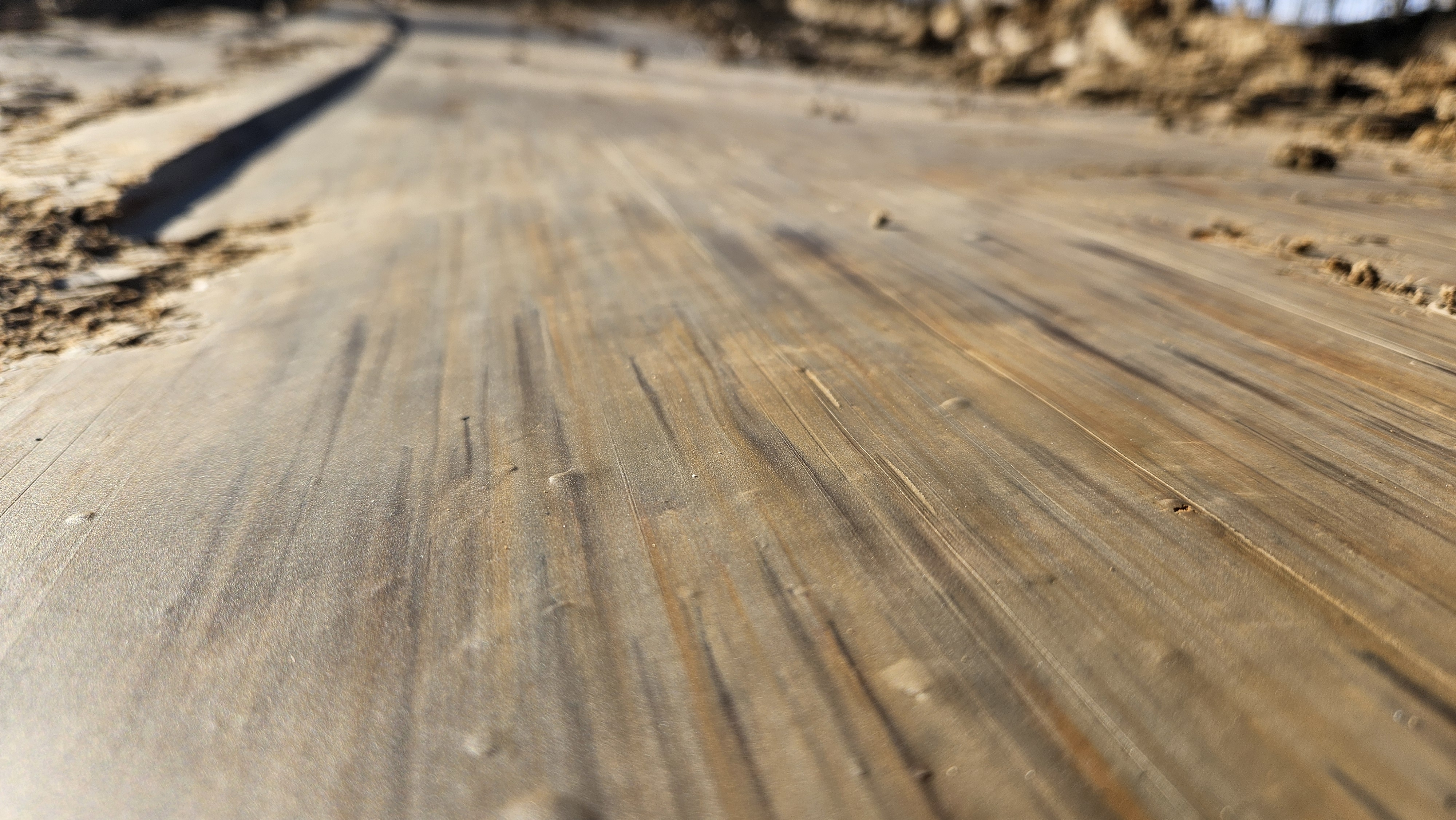

That looks great!!
Is one side smoother?
If not are you going to smooth the top surface and if so how?
#1,388
That looks great!!
Opposite side from the pics is a little smoother but still rough. Not real concerned about it. If it's an issue for chairs will probably just make some type of permanent bench for it. A little cement mud under the contact points to level.

Weather has been great here until today, was 63 on Christmas, but the soil was just too muddy to do anything Teens overnight last night and 25 today to the ground froze up and I was able to get the tractor to the pond and get the holes in for my concrete. Will use sonotubes and pour 5 column to set the stone slab on. Looks like warming back up to 53 on Wed. I'll get the generator and mixer moved in early morning while frozen and try to get it poured before the ground gets too sloppy.
