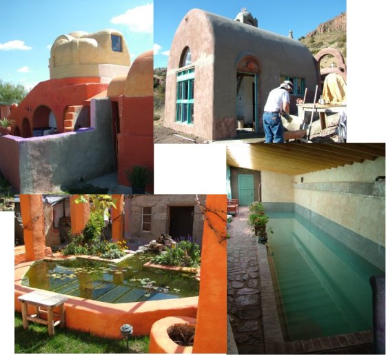

here's some photos of stuff built (or being built) out of papercrete

Yes how does it hold up to rain ? From the pics those constructions seemed to be in an arid climate. Is it required to stucco over it ?
   / building barns, sheds, houses - almost free
You have to waterproof it - elastomeric paint works well. Many people have built these in very rainy and humid climates and as long as they are waterproofed they work fine - if they are not waterproofed they will eventually start to deteriorate. I am planning to build my main house in a fairly rainy part of North Texas - I'm going to use papercrete for the walls and put a metal roof with a wraparound porch to reduce the problem to the point of insignifigance but I will still paint the house with a good latex to seal it. Domes are possible (even easy to build with papercrete) in wet climates but you REALLY need elastomeric roof coating after they are finished - papercrete will soak up and wick water if not coated. In arid climates with only ten instances per year of rain, coating is not all that important - papercrete has to get very wet many, many times before it will begin to break down.
