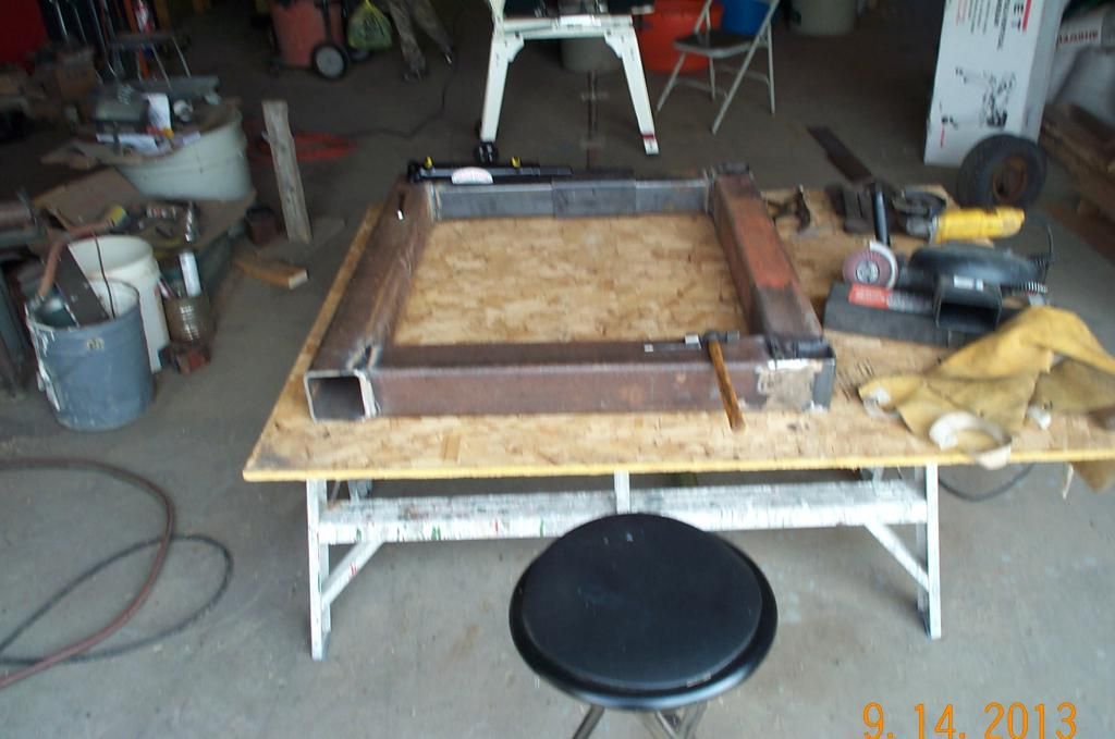

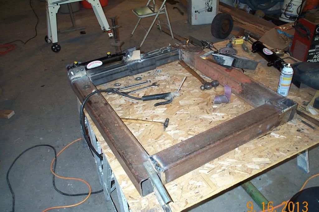

with the rain I have had a few days to work on the pounder,

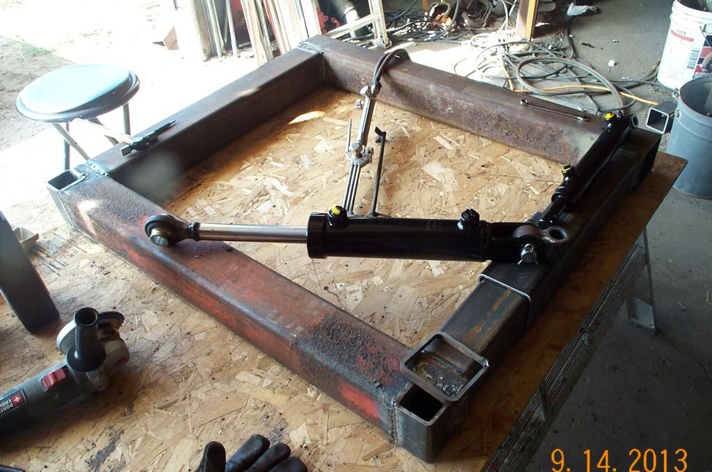

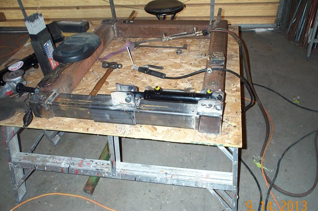

I started with what I call the base frame, the part that will attach to the tractor,

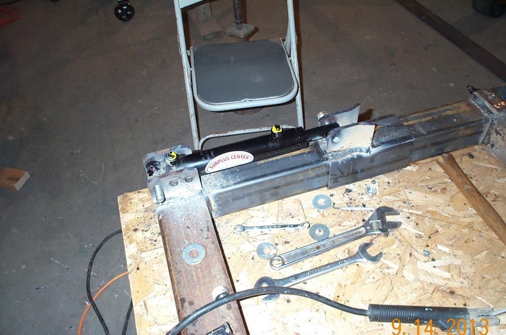

Part of the system is the tilt, used a 3.5" tube with a 4" x 3/16" wall to slide over the smaller tube, the rest of the frame is 4" tube.
then the three point lift points,

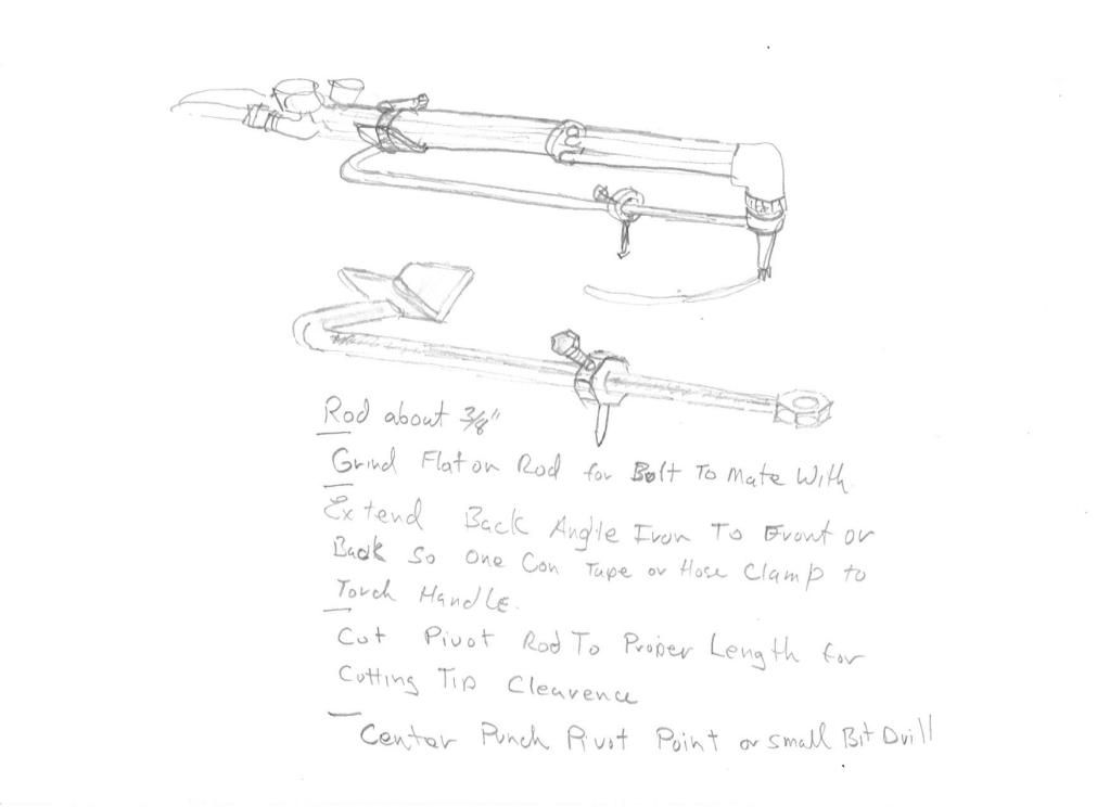

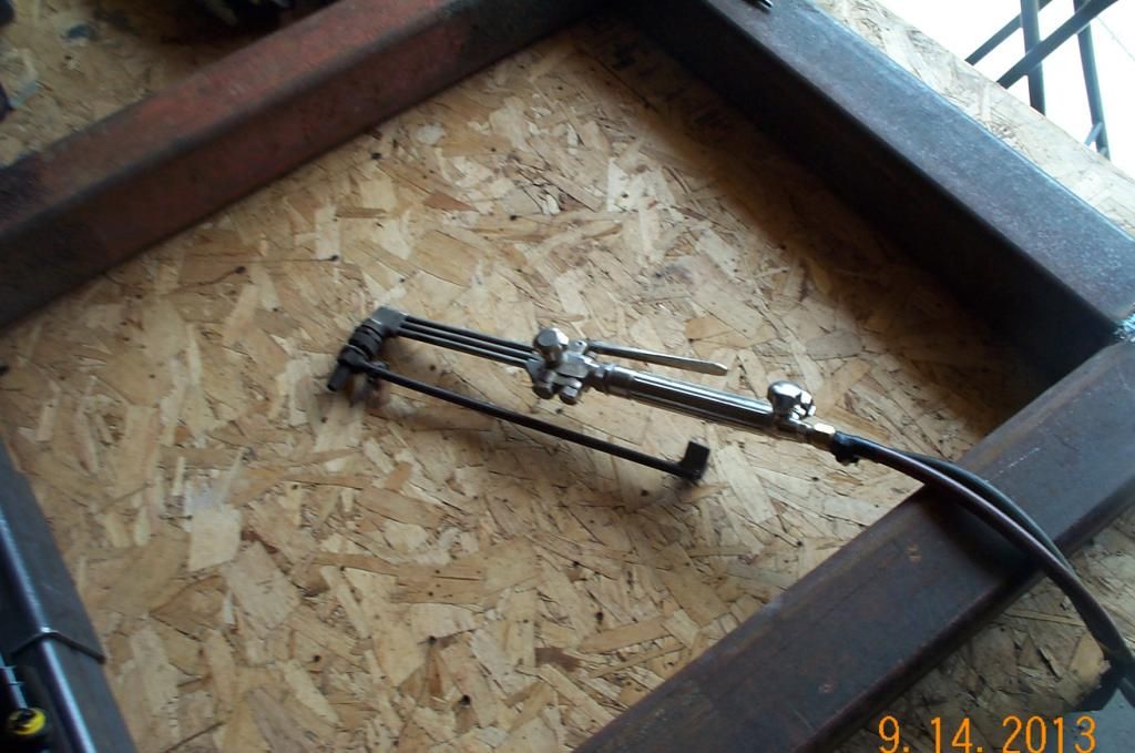

to curve the ends of the lift arms I use a compass attachment for the cutting torch,
/ building a wood post driver tractor mounted

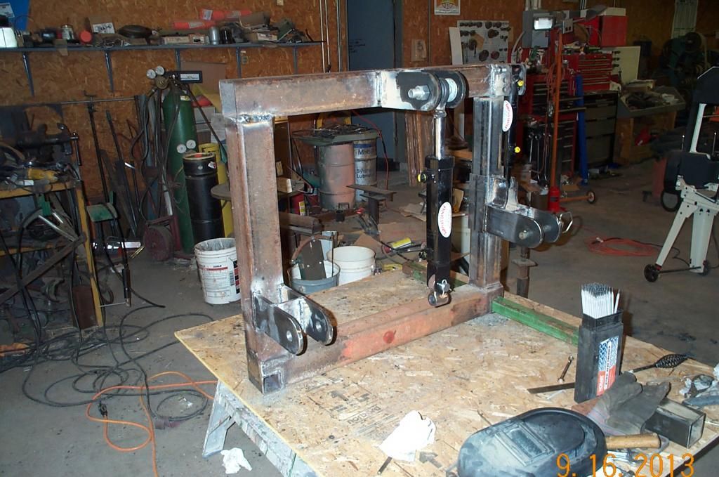

Few Pictures of the nearly complete base frame

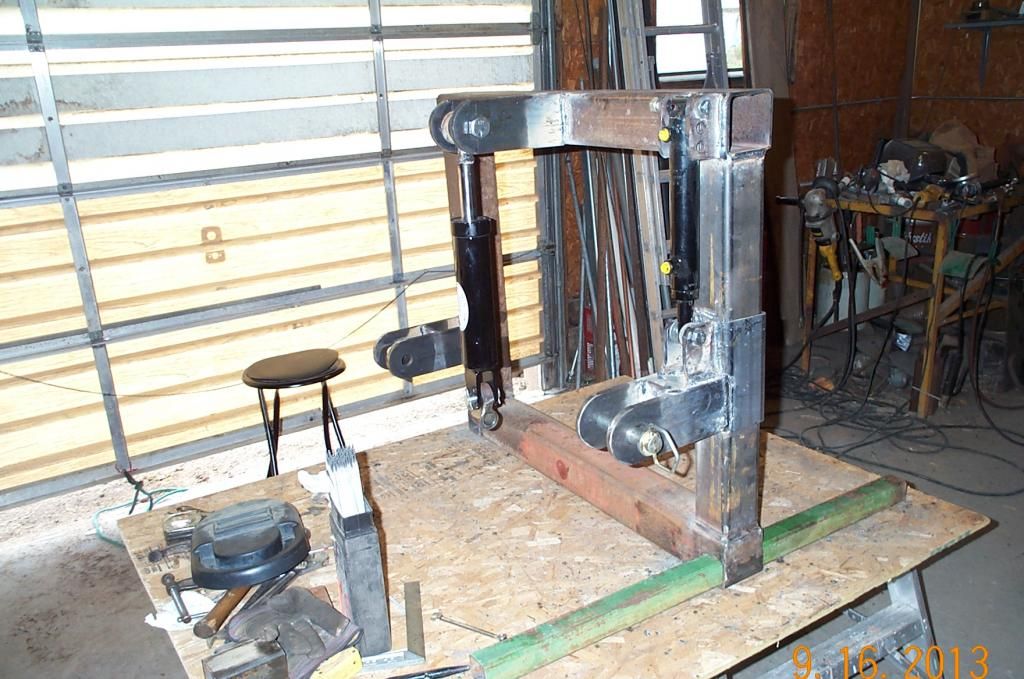

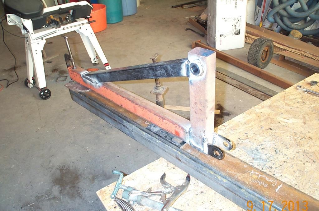

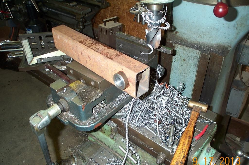

to day I worked on the swinging lift arm.

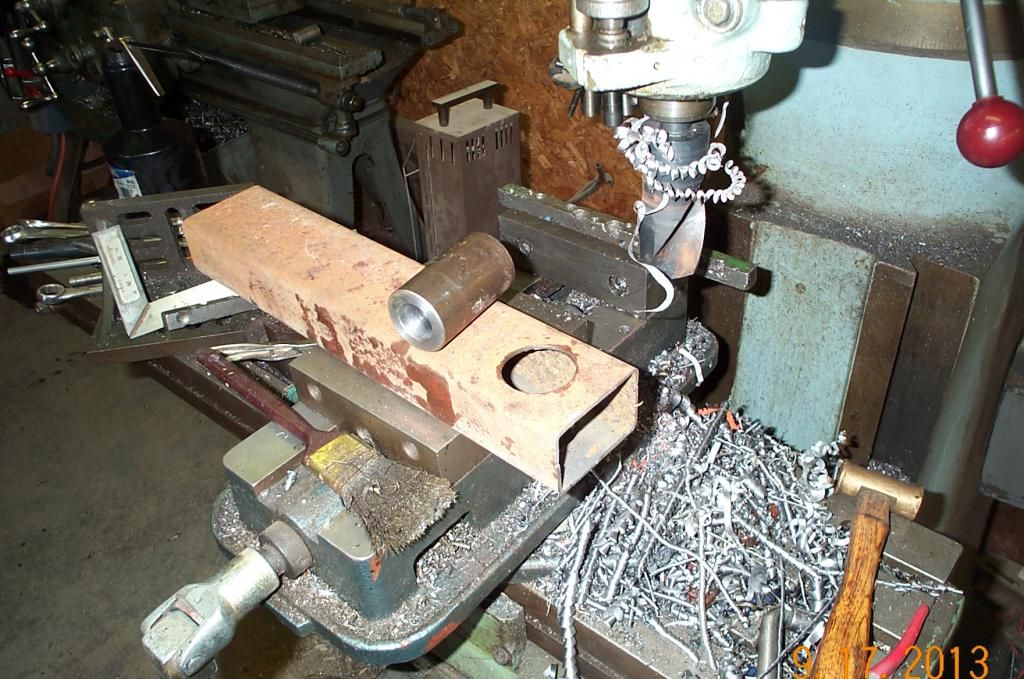

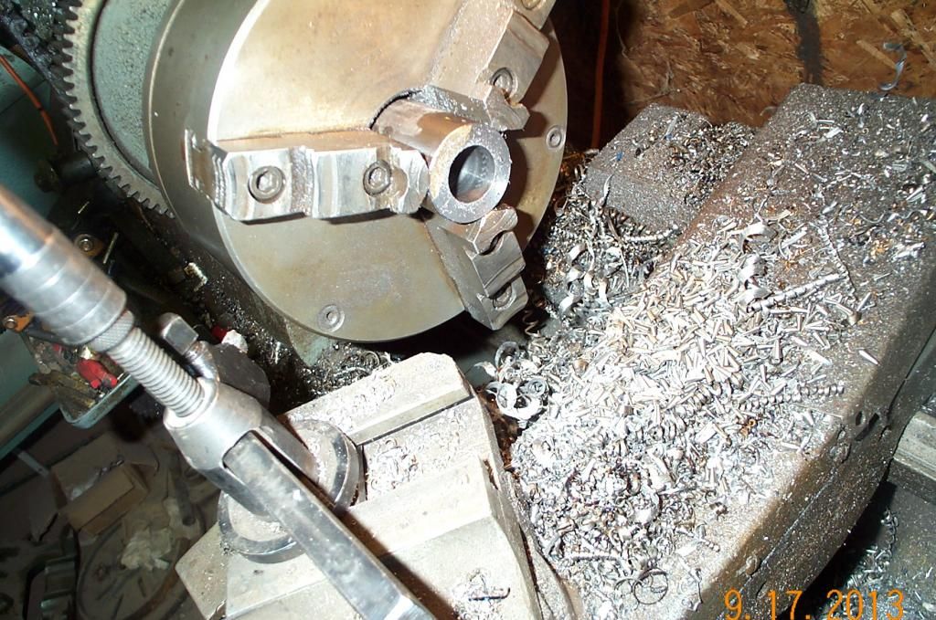

turning and drilling the pivot bushing

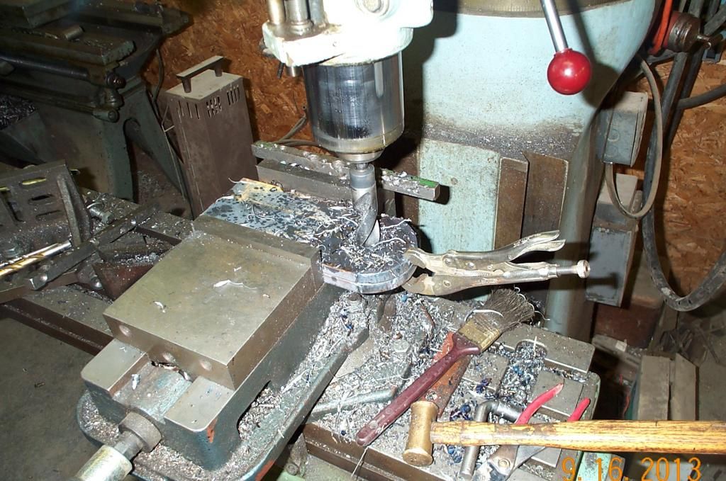

Drilling the arm for bushing
weight lift arm nearly done,

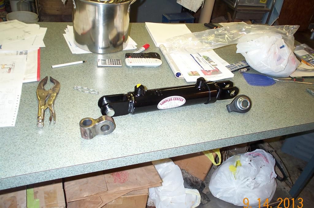

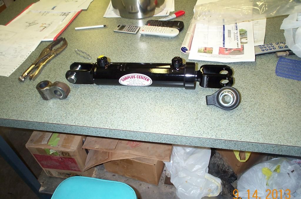

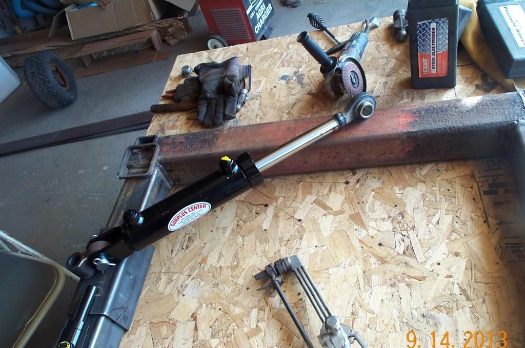

the top link which is part of the tilt adjustment.

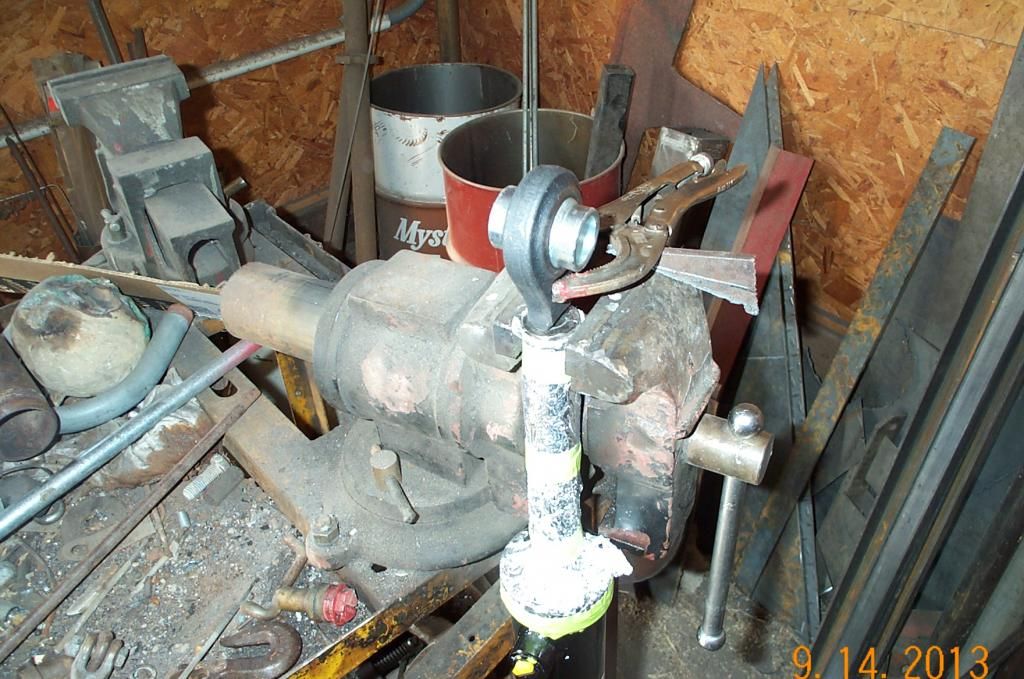

parts for the top link,
Welding of the tip link and eye on, I cut off the ears off the cylinder with the saw, when welding make sure your grounded in such a way it does not pass through the cylinder or shaft and arc and pit it. I wrapped the shaft with paper towel and aluminum foil so it would not get splatter on it,

Nice work, I really like your cutting jig. I may have to use that idea.
Did you buy or make the part that I circled in the attached pic.
If you bought it where at?
ps Cool build!!!
#12
I made that part, on my JD 4000 / 4020 tractors, there is not enough space to use a double EYE cylinder, one can get bushing stock from a machine shop, I was out of the sizes I wanted, so I took some shaft and drilled to the size I wanted, 1" and then welded them together to make the part, ( I would guess John Deere would sell the part, as it its part of the top link on old 20 series tractors,

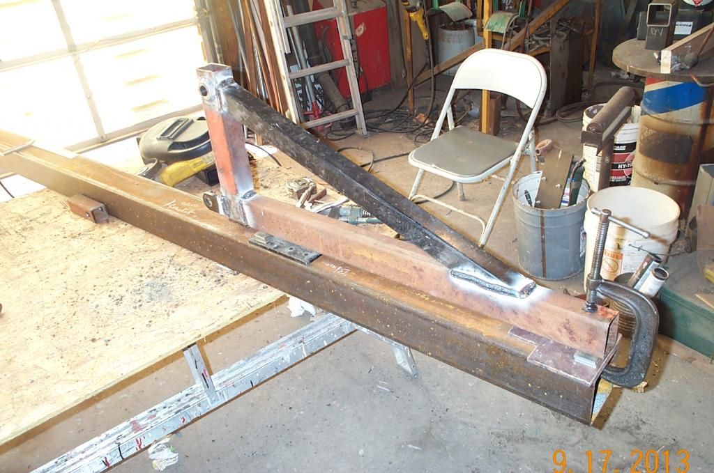

the swing arm that will raise the weight, the steel in the tube was a little lighter than I thought it was so I added the angle brace,
head and pulley for weight drop,
grease Zerk in bushing of the swing arm
swing arm lay out
brackets for swing arm, need some extra clearance so the 4"x4" by 1/2" think spacers/reinforcement bushings

here is the swing arm lay out
Clamping and squaring up brackets and swing arm
Cylinder for swing arm
