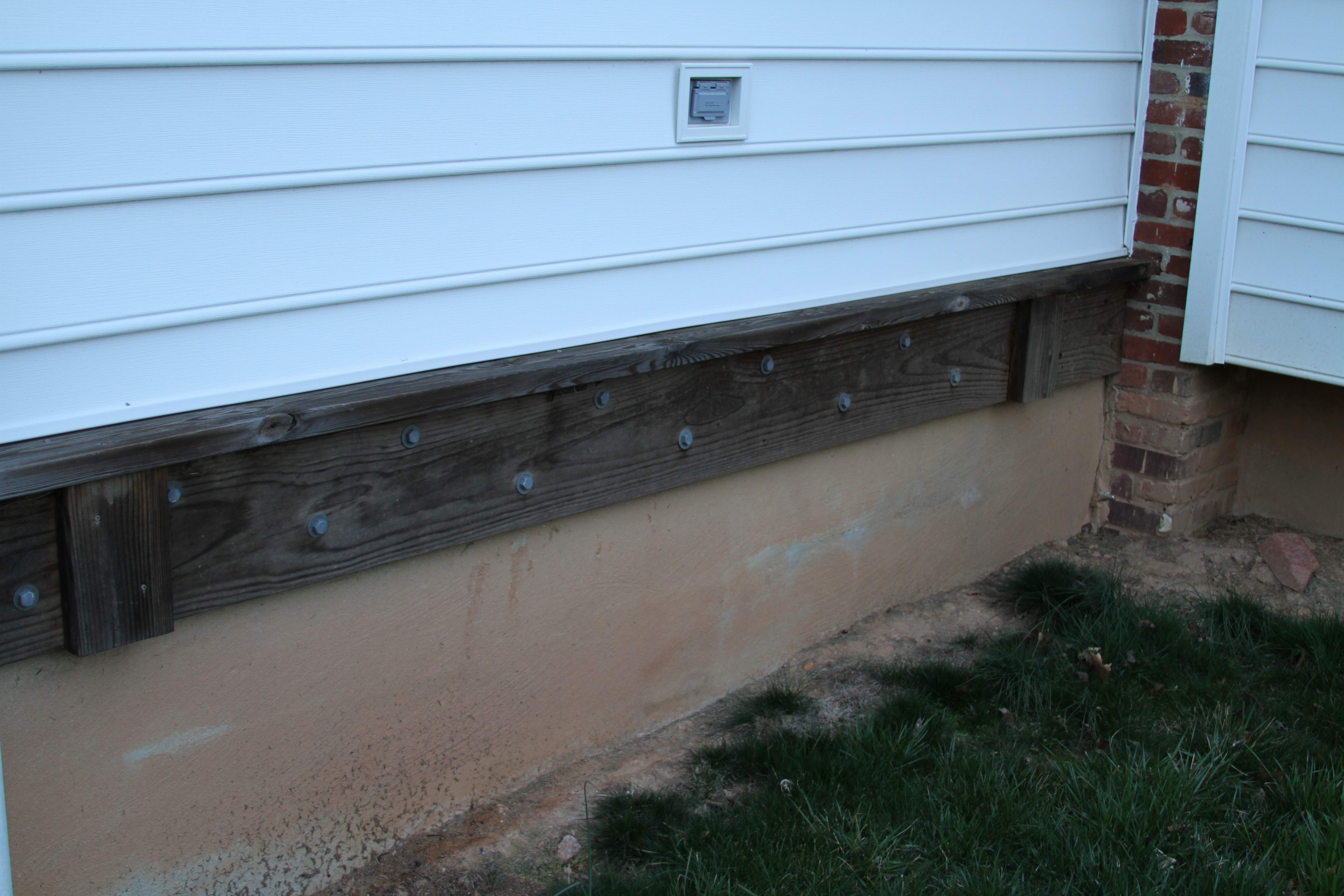

I don't even have a deck (yet) but here is how the attached mine. IIRC, this is a fastening system made by Hilti that includes epoxy in each bolt hole.

Stu, you do realize the 2x12 boards that protude from the top of the basement walls are notched and that a 10" tall section, is resting directly on top of the walls, right? The 2x10 boards attached to the walls of the house are only carrying the weight of the inner edge of the 1st trex board. The notched 2x12s carry all the weigh of the deck, which is different from how my deck (and yours once done) is constructed.
I did not so at least I can breathe again. That is an odd design but it seems sound. I would still get on them about the joist hangers - I thought they were mandated by code in VA, I know they are in my area.
