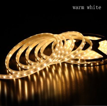

Look at LED tape lights for under counter
http://www.amazon.com/Lighting-EVER-Flexible-Waterproof-Ultimate/dp/B0085UPTJO/ref=sr_1_5?ie=UTF8&qid=1364022820&sr=8-5&keywords=led+strip+warm

These are really inexpensive and seem like a good option. I would like to do something at my house. What I do not understand is the part about the optional lighting controller. Seems to me that would be mandatory to actually get power to the little suckers. Am I missing something?
