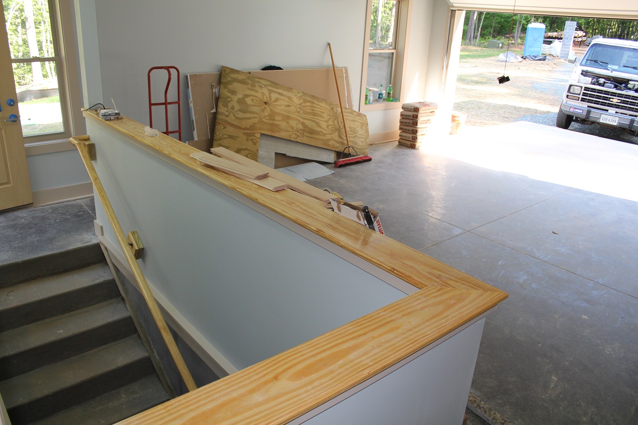

In the garage, the close proximity of the outside door to the basement stairs has given me great anxiety from the first time I saw it but I just assumed that there would be a gate across the stair opening eventually. Admittedly, I do not know the spacing from the door to the stair-- just concerned as stated below.
The thought of anyone turning and stepping backward to make room to close the outside door and subsequently taking a backward tumble down those stairs is frightening to me. I know that at my age (near that of your Mom) I could not stop myself from falling if I had only one downward misstep on those stairs.:eek::thumbdown:
PLEASE put a gate across that opening. If necessary, make a trial entrance into the garage through that door with both hands and arms full and see how large is the risk as I described.:2cents:
We don't want your Mom falling down those stairs.:(
