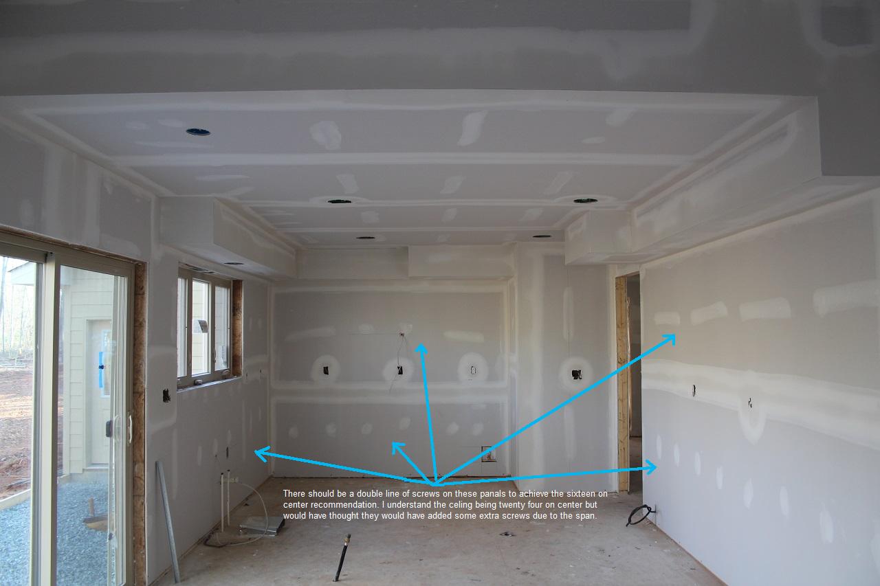

Easier to see with the first coat of mud on the walls. I understand the ceiling, however, the walls don't seem to have enough screws in them.

That fastener interval is very common these days with the use of glue. I believe the product is actually called DSA (drywall stud adhesive). Essentially liquid nails for drywall. Less nails on the surface mean less nail pops. My house has 54" wide sheets and only 3 nails per stud.

You are right on the 4 ft wide sheets. One at the edge and then 16 and 32 and other edge. The row of sheets you illustrate have the top sheet cut down by a foot in width for the short upper cabinet boxing above them. That threw Peter off a bit the other day. He thought you were referring to every 16" along the length, which they would be with studs 16" on center.
In the other rooms they did only use 3 nails/screws in the 48" width where there should have been 4. Sometimes the quick and dirty guys only use 1 or 2 nails in an entire 4 x 12 sheet but put mastic/builder cement from a large caulk gun on some of the studs ( should be all studs ) A couple guys cutting and carrying plus a couple guys hanging can do an average rectangular room in minutes that way. I sure wouldn't trust it or do it but I'm not trying to make any money.
I see a lot of places where they missed their guess at where the studs were and there are 2-3 nail/screw clusters. That means a lot of the fasteners probably just caught the edge of a stud and split it since they didn't actually measure or use a level to get in the center of the studs. Let's hope they pulled the missed fasteners and didn't just mud over them!

Did you find the evidence, empty mastic cartridges, in the dumpster? Even on the cut down sheets I would have use more screws, however, I am not in a hurry or trying to make a living hanging drywall. Way back when I could shoot screws in the middle of a sheet without measuring but those days are long over. Now I measure and grab a level before I start shooting screws and still manage to miss a few.

timster, I see what you're saying now about the fastener spacing on the kitchen walls. Let me go look in the dumpster to see if I can spot a punch of those mastic cartridges.
