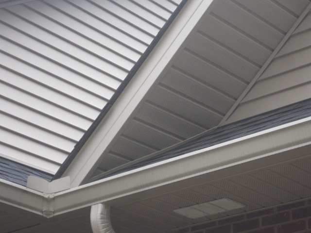

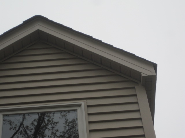

Here are some pictures of our facia. We do not have drip edges. We built and moved into our house 2+ years ago. I am happy with the job the siding people did. We don't have appear to have facia ripples issues. Have a look at the shape of our facia siding. There is a ridge along the center that may help prevent the ripples. There may be better ways to do it but the method our installers used has so far seemed to work well.

They used a tool called a Brake Buddy on your fascia. It puts those creases in it and makes it a lot stiffer. We use it on that style fascia as it eliminates the oil canning and makes a better finish. That little tool wasn't cheap but it is well worth the price. We use it when we wrap beams on porches as well as their terrible for oil canning. Most of our work is on older homes so nothing is ever straight and easy.

You certainly do have a drip edge formed on your facia. Go look again or zoom in for a closer shot.
You also have some warbling down where the fascia covers the end of the soffit box, but not bad.
