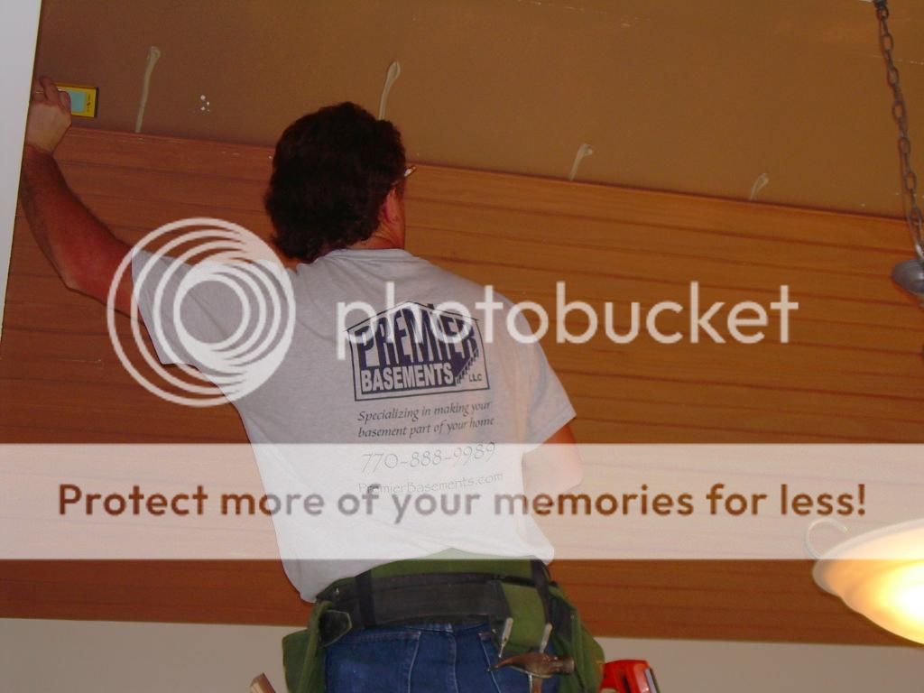

I try and paint the ceiling similar to the stain/paint color on t & g work, so if any gaps develop, they're less noticeable.
Edit to add (much too large:D) pics of before/after.
Ready for final touchup/clearcoats/sheet rock paint

That looks great Jay! Great top about applying a base coat of similar color before attaching the T&G.
