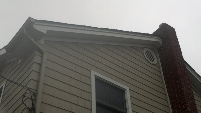

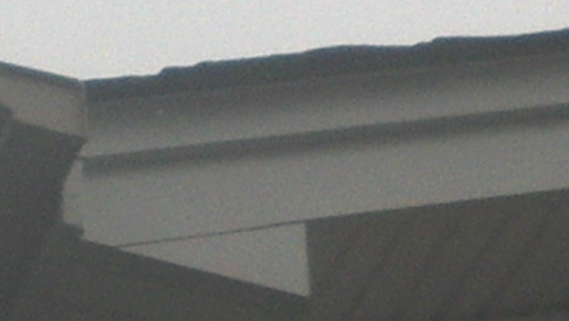

Yes your sketch is correct in showing the way we do the rake piece, Yes with a 2x4 gable you would need to use a 1x2 for proportion. I also set the 1x piece even with the top of the sheathing and only bend back in to cover the 1x piece. You are correct that both methods provide the same protection. I am not looking only for protection, i am trying to get as many bends in the rake to make it more ridgid. That is what keeps waves to a minimum. As far as nailing from below, Have you ever done this? We have not had a problem with denting the coil. We are using s.s. trim nails when attaching with no need to pre-drill. To be honest the prebent L i think your talking about is not something i would use on my house, so no i would not use it on someone else's. Its looks cheap with rolled profiles going down it but that is just my view. When the extra 1x piece is installed and you get down to making the "boot" in basic you bend an undersill, tuck it under the 1x over your rake and then slide your "boot" piece into that undersill
Builder,
I was doing the previous message from memory as well as this one. I saved some of Peters images for reference but not the text that went with them or with the replies. Too many pages now to hunt back, as stated by others. I guess in all fairness whenever we refer to a previous statement we should hunt back and find it and include it in the new reply. As I recall now, without hunting back, you were "chiming in" to support another fellow who is actually a NYC police detective, according to his profile, that had said something like, he had done thousands of Z facia without any problems. Whatever it was, one of you changed his tune to support the other.
The problem with Peters roof was in some places they left the roof sheathing panel overhanging the 2 x 4 and on others they didn't. I recall discussions about sawing it off even before the fascia was applied, but they used spacers behind the Z fascia instead.
At any rate, what is, is....
I certainly would not accept/ pay for the job on the rake trim on the front of the garage or the lousy shingle trim on any of the rake edges. I thought they would have fixed the fascia and re-trimmed the shingles by now, before messing with them causes the sealing strips damage..
My house does have the cheap preformed fascia and T drip edge. The underlayment, drip edge and shingles were replaced last fall, due to storm damage last summer. The roofer followed the same criteria as the original installation. I probably could have paid extra to get the fascia redone also, like you prescribe with the added board and formed coiled aluminum but I didn't. It might have even had negative consequences regarding overhang depth codes, if the roof is ever blown entirely off.
Except for the fascia warbling at the soffit box on one end of the house that gets a lot of direct sunshine, I'm satisfied.
Here are a couple pics of the box and roof edge from my deck of the room over the basement garage part of the house.
Notice how neat the shingles are cut. They were cut to length prior to nailing down and there is a starter strip under them
going from the spouting end to the ridge to assure an even straight edge. There is no way to get an edge that good by chalk line
cutting in place with 3D shingles.
However, they need to try re-trimming the shingles on Peters house with a board underneath to give a better cutting surface while the
present fascia is off and being replaced. IMO
Also a sketch I made to compare how an L fascia and T drip edge go together to form a look similar to your method from a little distance.
I apologize if I have misinterpreted what anybody has said in these threads. It happens all the time among other members, but that is no excuse for me.:ashamed:
Ron

Ron,
I always install a starter course along the rake edge, Looks much neater from underneath. Do all the guys do it? No. Is it really needed? No. It all comes down to how guys have been shown how to do things. Some guys do the least possible others go above and beyond. I would like to think that due to my practices and work standards that is why after this past down fall in the construction business that is why i am still in business. Alot of guys closed up shop.
Nothing wrong with the way your roof was done i would say its done that way 9 out of 10 times. Most guys don't do the rake ends with bending back and over the way we do it so a rake edge or drip edge would be needed. I think if a siding guy that we don't normally work with showed up and saw how we did it he would wonder what the heck he was going to do. It is more work for the siding guys to do it the way we do.
Peter in no way am i saying that your builder is doing a bad job i just want to make that clear. Like anyone else i like some things and dislike others.
All in all i think he is doing right by you.
But i still can't figure out why they didn't make a drip edge on site with the coil stock on hand.
Enjoy the build your almost at home plate.

Ron,
I ACTUALLY am a NYC detective. What does that have to do with this discussion. I have been doing residential home construction for 30 years. I have owned a construction company for the last 17 years. I guess you didn't read my entire profile and see that I have been swinging a hammer since I could pick one up. I didn't change my tune earlier in the thread. I thanked BuilderML for taking the time to explain the process in detail. I have refrained from posting any further in this thread because talking about these issues with someone who has never physically done it thousands of times is pointless. Books and the internet searches do not replace decades of practical knowledge. I, like BuilderML have kept my construction company afloat during these bad times because of quality work and referrals from satisfied customers. Below is pics of my home and how I do facia/gable trim. Sorry for the quality of the photos but it is raining buckets here right now. :)
Pete,
Get the siding sub contractor back and have him redo those gable fascia trim pieces. There looks like there might be enough roofing overhang to accept a 1x2 to be added to the fascia board and then recapped with a double Z. As long as there is at least 3/4 inch of roofing overhanging the trim it will be ok. They also need to turn the metal around the corner so there is an overlap with the trim that will be behind your gutter. I say this because it looks like there is exposed wood at the corner. Thanks for taking the time to post your progress and great house build thread!!
   / Building a stick frame house in the woods in 90 days #1,160
Peter,
The fascia issues have been well explained now and your pictures are worth a thousand words in case the contractor tries to to kiss off the problems or charge you extra. If you took them at a higher resolution than the 72 that you posted you may want to use the higher resolution shots to get in really close and explain to the contractor. Attached are a few with the numbers that I blew up with just the zoom in in the viewer. This is not the way to do it of course.
