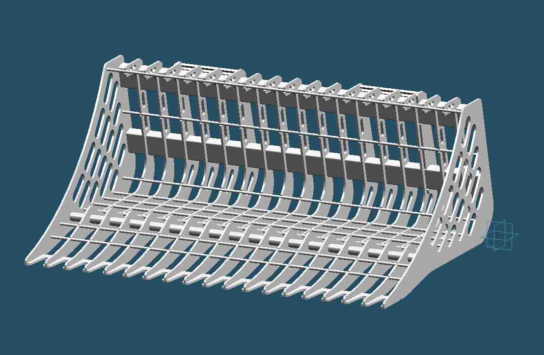

Over the winter I am planning on building a rock bucket for my FEL. I have designed it so that the bulk of the components will be laser cut. If any of you might be interested, I could have parts for additional buckets cut, bringing overall cost down.
I have attached a rendering of my design. Bucket is designed for skid steer style quick attach. Tines will be on 3" centers. My design is for a 72" bucket, but any width can be easily accomidated.
Let me know if you have any interest.
It's a beauty!
Keep in mind that multiple leaves are inherently prone to twisting forces. The rods holding all the leaves together are great for alignment, but have no resistance to twisting. It will be necessary to have plate stock at 3 points on the loader to prevent twisting. I'm guessing some plate stock is in the design, but hidden.
Fascinating project! Good luck, and take plenty of pictures!
/ Building A Rock Bucket #4
Have you calculated how much that bucket will weigh? The reason I ask is that I also have a TC45D and my S-Houle rock bucket is quite heavy. It's only 5' wide and I would not want more. The bucket weighs about 600 lb with the quick attach adapters. With my grapple added, it's about 750 lb. That only leaves about 1000 lb for rocks. I find the 5' bucket to be sized just perfectly for my uses. I would not want a 6' bucket.

BTW: I love your design. I particularly like the webbing you have designed between the tines, but bear in mind that the more you put between the tines, the more problem you will have getting dirt to clean out of the rocks. I shake my loader pretty violently to clear the dirt even when it is dry. Getting rocks only is the goal of the bucket. You want the dirt to drop out and clear. Everything is a tradeoff.

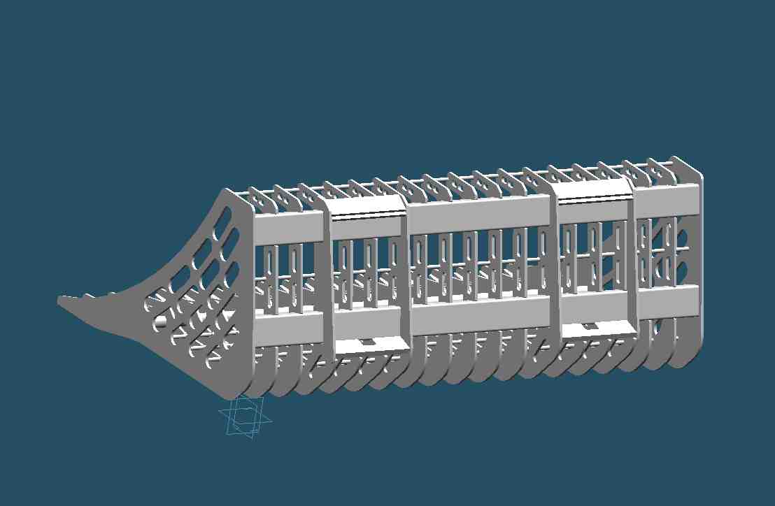

Thanks for the feedback. Here's a rear view of the bucket.
Jinman, I haven't calculated the exact weight since finishing the design, but initial calculations were around 600lb. Your point is well taken regarding the weight issue. I will definitely consider limiting width to 5'. The openings in the bottom of the bucket will be approx 2 11/16" x 5-6". Based on a wire mesh screen, with 2 x 4 spacing, that I've been using to screen topsoil, I think the bucket spacing will be ok. I will probably only tack the 1/2" rods in a couple of places until I try the bucket out. That way if the rods cause too much restriction, I can easily cut them out.

That's a nice looking bucket. What I would do is look for any place to reduce the amount of metal where stress will not be high. You might even remove some metal from the solid skid steer plates. If you save a few pounds here and there it will add up. Of course, I recommend adding a small grapple. The functionality of your bucket will be increased by a factor of 5 or more if you do that.
Maybe consider the possibility of making the rear vertical portions of the tines/fingers of lighter weight metal. It seems the stress there is much less than the ground-contacting parts. Just thinking of ways to reduce weight.

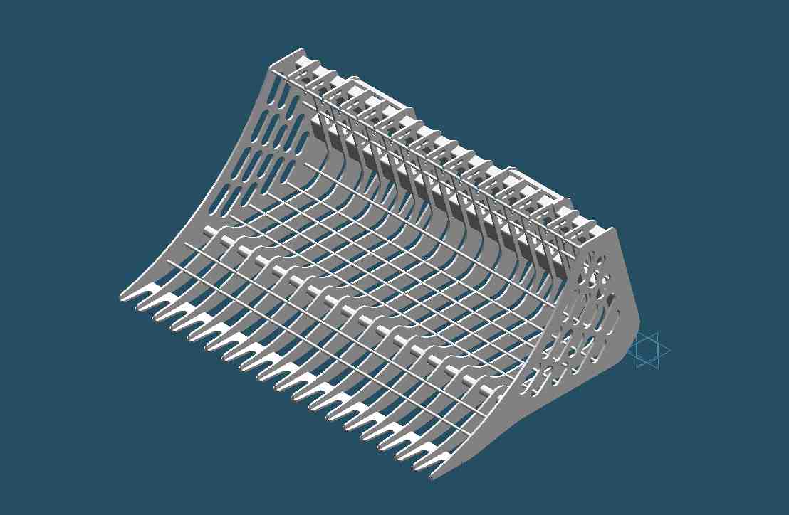

Hi Everyone,
Thanks for all of your input! I have modified my design to lighten it up... it was a little on the heavy side. New specs are:
3/8" Steel tines spaced on 3 3/4" centers (3 3/8" clearance between tines
1/2" rods (optional) on ~4" centers
Overall width ~ 68"
Weight 604 lbs
Webbing between tines is now 1 solid pc, making it easier to cut & assemble.
Here's a couple of renderings as well.
The best price I could get up here for laser cutting would run around US$1000, including steel plate. For me this is a good deal since a bucket like this is over $2000 up here. I suspect that you guys would probably be able to get the cutting done in the US for much less. Anyhow, if anyone is interested to have parts cut, let me know. I could also just provide the plans & .DXF files for a very modest fee.
