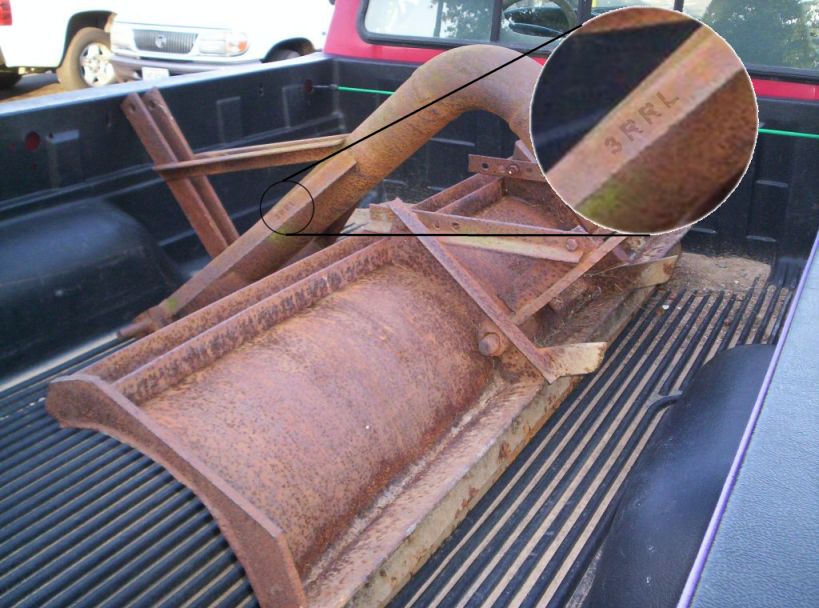

Jay - thanks for the well wishes. I got back a little while ago and here's the result of my road trip...
It's pretty heavy duty all right. And not quite what I was expecting. It looks hand made, but by someone who pretty much knew what he was doing. I don't think this was built by a large manufacturer, though.
When I got there and saw it, I wasn't too sure about it. And I'm still not. But the welds are all solid. A few of the bolts holding the cutting blade on have been lost, and the rest are rusted, but I can get them off with a cold chisel. The cutting blade is worn down on one side, but all I have to do is flip it, the other edge is untouched. It's adjustable left and right, but not with as many positions as other scraper blades I've seen. The angle of cut can also be adjusted, to be more or less aggressive. The draw pins are welded in, and not bolted like on a newer attachment. So if I ever bend them I'll have to get them cut out before replacing them.
So after seeing this bizarre beast, which is pretty darn heavy for a 60 inch blade, I wasn't too sure I was getting such a deal for $150. Fortunately the guy selling it was a decent fellow, and we struck a deal at $120. Still don't know if I got a bargain. Guess I'll find that out after I get this thing cleaned up and start dragging it through the dirt.

You got a good deal. Just the steel alone is probably worth double that.
And I didn't know you were going to buy that now.
You can do everything I talked about doing with that blade. You can windrow from the high side taking cuts that don't dig in too much and get that road in there by tilting your side links to the max and reducing the tilt every pass as your tractor starts to level out. Pretty soon it will be level. It will be a lot easier than doing it with the fel bucket. Heck, you might not even need the boxblade now that you got that unit.

Home made huh? I wonder....... Looks like there's something etched on the side there... let me see if I can zoom in and see what it is...
...ah ha! I bet this was Rob's middle school shop class final! :D
   / Building a road on contour with box blade #35
That rear blade is one major league "score" :D! And to think it is also a 3RRL "signature edition" too ;) :p! Good work kvmapr :D! You can definitely move some dirt with that unit :cool:. Jay

It surely looks like a well built blade. Will you be adding gauge wheels?:D :D
