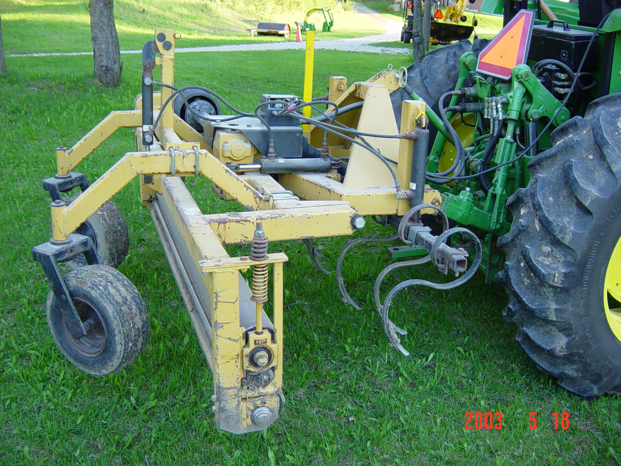

I like the nuts and bolts idea particularly for the ease of replacement. Could try different types of bolt heads such as hex, carriage, plow etc over time to see what wears best and most effective.
Drilling and tapping the location for each bolt, albeit time consuming, would act as a locator for holding the nut while welding as well as additional support for the bolt when assembled.
I would think that a grade 8 (or equivalent) bolt would have decent wear resistance for the price compared to carbide. One issue might be trash hanging up on the bolt heads.
I don't have a mag drill and even if I did it would take several days to drill and tap that many holes. In other builds, it seems like 8-10 hours to weld teeth on a drum is common. Welding nuts on may improve that time.

I have wondered about the bars vs the nibs. Harley has made the new rakes cheaper eliminating the S tines and the second rollers if I am not mistaken, so it is kind of a different animal. My rake sorts the smaller material in between the rollers windrowing the larger crap to the side, so this required bars and would not work with nibs.

1) Grade 8 bolts. Weld 1/2" nuts to the drum, then thread in 1/2" bolts with lock washers or a second nut to take up any gap. The bolt length would be between 3/4-1". The head of the bolt would take most of the wear and could be unscrewed and replaced if necessary. Cost through mcmaster carr is $90 for 150 bolts plus $25 for nuts. Moving up to 5/8" is $135 and $50 for bolts and nuts.
This seems like by far the easiest way to get teeth on it. For $70, to me it's a no-brainer to step up to the 5/8". More surface to weld on, more wear surface and the nut is thicker to allow more threads on the bolt to hold into it.

The commercial carbide teeth are rounded off nubs rather than a big fat hex head. I agree the 5/8" would last longer and be stronger, but I wonder if a smaller bolt head would "dig" better? I've never run a power rake so judging this all by videos I've found and internet opinion.
