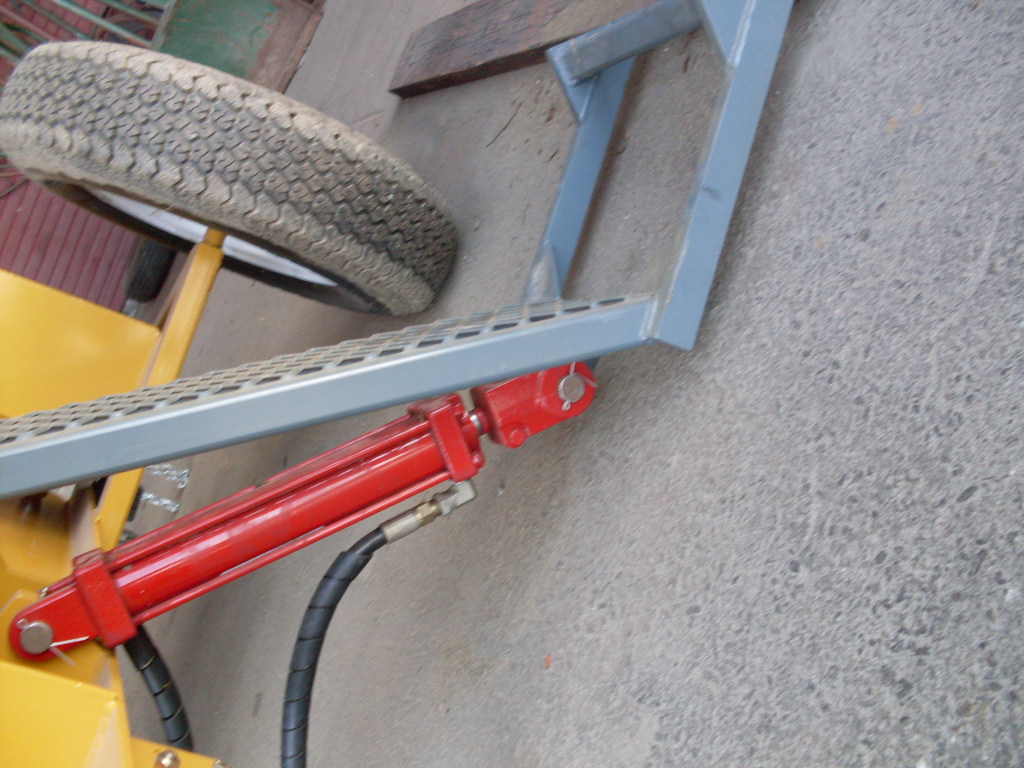

here is the design I came up with after alot of trial and error

I am all for the boom lift also. I built mine with a T knife. It doesn't split the block intwo. It just takes firewood size off the bottom of the block as you work it down. the main block stays complete. Just take a couple of pushes off the bottom, rotate with the tongs and finish it off. Having the hyd or elec winch sure saves on the back and like said above, you are able to grab from either side. My unit is likely overkill for most. I built it over 25yrs ago using the pto. Have since changed it to be self contained. faster and easier on the tractor.
:thumbsup: That Tknife is an interesting, useful variation. I wish I had thot of that when I made my moving wedge splitter 35yrs ago. A bit trickier to incorporate into a mobile wedge -- esp with my inexperience then...

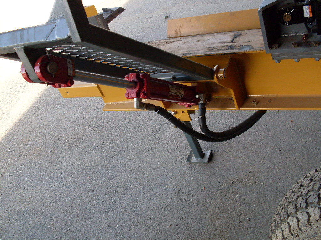

I am wondering why do you split your logs only in four pieces? I'm building a splitter with 8-way wedge. Pistons is 4" in diameter.
   / Building a Log Splitter from Scratch #36
JuHaa, what is the psi you plan running the cylinder at? What type wood will you be splitting?

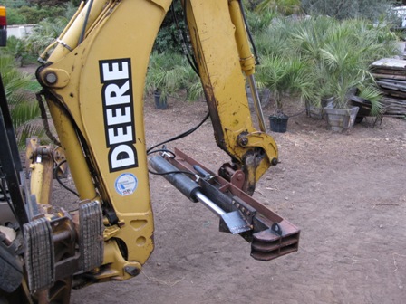

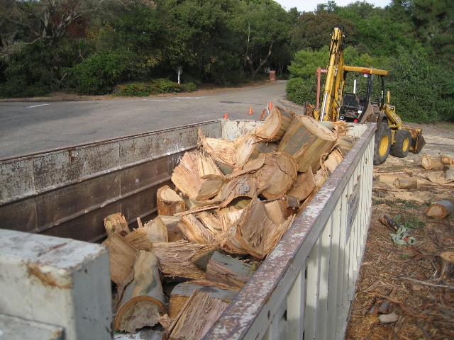

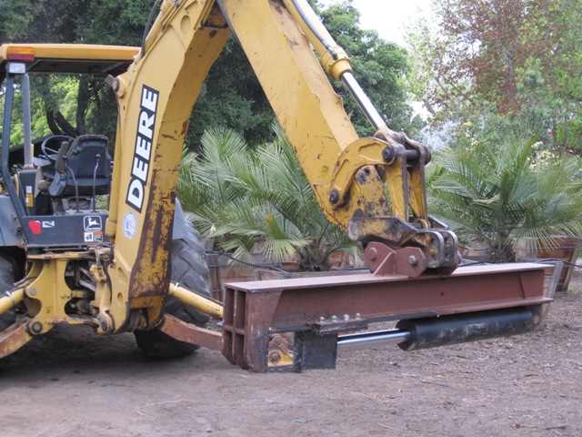

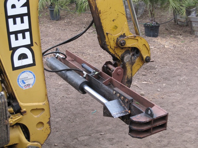

I am in the tree removal business, in this part of the country were often dealing with giant (4 -5' dia) eucalyptus trees. Eucaluptus burns well but reducing 5' "wagon wheels" into managable size pieces gave birth to this contraption:
Mounted to a JD410, It has a 6" X 30"cyl. with about 110,000 lbs of splitting force I can grab split and load a round in one operation. Really big pieces can be split a few times before loading. the goal is to reduce rounds to managable size, not to create firewood at this point
I have created a market for "pre-split" wood. Selling 25yd roll off boxes full of wood to offset cost of hauling.
Wood needs to be split again to size by the end user but at this point it may be more easily managed.
I'm running cylinder at 180 bar, about 2600 psi. Maybe your logs are little bit bigger than mine. I'm splitting mainly birch, pine and fir, biggest are about 70cm (2,6 ft?) in diameter.
That log lifting system made from winch is genious. I think I'm going to copy it to my splitter too.
