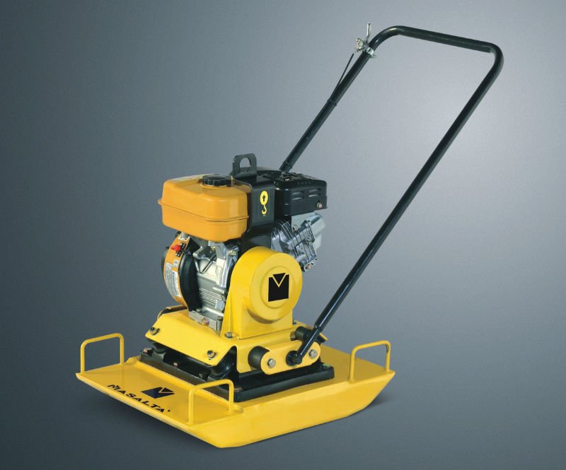

Sounds like it would be fun to watch, but I would predict a short tractor life. I once used a vibratory plow on a Vermeer articulated machine (a pretty substantial item) and if you weren't careful and got the plow against something hard, it would often break parts.
What's to break? The compactors are usually hand-held. The compactor has a flat bottom plate that rides over the ground. There's no subsurface engagement. They'll pound a 2" rock flush to the ground in seconds. Or pulverize it.
Mine look like this but not as new. ;)
/ Building a Land Roller #23
A plate compactor is floating on the ground, so all the impact goes to the ground. If you mount a vibrator on a tractor and don't have some arrangement to make sure it floats, the impact can go to the machine as well as the ground. If it can pulverize a rock, it can transmit the same force to a tractor if it's not floating. I was just cautioning that you have to be very careful if you mount something like this to a tractor. The vibrating plow was designed such that if you operated it correctly, all the force went to the plow (a cable plow). However, you could align it such that it would vibrate back into the Vermeer and then something would quickly break.
