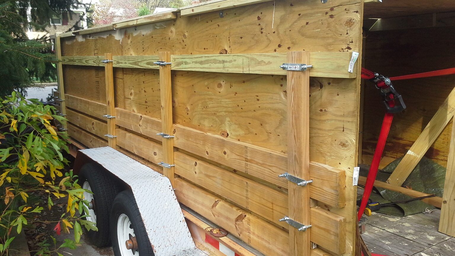

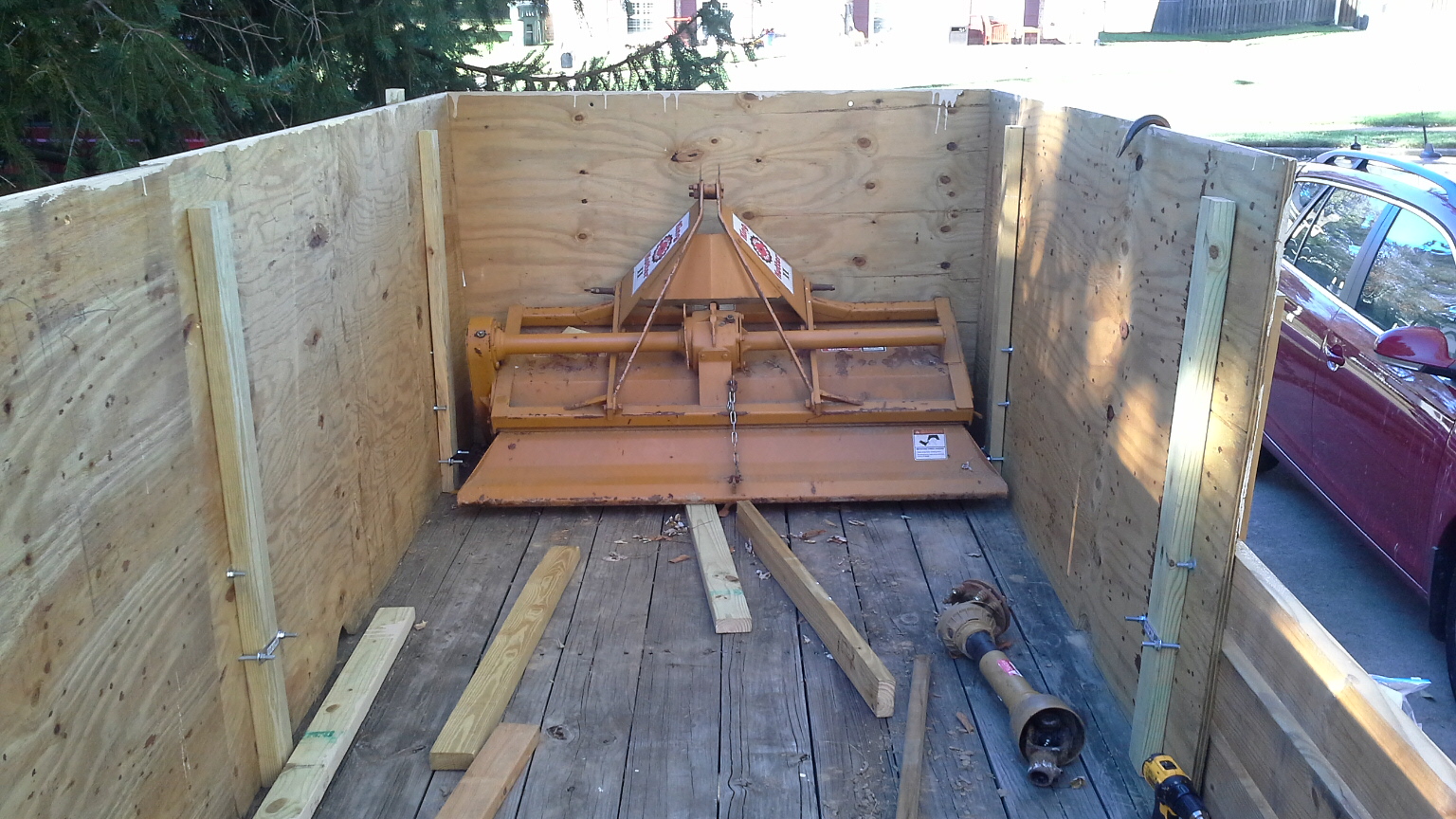

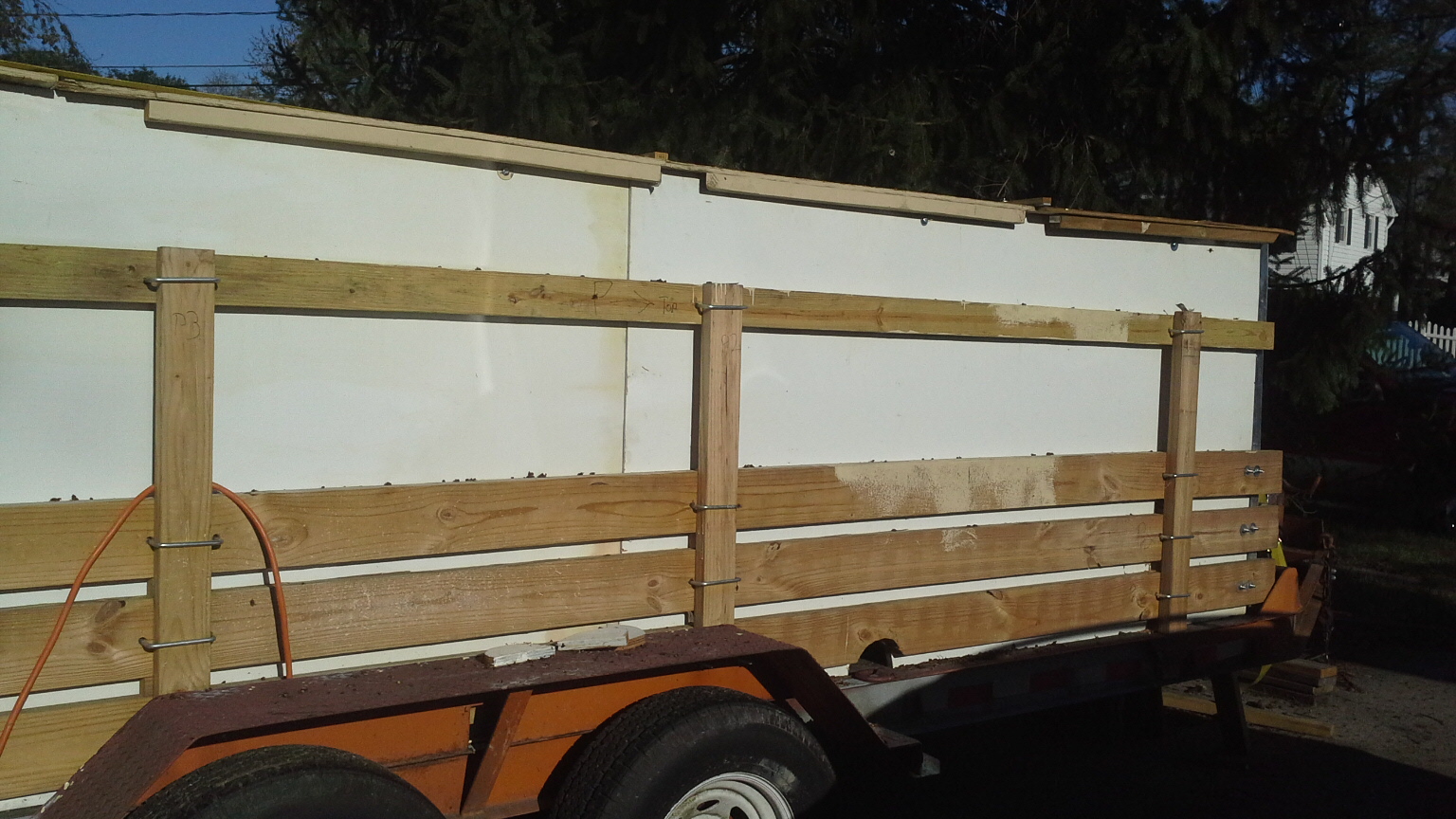

I've been helping build small movable structures off an on since about 1964 when my Dad built ice shanties in northern Vermont. I've got a "shelter" of sorts built on my trailer. Basically it's one sheet of 3/4" plywood wide, two long.
I used 3/4" PT plywood because all the 1/2" is so full of voids that they disintegrated. Now I've moved on to 3/4 marine plywood, very sturdy.
If you are going to build a 6' high wall of plywood on a 2x4 frame all 3/4 plywood will be heavy.
I've found that "screws" are not reusable for wood, drill a hole and use a bolt.
attachment.php
But when you drill a hole in a 2x4 you may weaken it. So I fastened my 7'x16' "shelter" together using mostly flat U bolts for fasteners. I've assembled/disassembled it about 4 times. It takes me over an hour to put it together and a little less to take it apart, and a lot of that is lugging the wood around. But I can and do lug every piece around. And its sustained about 4 or 5 thousand miles of road travel, probably a lat farther than your goat sheds will go.
I use a DeWalt 20V max drill to drive the nuts on and off it's quick and painless. For areas where I have to put a regular bolt in but it's difficult to get to the other side I use T-nuts. Thats what is on the end of the bolts you see across the top.

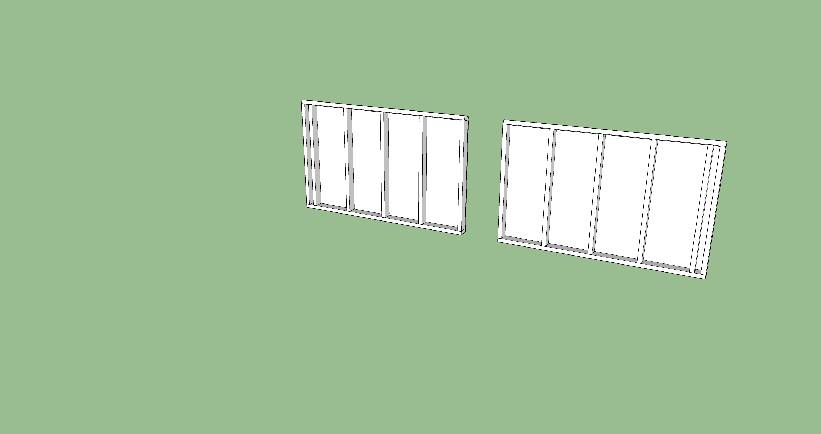

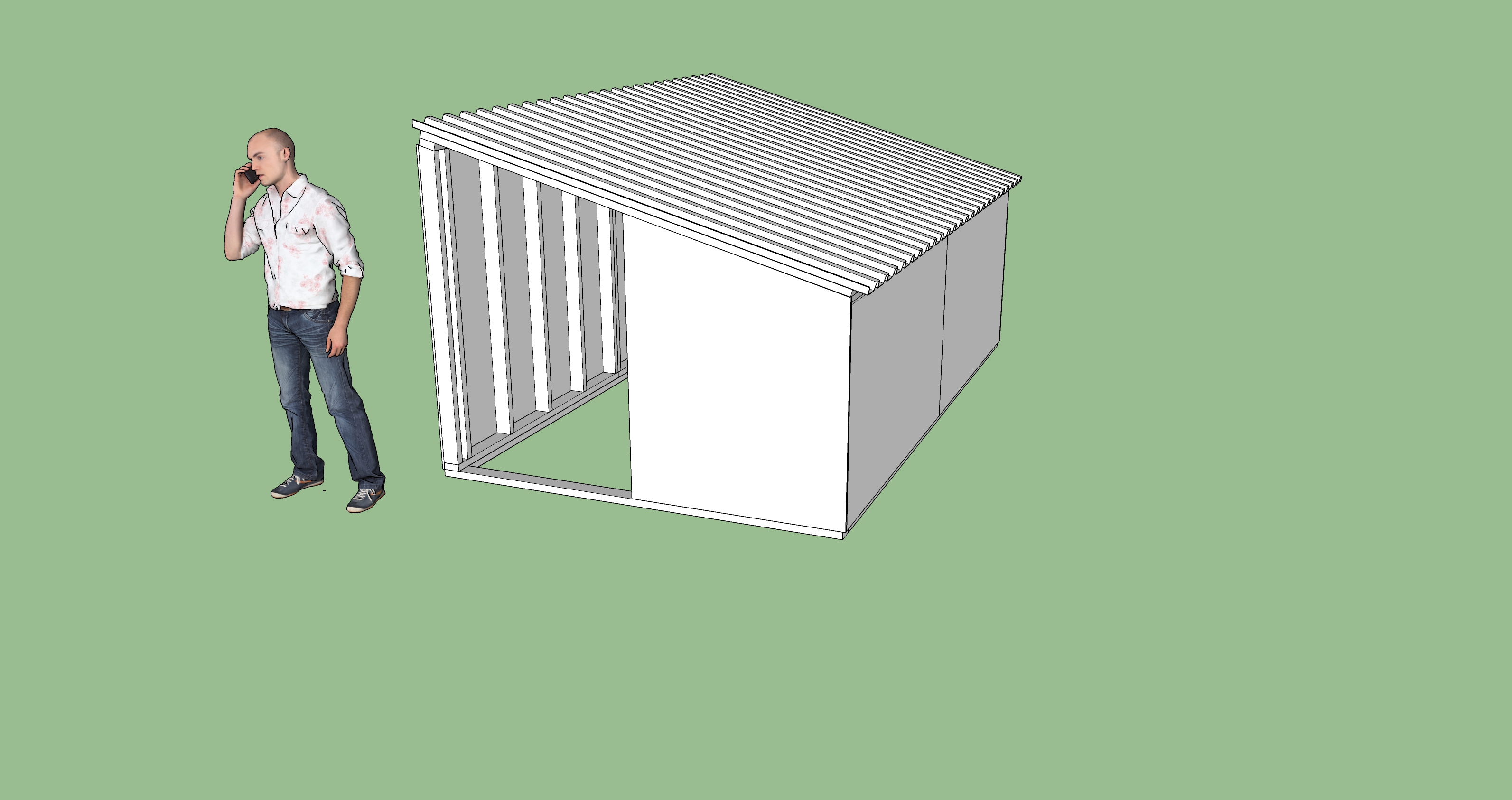

I've made some sketches to try and show my current thinking.
This is what a typical shelter would look like:
I can get roof panels that are 3'x8', which pretty much drives all of the dimensions. The roof is four panels so the footprint is 12'x8'. The front wall is 6' high and the rear wall is 4'. The panels I can get are b-deck, which can span 8', so they are only attached to the front and rear walls and the front and rear walls take the entire load of the roof. The panels will be attached with screws.

The rear wall is similar construction, only 4' high:

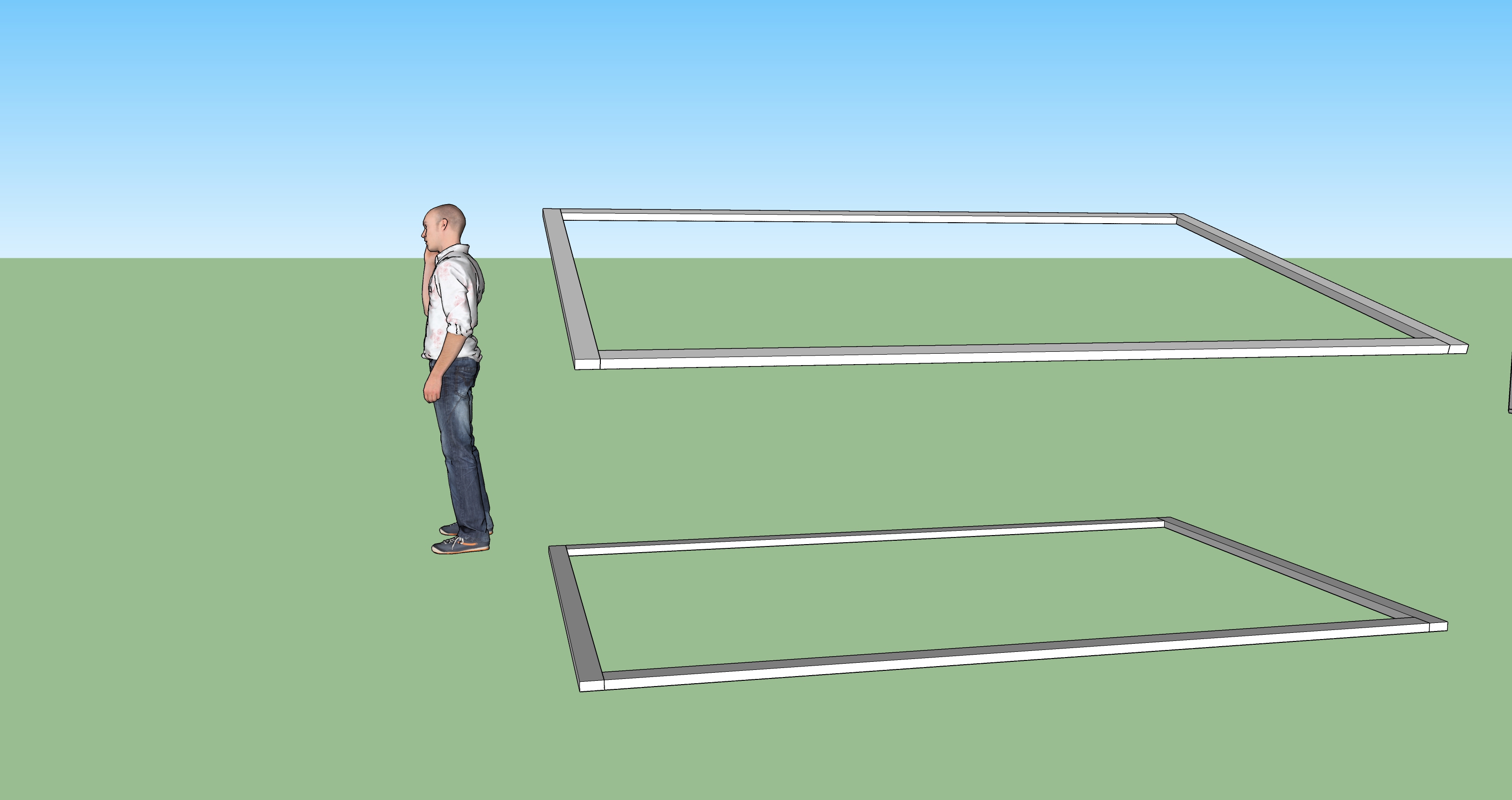

Above and below each panel is a full-length 2x4 to tie it all together.
The bottom one is pressure treated and at the corners they overlap the wall sections to tie them together.

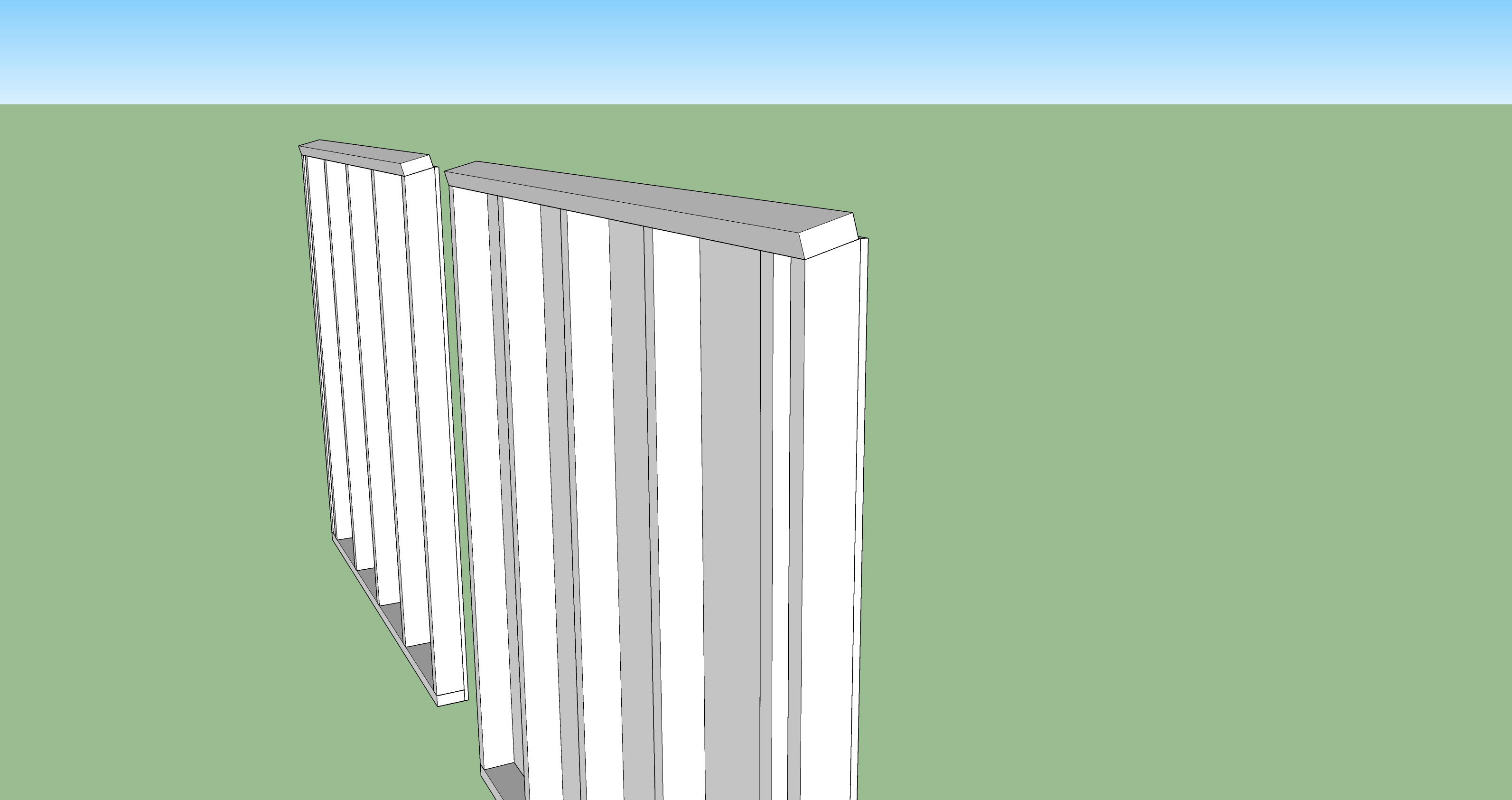

I also have a question about how to frame the front and back. This is how I have it drawn up:
But it doesn't look quite right to me. I want the top of the wall to be sloped so that the roofing bears on the entire width of the 2x4. It seems my choices are to either angle the studs or cut the top piece with a bevel on a table saw. Thoughts?
