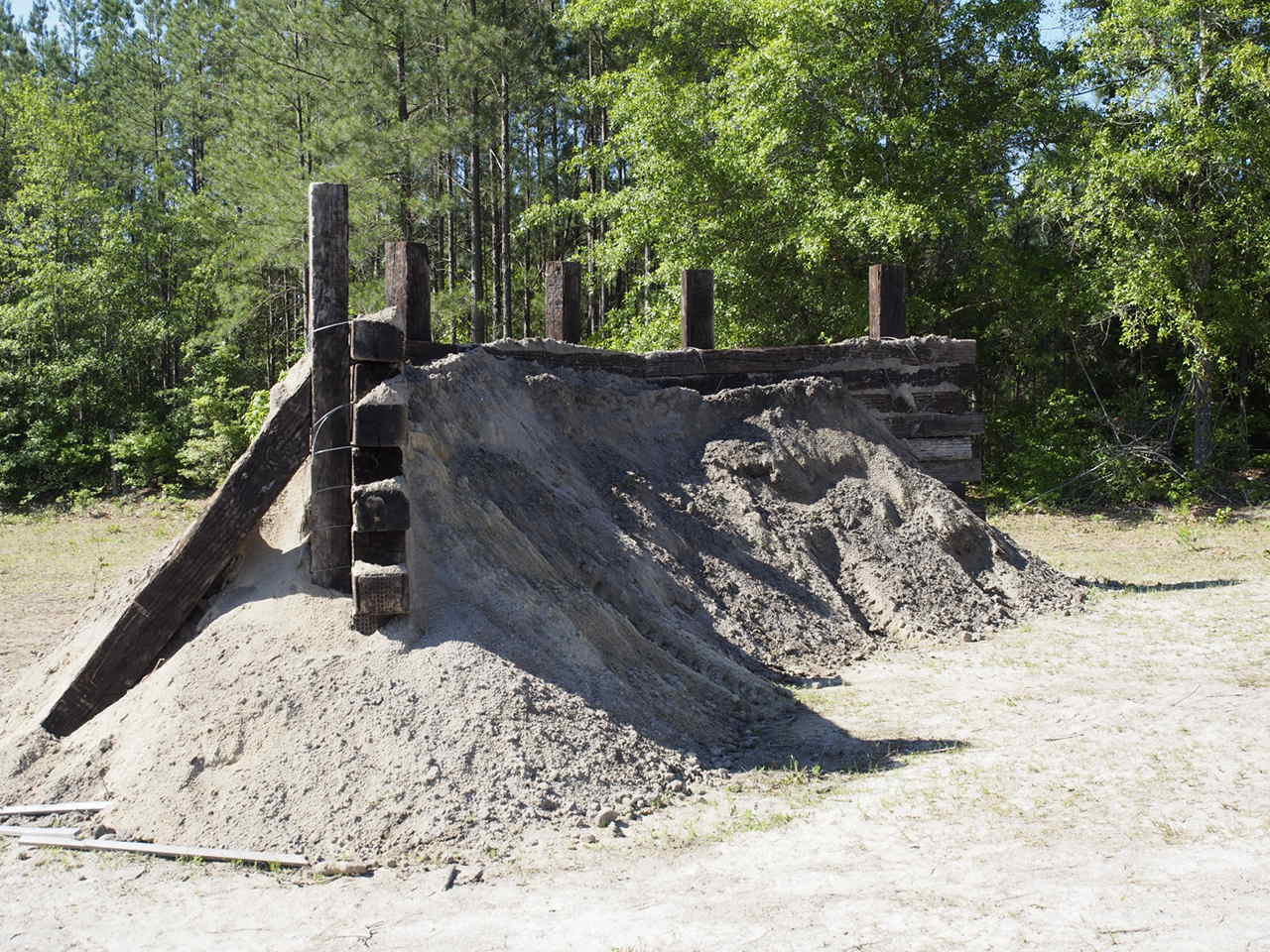

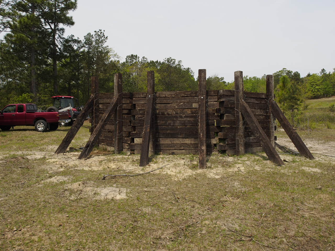

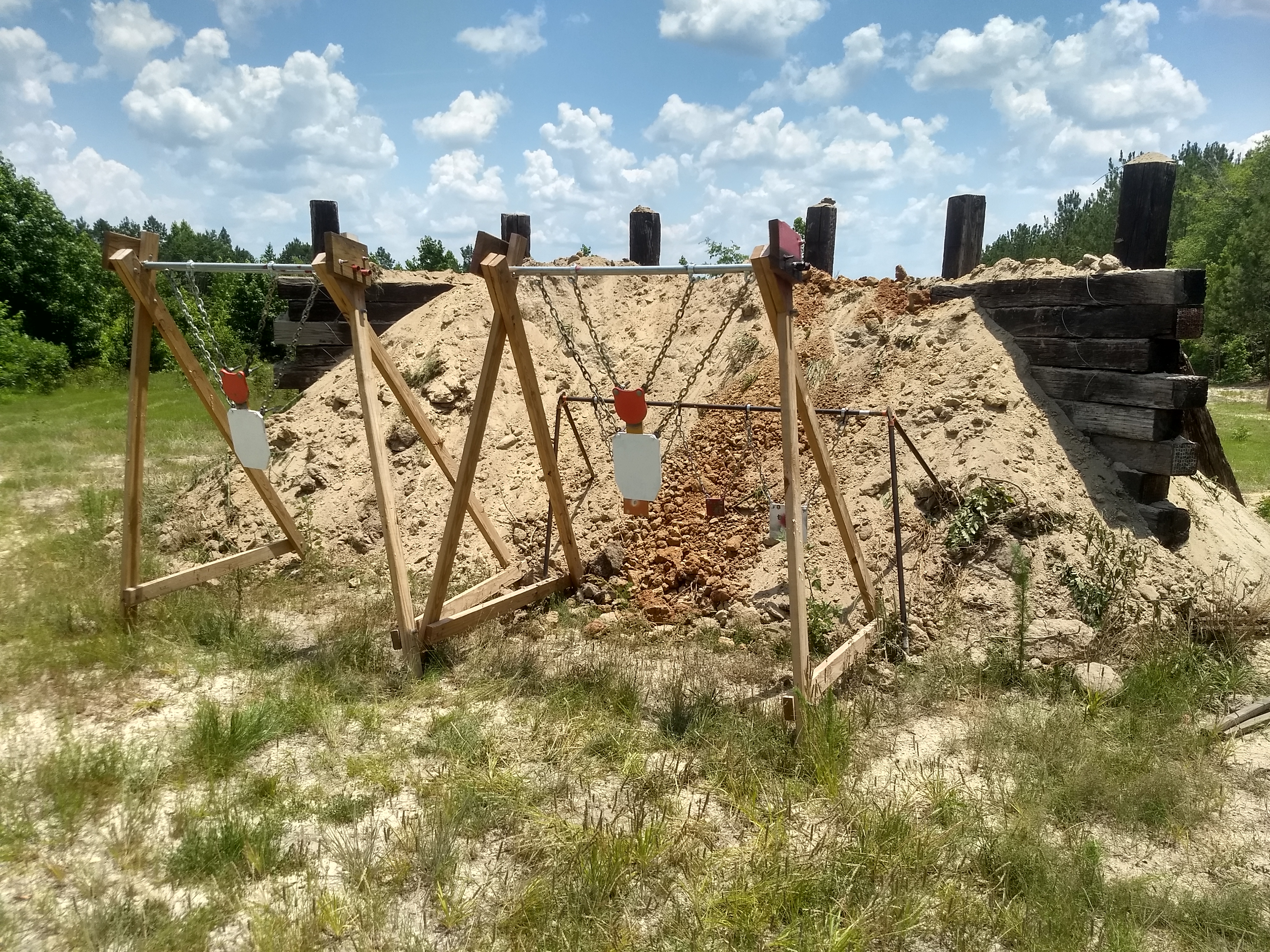

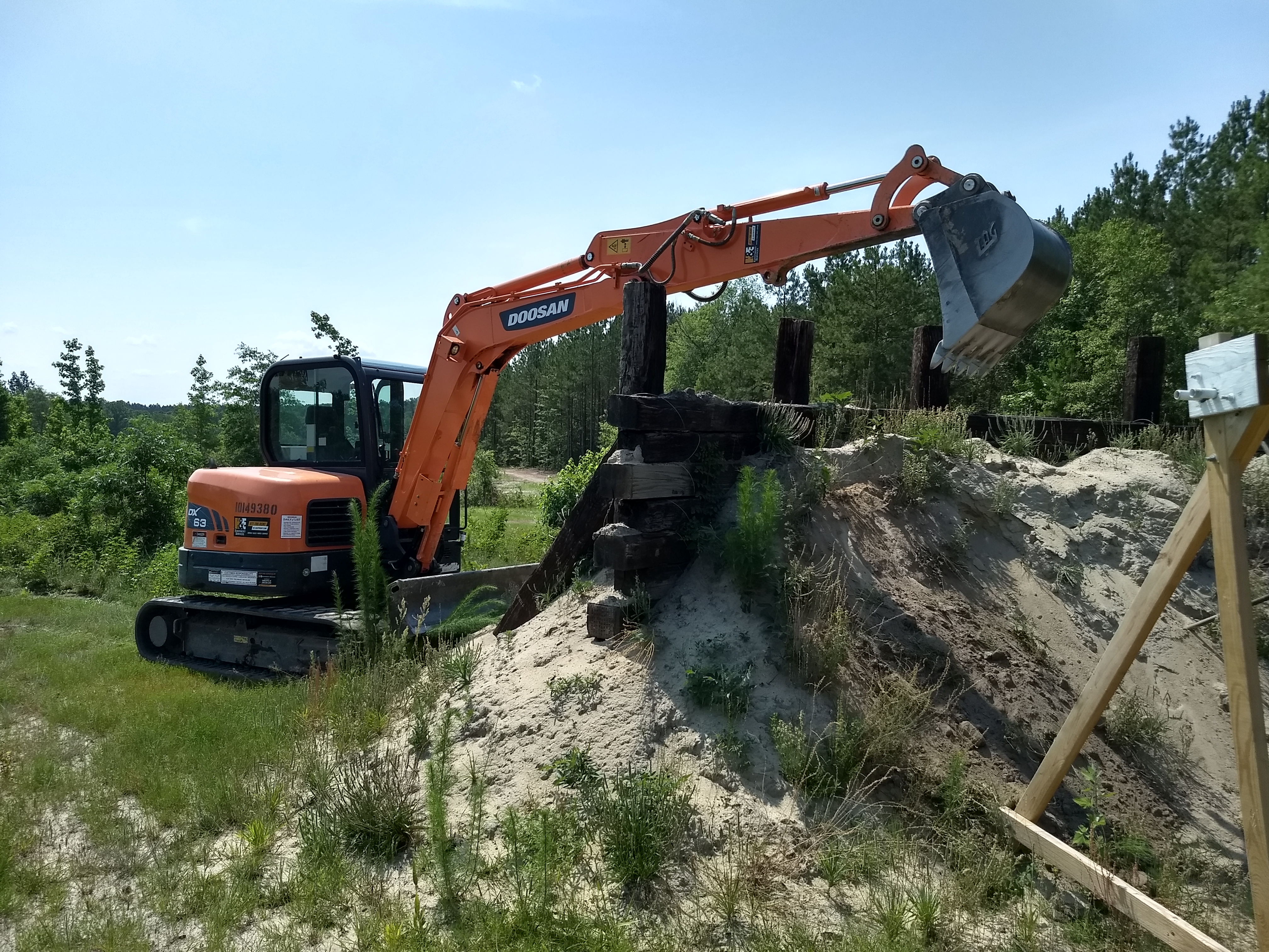

This is my 100 yard range and it works well. It needs to have dirt moved from the bottom to the top once or twice a year depending upon rainfall. The soil is a sandy loam and I had no trouble digging with a Kioti DK45HSE nor a TYM 394, although the TYM's reach is a bit short to reach the top of the ties. There happened to be a mini-x available last month and it was much easier to move a large amount of soil in a shorter period of time for the annual maintenance. But the tractors worked fine in this soil type.
