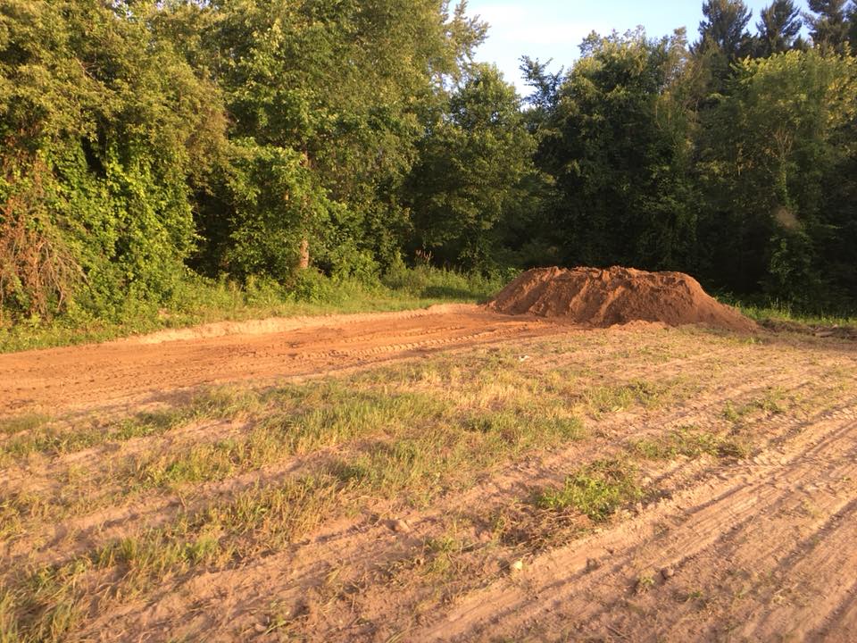

Well, it's started!
The area it's in is wavy ground, so I am slowly evening it out and using that dirt to start the berm. It's hard to see scale but the berm is about 7' tall and about 15' long. Once I get the length to about 30', I'll likely start on the other L (after putting in some drainage).
So far, I am using the box scraper to drag dirt to the berm area, then backing over it and using the FEL to pile it on. I may yet do a wall of some type behind it (then use the FEL to move the dirt back against the wall by 'up and over').
This pile was the result of only 3 hours work. The LS XR3135 is an eager little beast!
