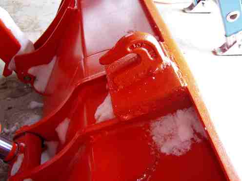

Hey can you tell me and made maybe show a pic of what you have in the middle of your bucket on the bx. Is that something you made and added?

TomPenny - My dealer welded a hook on the bucket prior to delivery - pic attached.

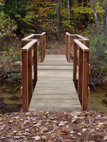

#28
</font><font color="blue" class="small">( How much weight is it rated for? )</font>
More than it will ever see!
Standard pedestrian live loads are 85 psf, this one is good for over 150 psf. I didn't need the middle stringer, but wanted to use 2x decking, so there it is. It's really stiff - a friend of mine weighs about 280 and I told him to jump up and down in the middle. It barely vibrated.
