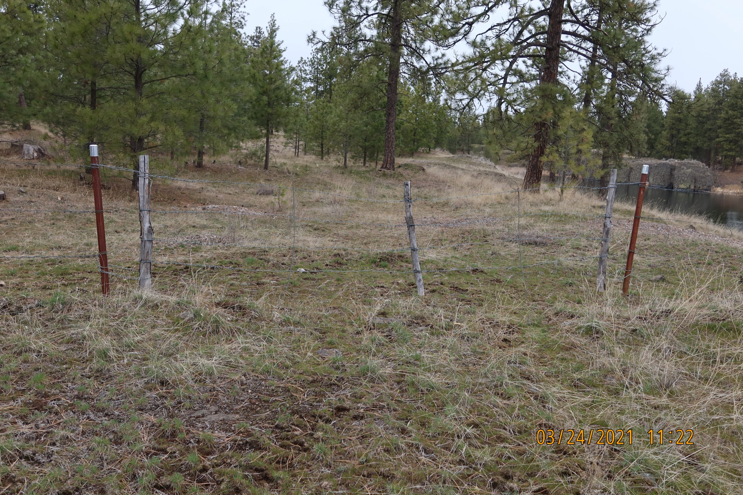

/ Building a field gate #15
Here is one of my three "field gates". It's designed, engineered & constructed to accomplish just one task. Keep the cows out. It does that very well.
Heck, ning - the gate you constructed is a whole lot fancier than the first - outer - gate on my driveway.
