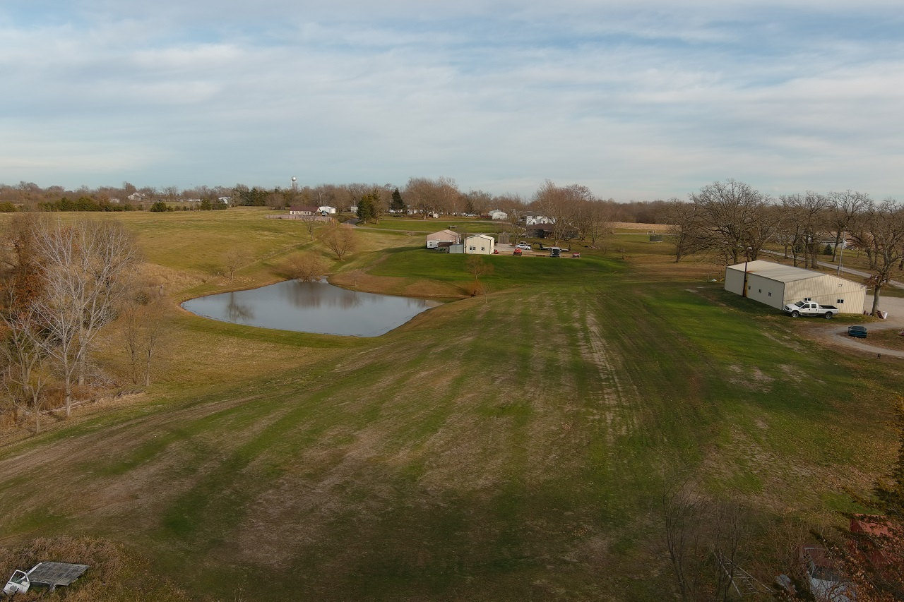

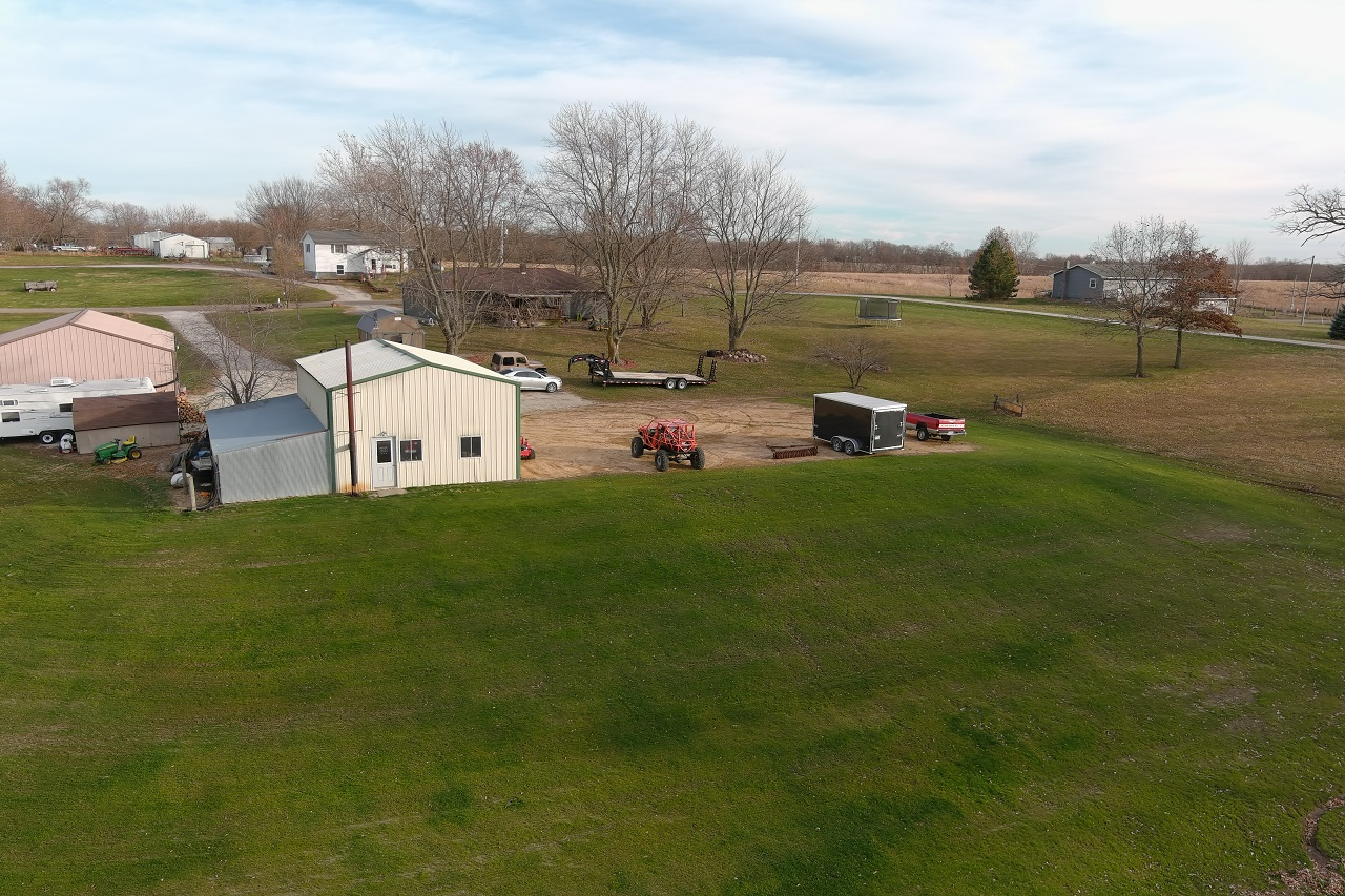

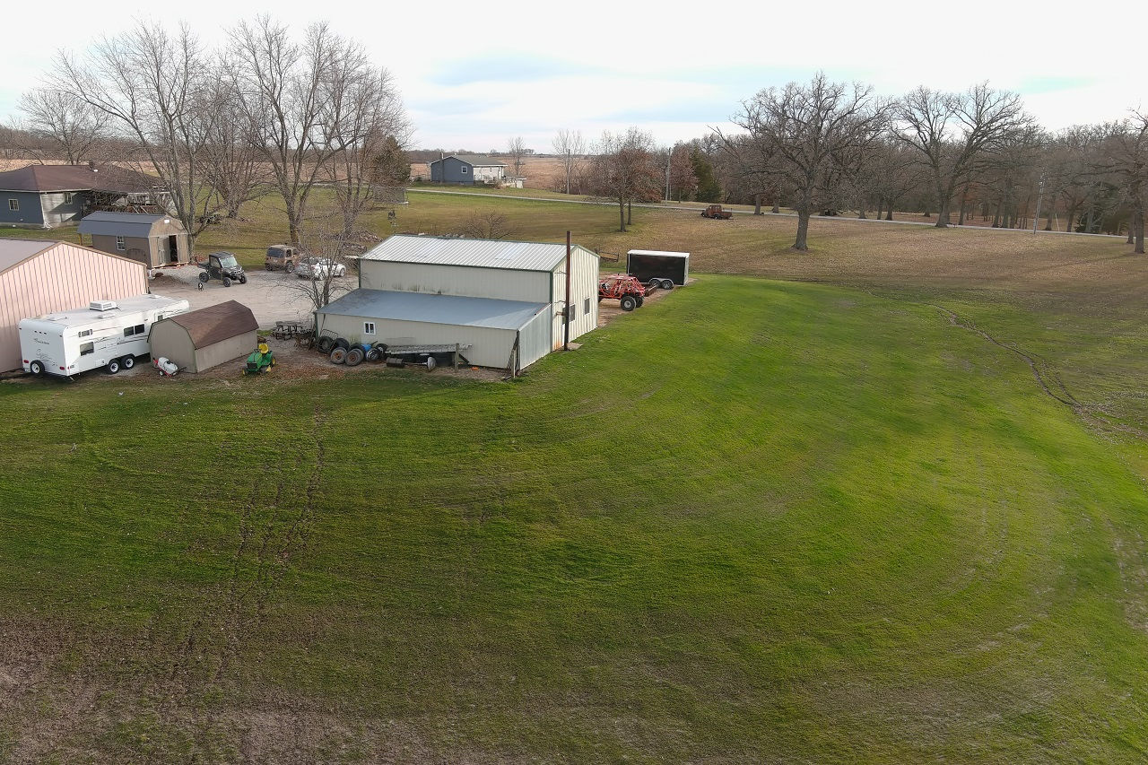

Yes, that's what we did. Even stripped the top soil off the areas that we elevated. No need in burying good top soil.
Sheldon has it seeded now. I'll try to get up there this week and take some "done" shots.
Next year he'll have a shop extension added. I'll come back with pics after it's done as well.
A Drone gives great perspective. But in this case it also "flattens" everything. Hard to envision how much fill was added at the far end and toward the borrow area.
Yeah the drone fish-eye and altitude definitely flatten the view, but in your pics we can still tell there is a huge depression beside the shop that you obviously had to raise up to match the building grade. Maybe even 10 feet or more of fill to bring it up? Wow, lotta dirt. How many gallons of diesel were used to do all this?
   / Building a dirt Shop Pad
#19
Took these pics yesterday.
Farthest corner from the existing building was elevated 11ft.
Didn't keep track of diesel fuel burned. That's actually a minimal cost that's rarely tracked. :)
