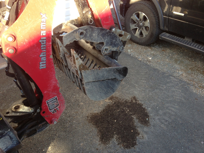

I added four bolt on teeth to my skeleton bucket. I have the same teeth on my stock bucket and on my front bucket. They work great but are $30 a tooth in my neck of the woods. I am thinking that they would be better than a tooth bar and only take a few minutes to remove.
Did you build that bucket from scratch? How does it work for you? Any video of it in operation? I imagine it would be real handy for screening from a stockpile to make top soil. Id probably run a sightly smaller mesh for that job though. Looks real useful.
   / Building a BX cleanout bucket #28
Yes I built it last week but its been raining ever since so no video yet. I dig out and spread a lot of gravel so I want to remove the larger rocks to make it easier to level out. I have the ribs spaced 1.5" apart and it does the job. I tried it out in a pile of old sod my neighbour had and was thinking that it would work better with a screen to get good topsoil but I would rarely use it for that. I have plans to build a topsoil screener which I think would be a lot faster. This is more for removing rocks from the top layer of gravel.
   / Building a BX cleanout bucket #29
Nice job on the skeleton bucket:thumbsup:
