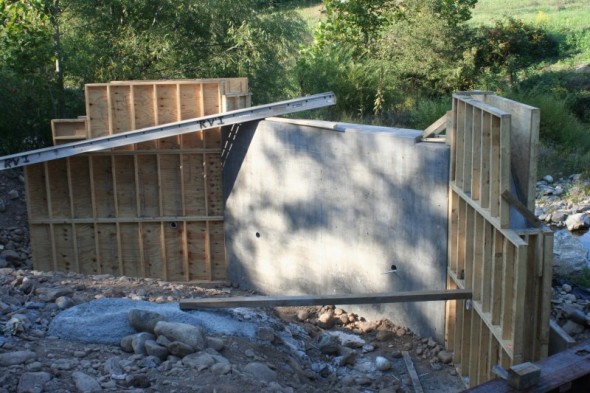

Abutment and wing walls on the first side are now complete.
We are now digging on the other side to pour the footer.

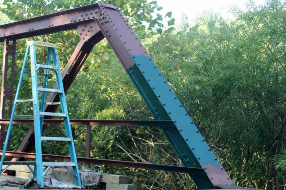

About 50 hours of metal work have been done to address weak areas in the bridge.
I have prepped most of the bridge for painting and started priming.
I included a couple of pictures. The forms have now been stripped from the wing walls.
The green we tried as a sample looks better in real life but I still am not sure if it is better than the red.
