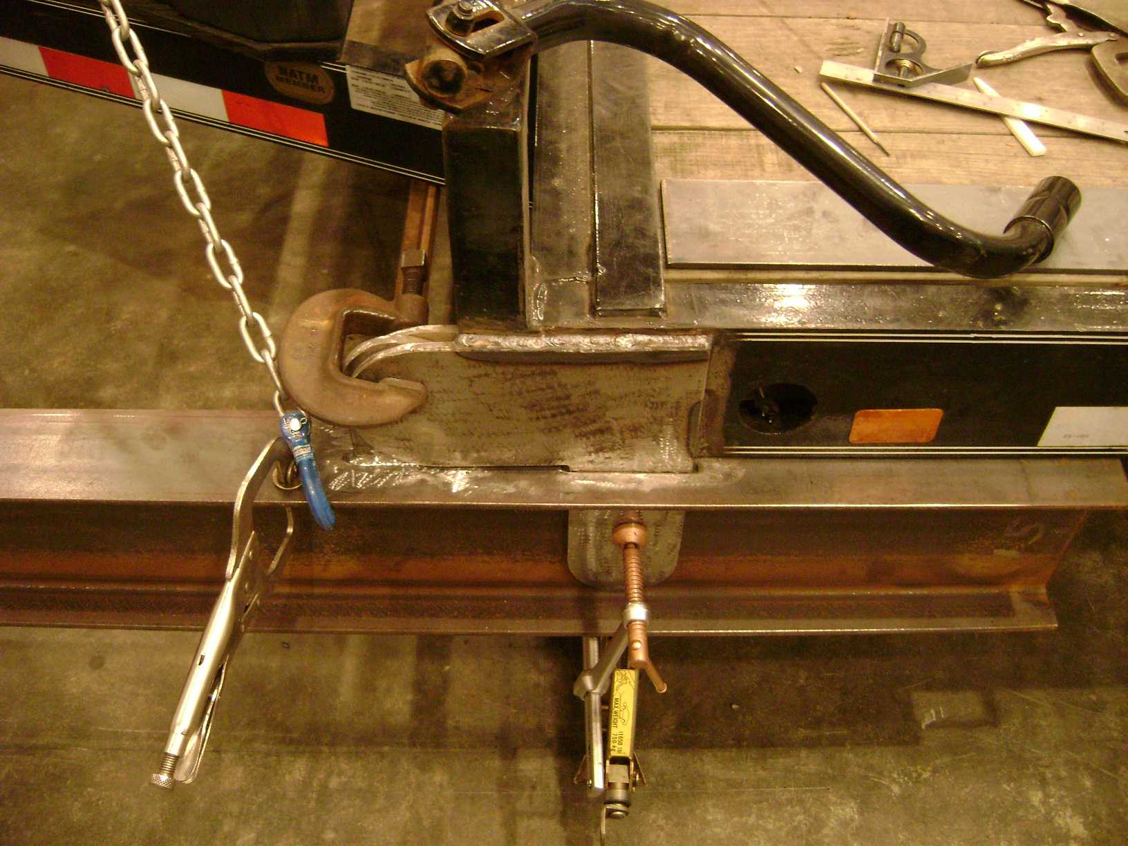

Just about got it warapped up. I need to paint and put the desk on and wire it, will post pictures once completed. I will let you all know what the state says as I will have it inspected.
   / Building a 5th wheel trailer to haul my tractor. #27
Thanks everybody for the compliments!;)
No DOT inspection here, yet! When I bought the trailer, and changed the name on the title, they did not want to see the trailer. Every year when I need new tags, just go the court house, and pay the $30.00. So far no one has wanted to see the trailer.
Now you're out there a country mile for doing this, if you are in an accident, and they can prove something went wrong with the build and you caused the accident. You may not believe this, but I've built way more complicated items in my past, where people's lives depend on my welds everyday. So my confidence level is pretty high. Use your best judgment, if you're not ready for a project like this, please don't do it!

Good point on the liability aspect. Most people never think of it... it is always on my mind.
My wife's cousin is a certified welder, whom I consult on many projects, and have spoken to him about this one as well. It's nice to get a 'nice job' comment from him on my welding skills from time to time, he seems to think I do well. Under his supervision and with my tendency to over-build, we should be safe.

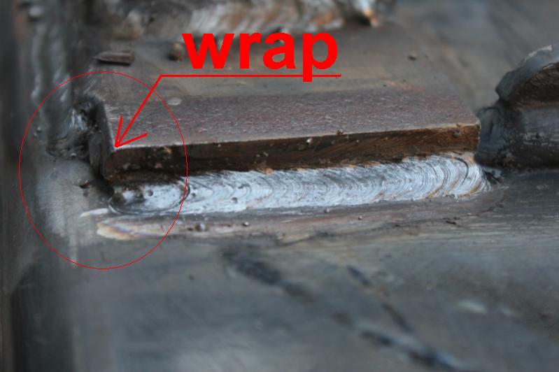

I will add one more, "Nice Work". I bet that Plasma table is a huge time saver. Please tell me what you mean by wrapping corners and filling craters. I am just learning the finer points of fabrication and am always looking to learn.

Wrapping the corners is when you take the weld all the way around a corner. Another good habit to get into is to try and never leave the crater on a corner or edge, try to leave it in the center of the weld, grind the crater down a little, then run the next weld into the crater. What I do when finishing a weld to fill the crater is to back up about a 1/4- to 3/8 of an inch. Also close up the arc length, this will help cool the puddle as well so it will fill easier.;)

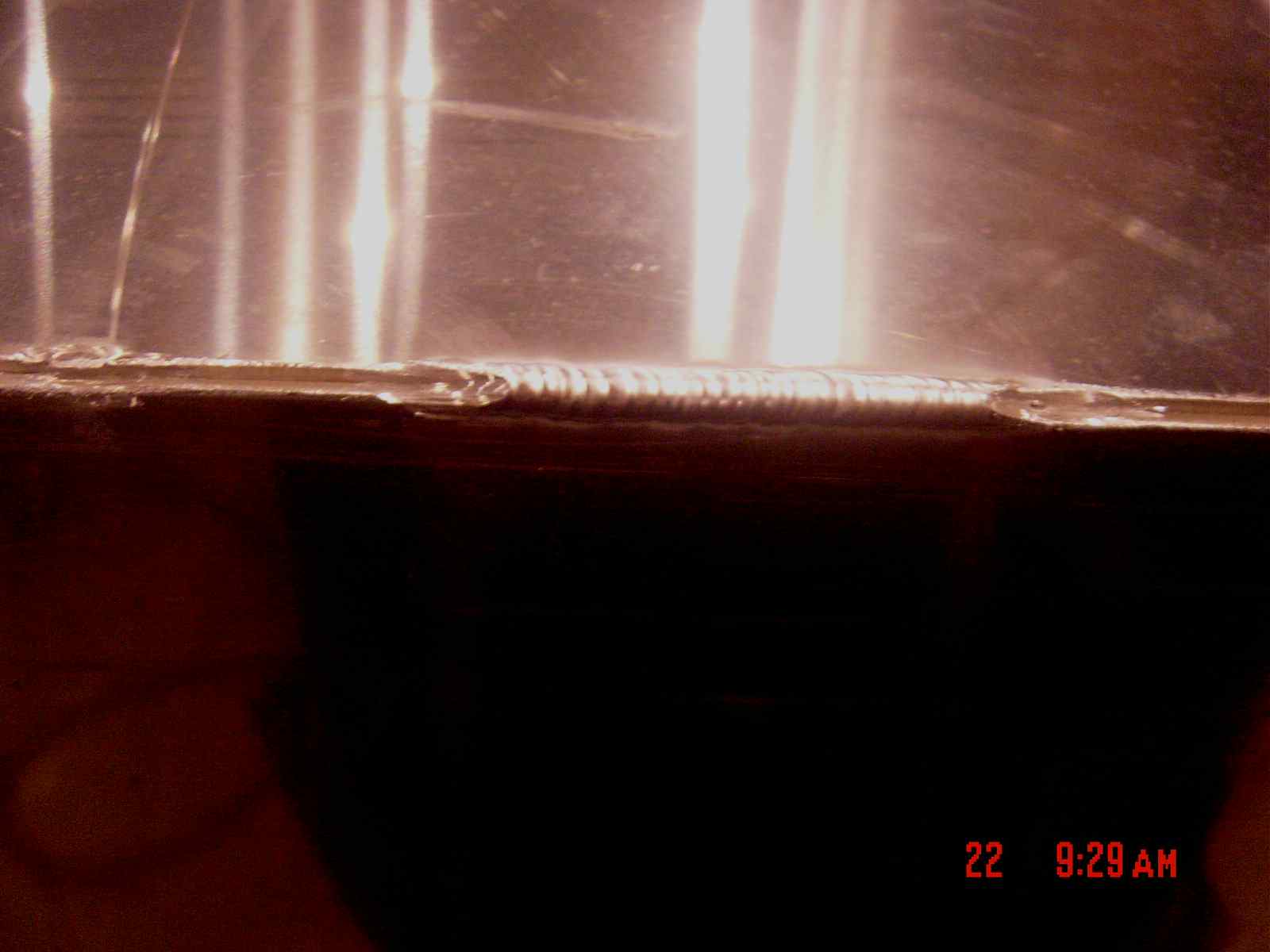

Other good habits, grind the starts and stops of each weld. I like to grind a little ramp to them.
Here is a picture of the stop in the center of the weld. You can't always do this, but it does help if can. ;)

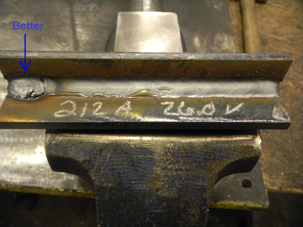

Here is what I mean by filling the crater / stop. Now these pictures are some playing around by me with spray transfer, so the welds are very hot! In this case I had to back up, but also turn the Mig gun back towards the weld. As you can see in the bad crater, it blew the metal right out! :eek:
