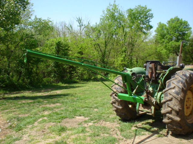

I think I used about a 10 degree upward angle on mine (100 degrees or so between the upright and the boom).

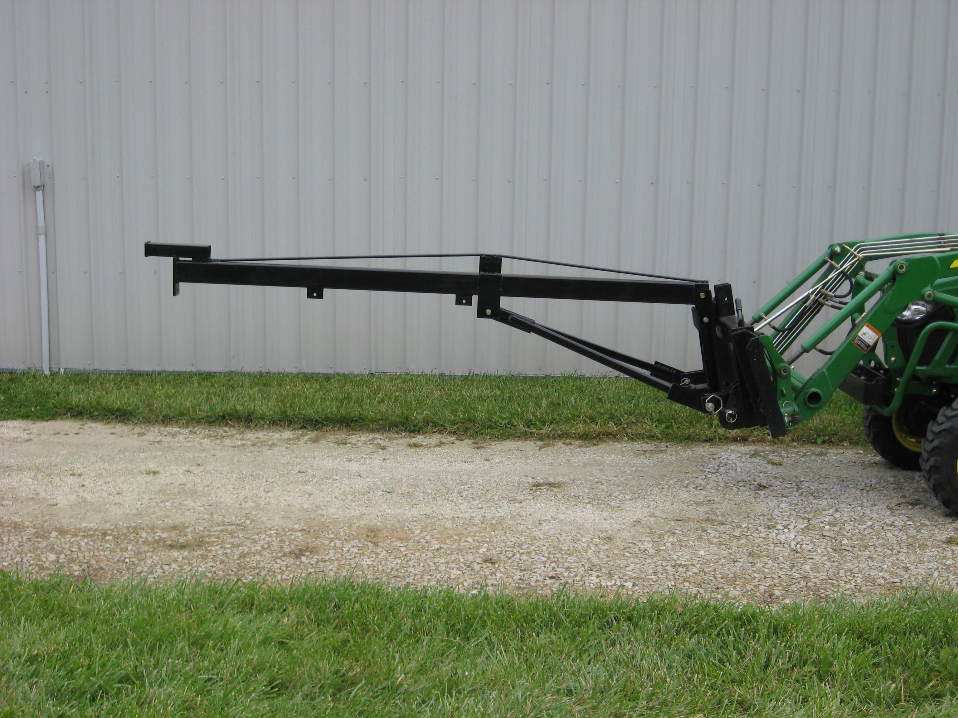

I just took a reg boom pole and adapted it to the front of the Power-Trac, and it works quite well.

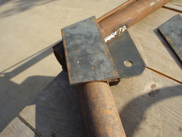

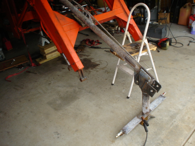

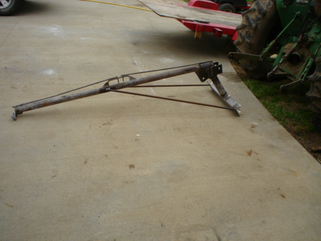

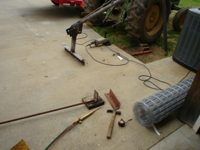

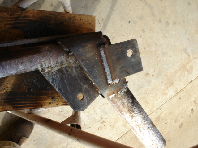

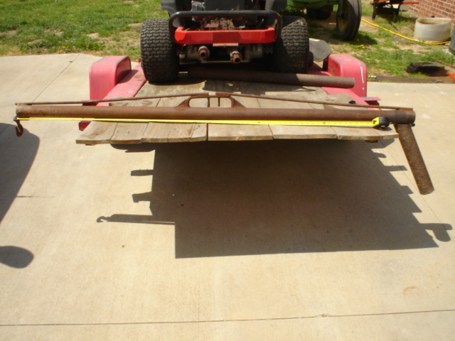

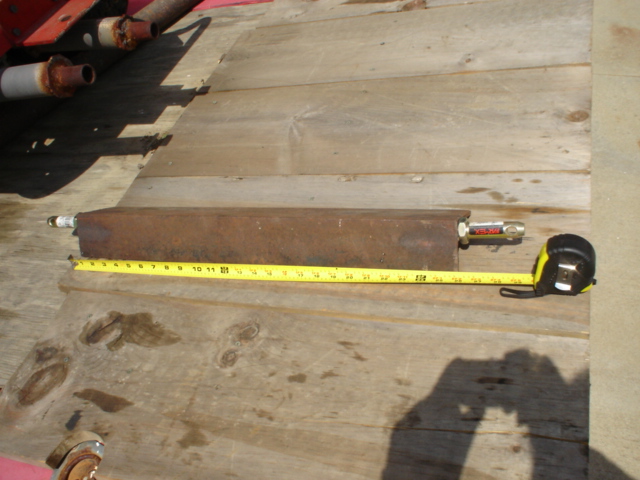

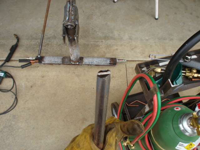

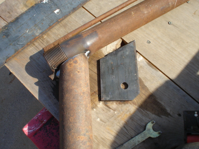

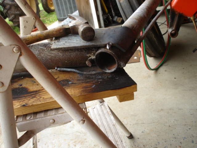

Here's how I made my own. Took a 26 inch piece of 2x3x.25 angle iron and welded 2 lift pins to the inside corner, $8.

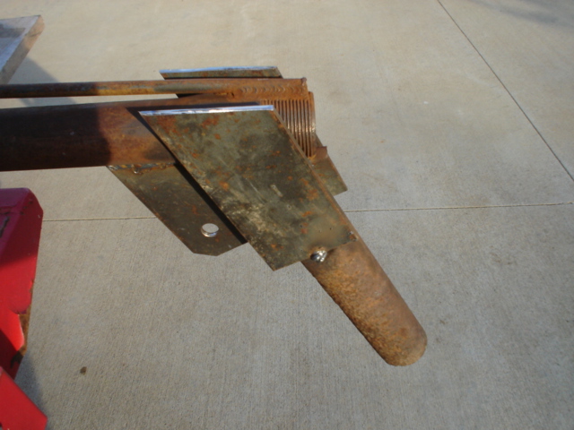

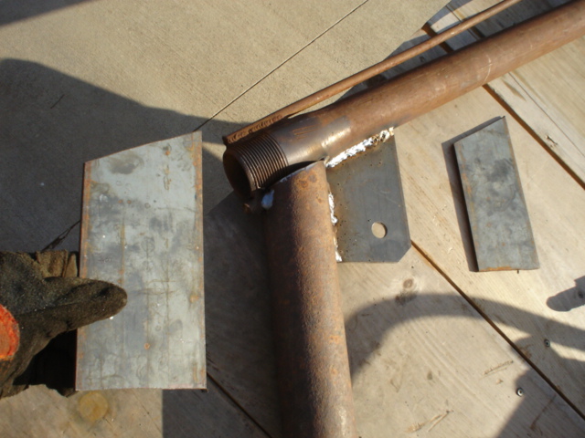

Next, I was able to find the top horizontal portion of a boom pole at a salvage yard ($10). I had to weld on the round verticle support. It's 2.5 inch pipe, and about 16 inches long. It looked pretty weak, so I added a bottom support in the center (with an additional lift hole) and welded 2 more flat pieces to the round tubing on both sides. It's 1/4 x 4" flat stock.
I had to heat up the flat stock until it was red hot then pound it with a hammer until it was following the contour of the round pipe.
Next, I used some more of the 4" flat stock to make the attaching point for the top link. It's about 16" above from where the bottom link pins would be.
Next, I welded the boom to the bottom portion of angle iron (the piece that connects to the lift arms).

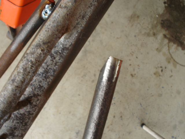

Next, I tried to heat up the side reinforcement arms so that I could pound them flat. Didn't work. So I cut them at an angle so that they line up with the angle iron and the horizontal pole of the lift.
Add a little bit of green paint, and it's done.
All the hard materials costed me about $50, and I have about $20 of the metal leftover. The can of enamel paint was about $10. For the tools I used an angle grinder, drill press with a step bit, mig welder, and a circular saw with a metal cut off wheel.

I mig tacked the flat pieces onto the round pieces at all the points of contact (just 2 or 3 places). After that, I heated up the flat pieces with a rosebud tip until they were red and then hammered them down until they fit flush against the round parts. Then I welded the 2 pieces together with the mig. Only used the oxy/acet for heating purposes.
