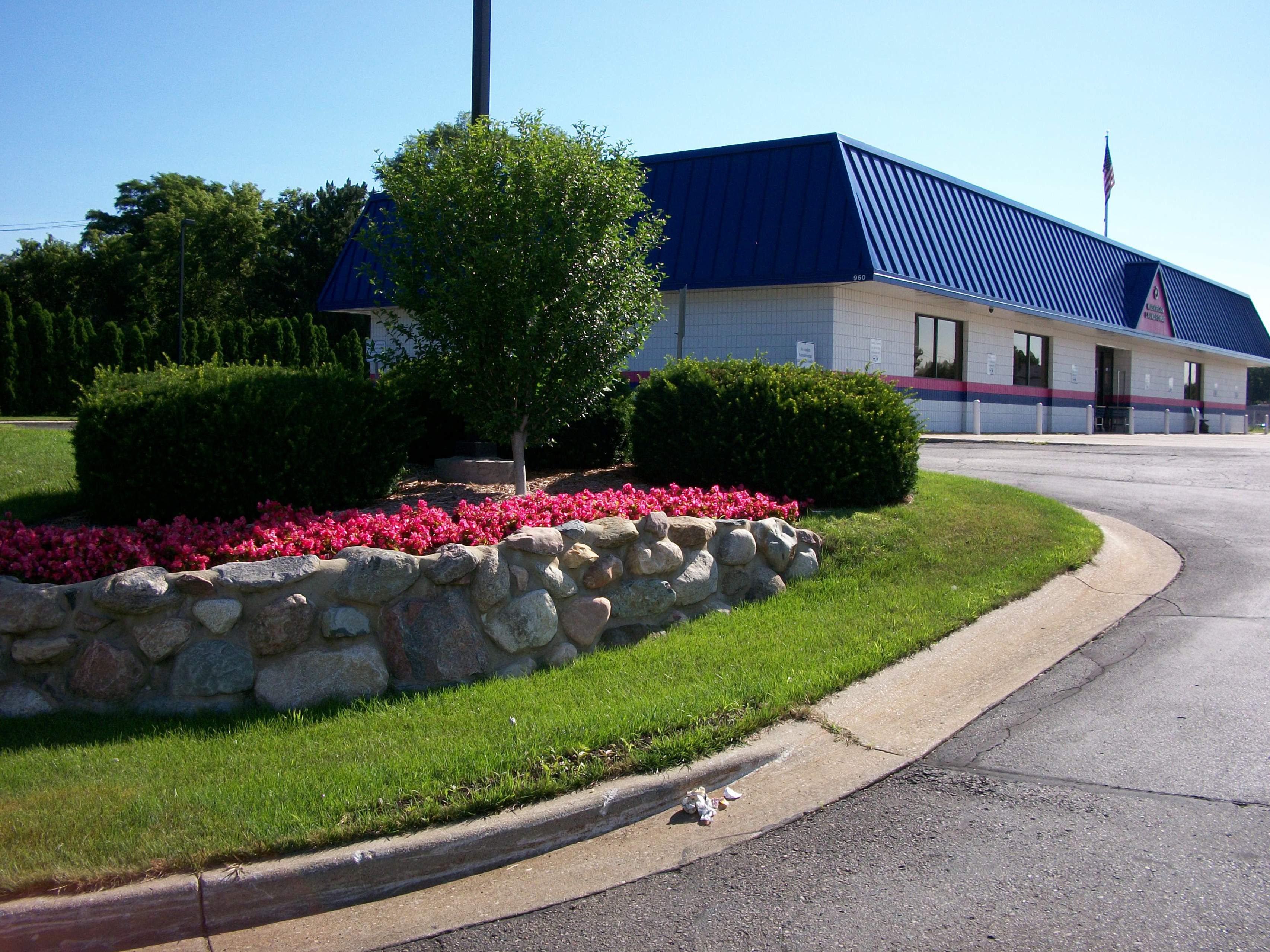

I also built a fieldstone wall at the entrance to my laundromat. In that project, we poured a concrete footing and then layed the stones with morter. We finished by pouring concrete behind the stones and then brought the grade up to the top of the wall behind it. That wall isn't going anywhere. (See photo)
