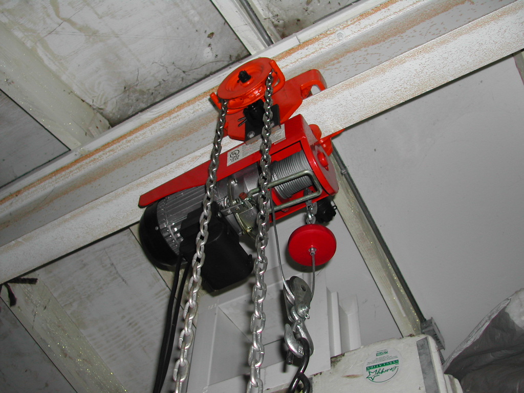

If you design your building with a ridge beam, you can put in one of these.
I meant to post this in "HF Tools That DON'T Suck". I just priced some new
steel at PDM, and some shapes are now back down to $0.71/lb in 20' or 30'
standard lengths.
My building is in humid riparian zone of the coastal rainforest, so humidity is
quite high, winter or summer. My walls are fully insulated so the only
condensation I get is sometimes a bit of dampness in the concrete slab.
Thankfully none on any metal tools. No heating system.

Dave (dfkrug), You have to stop reading my mind.;) That hoist looks pretty cool.
