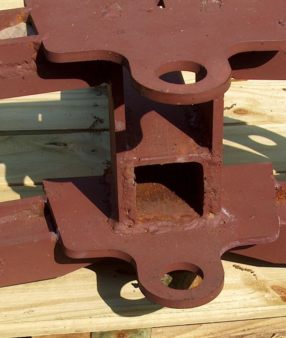

David, I too went through the same thought process about the small backhoe project. Although you can find a used add on units, they usually run anywhere from $2500 to $5000, but they are just to heavy for the PT. I found a guy in Canada that laser cuts the small parts, and ships them to you in several boxes. I had to buy the 4X6, and 4X4 box stock locally. Steel has gone up about 30 % since then. The one I started is almost finished. I have built three different buckets for the unit. I'm guessing that the whole unit weighs around 650 lbs. I purchased all my cylinders and valves from Ebay.
I'm debating about using joystick or electric valves for the control. I adapted the unit for the three point setup.
JJ, I have also been going thru this exact process, buy or build... I was looking at that laser cut parts kit from the guy in Canada. Could you tell me how thick the steel is that is used for the boom swing pivot plates? Those parts pre-cut would seem to me to really speed up the time involved in fabrication and might just be worth the price if I could adapt the boom pivot area to the frame mount I have in mind for my tractor. Could you also tell me how far apart the boom pivot base plates are spaced vertically? Do yo have any pictures of that boom pivot area on your project?
Thanks
   / Build A Backhoe For PT425... It Could Happen #423
Thanks
Here is just one picture of the spindle just welded together. The thickness is 3/8, or 1/2 in
Thanks JJ, that was just what I was looking for. I kind of like the way the plates setup the outrigger angle. I will have to look at that guys website again. I think his parts kit is around $999, but it shure would save a bunch of fab time. Are you still working on the plumbing or have you got to use it any yet? I would be interested to hear how it works for you.
