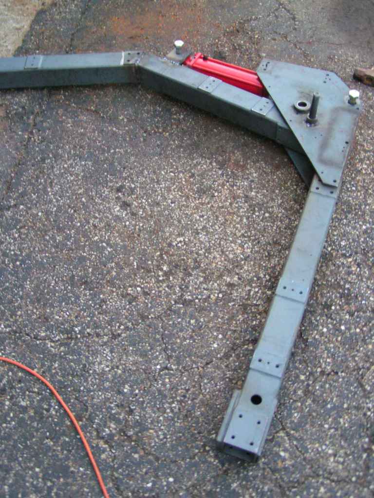

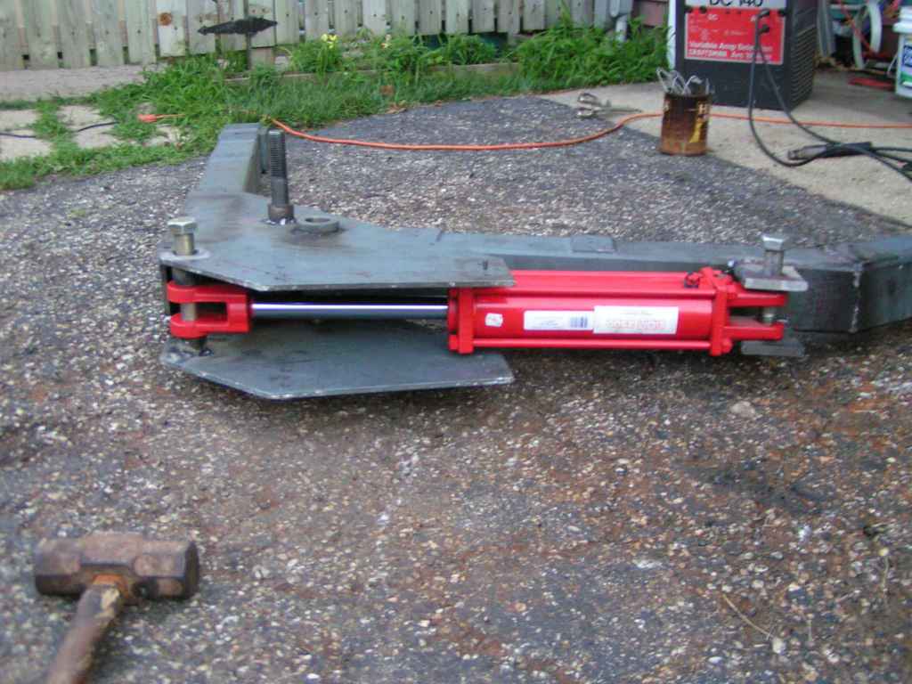

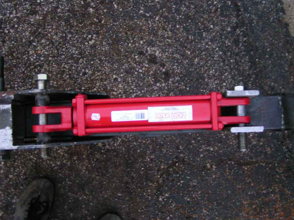

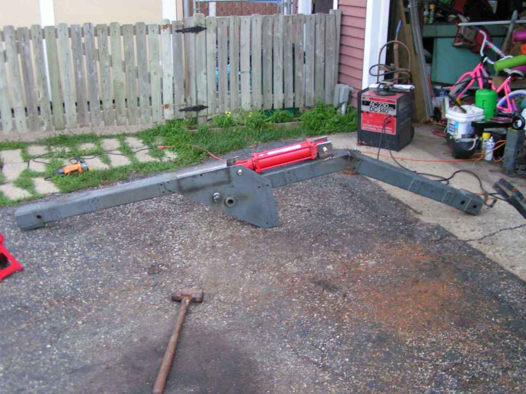

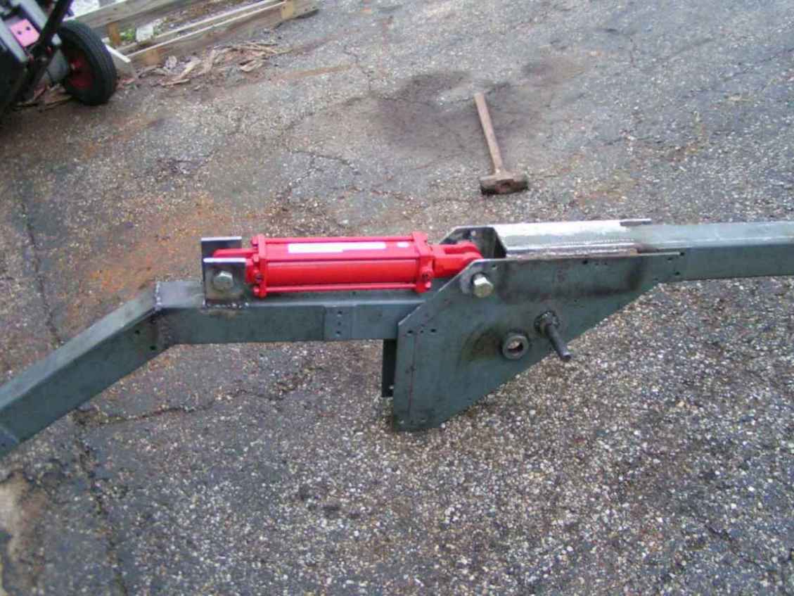

Well, so much for waiting two weeks... the kids worked on their projects unsupervised with no problems, so I got to work on mine again. :)
Finished drilling the holes for the dipper stick cylinder and mounted it and the rear brackets. Tacked everything in place and tested for articulation... man, it swings smooth! :D
This is the 10" cylinder. I could probably go 12" or 14" without any modification, but I want to make sure that I cannot accidentally hit the backhoe pivot point or boom as J_J mentioned that someone he knew did this and damaged the boom cylinder. While my boom cylider will be on top, I still don't want to be hitting anything. I think I will use the 10" and see how it operates. If I am dissatisfied with it, I can always add a longer cylinder, or I have another choice... It is currently set for maximum lift height, which will also give it maximum depth while sacrificing the ability to dig close to the tractor. I could put another set of holes closer back towards the tractor on the dipper brackets. I could then sacrifice lift and depth for digging closer to the tractor. It would just be a matter of removing the pin and relocating the rod end to another set of holes. I think I'll leave it as is for now and only make the modificaton if I need it.
Oh, yeah, I forgot... here's some picture goodness! :)
Running totals:
Time = 26.5 hrs.
Approximate Cost = $380
