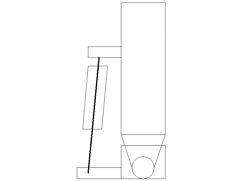

David, I don't think I get the full 180. It's more like 80/80, I am thinking about making one side a full 90 degrees. I will just have to switch the turning cylinder to the other side. for working in that direction, or just turn the PT around. Some machines use two cylinders to turn the boom. You will probably have to do some trial and error. I will be out of town for a week , Reunion, etc in S.C.
David, My boom steering looks something like this.
All the lines did not appear on my drawing. The large part is the center of the frame. The bottom smaller piece is the boom. A graphics illustrator , I am not.

Thanks, J_J. That looks similar to the swing cylinder linkage on my plans.

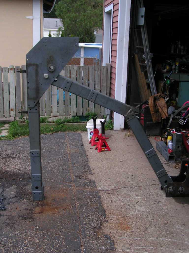

Good. That's the numbers I'm using. It will be 8" above the fulcrum and 48" to the end of the dipper stick. At that point I'll have about 6000# of force. Add to that the length of the bucket and it will be less, but that seems O.K. Also, the bucket curl will have tremendous force. It looks like it will be less than a 3:1 so somewhere better than 12,000#. Bet I can smash some beer cans with that! :eek:
Attached is a picture of the dipper on the boom. A lot of that large plate can come off.
   / Build A Backhoe For PT425... It Could Happen
#288
I forgot to mention some specs...
It it 48" from the end of the dipper to the pivot point where the dipper attaches to the boom. When stretched out flat, it is about 9.5' from the end of the dipper stick to the boom swing point back at the frame.
I need to get wheels on it and a ring type hitch on the rear and a hook type hitch for the tractor so I can move it around easier. I also need to get some hydrualics on it and the outriggers. It is getting so I have to take it apart each time I want to move it around. It was about all I could handle lifting it into that position to take that picture last night. But I'm tough! :cool: .... no I'm not. :p
