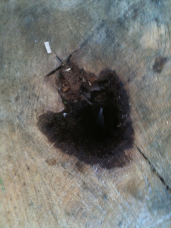

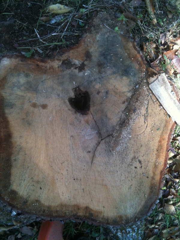

since we moved out to our 12 wooded acres, I have noticed a few trees dying for no apparent reason. Recently we had a large oak cut down because it was dead. In the stump was a irregular shaped hole roughly the size of a golf ball (see pics below). Can I assume this is some type of insect damage and it likely killed the tree? On a few others that are still living I noticed some type of decay at the base where the trunk meets the ground. Does anyone spray any type of insecticide or fungicide or anything regularly on their trees? If so what? Also on a few dead standing trees, the bark has dropped off and the trunks are smooth with what looks like squiggly bug tracks or something. Thanks for the advice

While you may have other problems that appears to be good old fashion rot. Being in the center it is really not that uncommon for rot to develop near the ground somewhat centrally located in the trunk. The list above however is a pretty complete list of common problems you will see. I have cut down nearly as many trees that were hollow in the center( or had the beginnings of being hollow like that one) as trees that were solid. If it were me I wouldn't loose too much sleep over it.

That pic looks like decay of the heartwood. The center of the tree is normally dead and decay of that wood doesn't hurt the tree except to make it weaker--and it takes a very large decayed area to make if significantly weaker and subject to breakage. Scrape around in there with a knife blade and it should be soft if decayed. It could be evidence of some kind of root disease I haven't seen, however.
