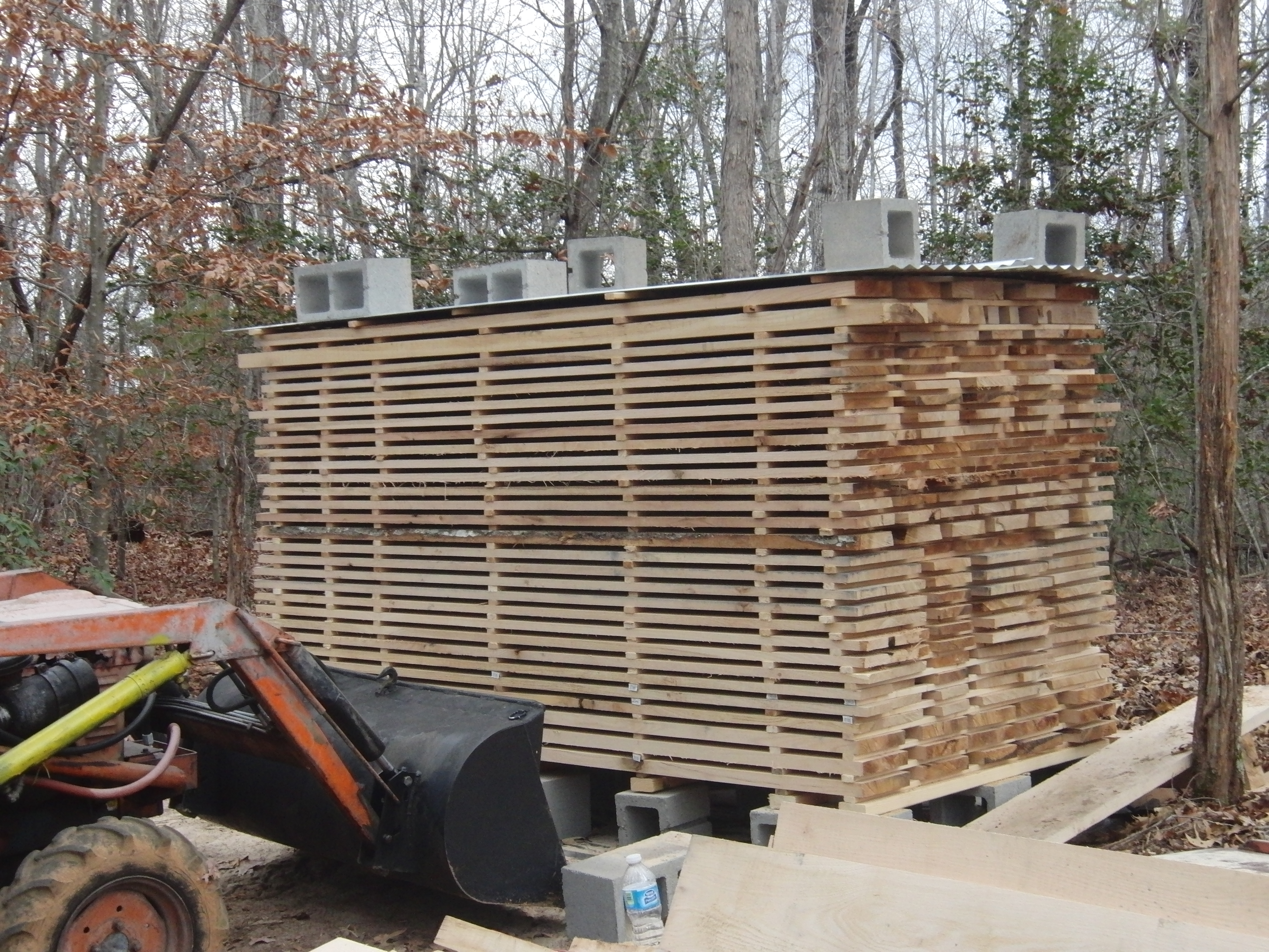

Shelter as in protection from rain? Or that the wood would need to be in a climate controlled area?
Humid might be an understatement :cool:
Protection from rain and bugs immediately.
But perhaps you could erect a minimalist tent frame over a well stickered stack, throw a tarp over and put a fan on it to force air through.
/edit - remember it's the rule thumb - an inch a year for drying. So if you cut a 4" thick slab it might take 4 years to dry.

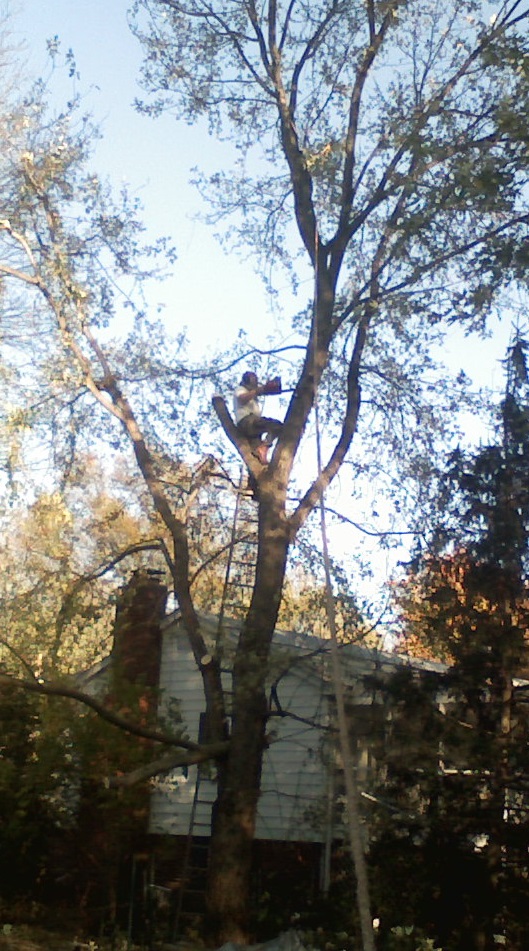

Really difficult to tell what the wood will be like without cutting it open. Cavities, insect damage, rot, embedded metal are all possible.
Almost every tree I've milled has had some surprise inside.
The quotes to get it removed have been around 3k for removal, including stump grinding. One company will do it for 2k, but doesn't do stump grinding.
Removal means ALL problems are gone. You don't worry about climbing up in the tree, limbing, disposing etc.
I'd view that as a 3k "grant" to buy more equipment and talk that tree into laying down. But then I enjoy getting up in trees with a chain saw :)
