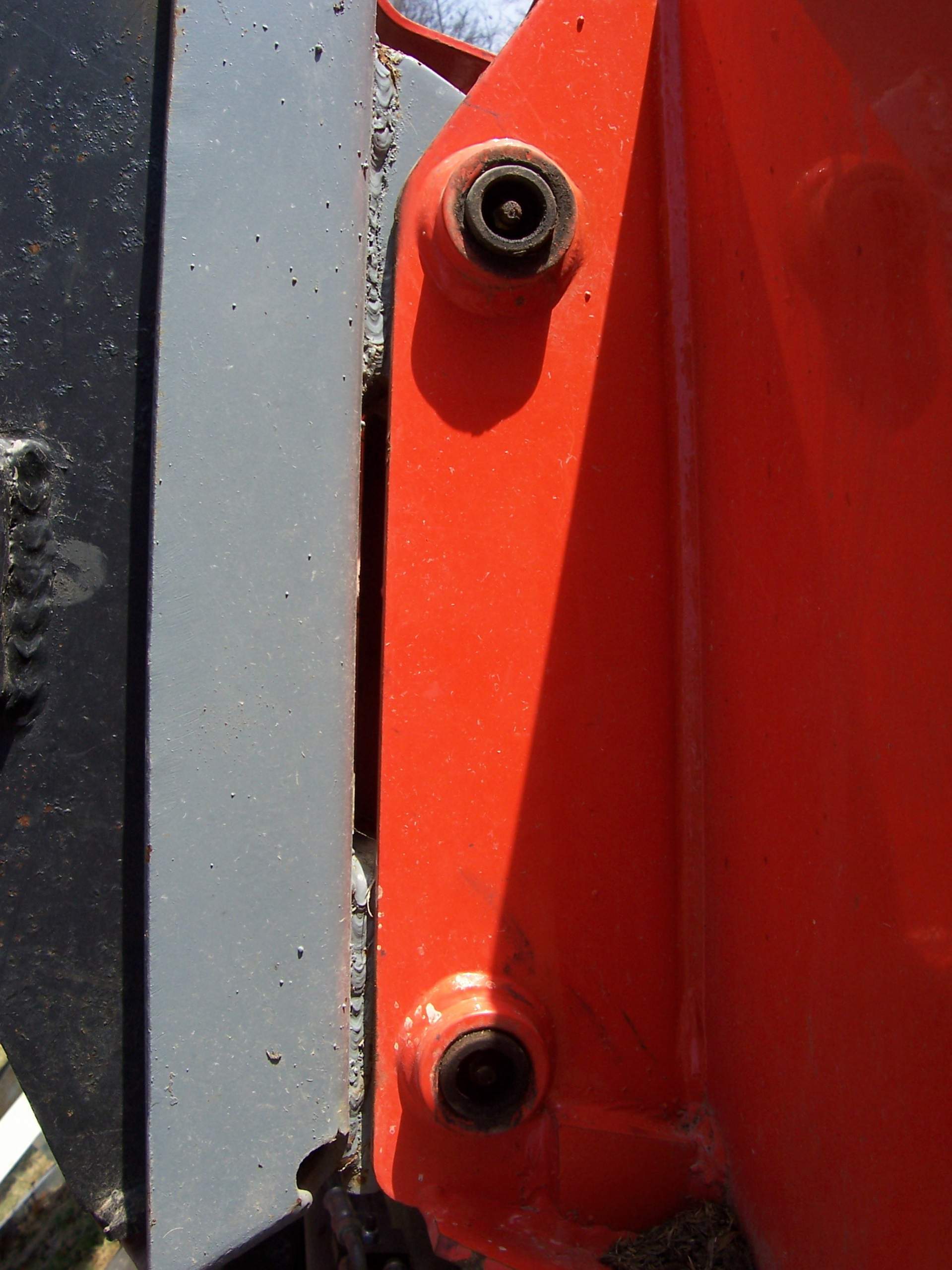

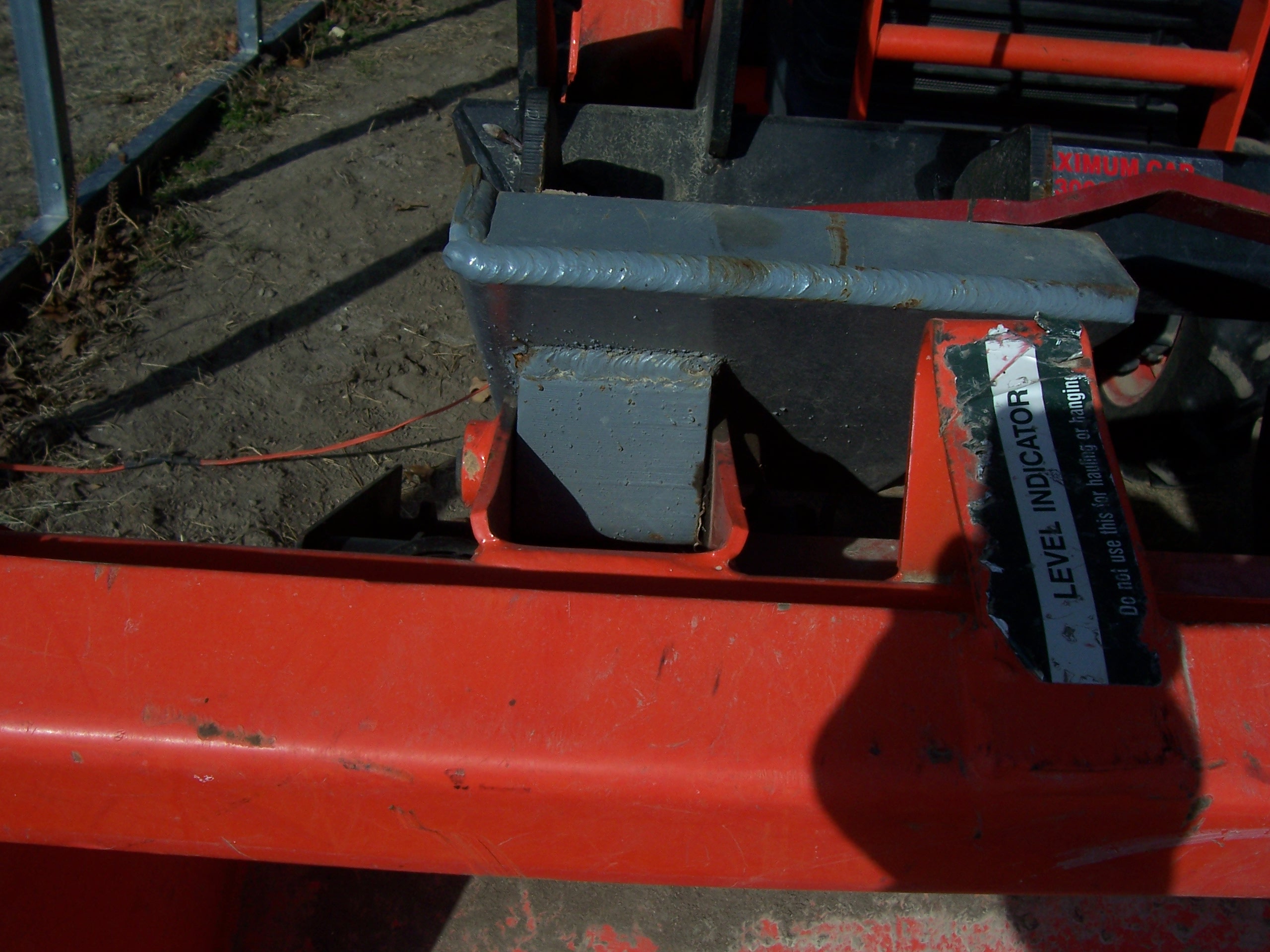

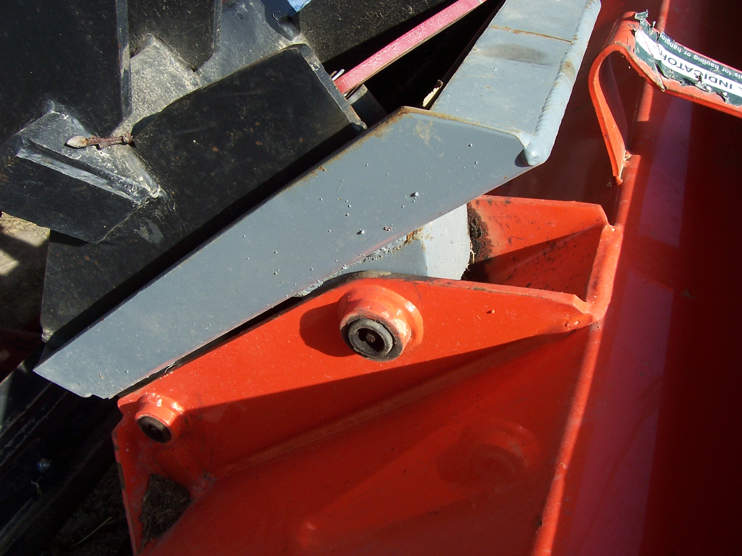

I had a friend cut and drill some pyramids to weld to the QA adapter plates and pin to the bucket. Seems to work fine. He also made me several QA plates for future attachments.

It would be nice to not have to cut the ears off on a bucket conversion like yours but I would think that you will lose a lot of break out force with that set up. I hope it works well for you though.

I know I added a few inches length to the FEL and will lose some lifting capacity because of it. It was a trade I was willing to make because of the ease of adaptation.

I get it Tigers. I just didn't want to cut on my oem bucket. I guess I'm just **** about keeping it oem if I ever want to put it back w/o QA.
/ Bucket to QA conversion #10
Well I don't think its out of the question purchase one of those $100 adapter plates and then engineer brackets that could link to the pin-on hardware on the bucket end.

The triangles were cut from die plate, I forget the thickness, but attaching those four "lugs" to the qa plate was all the welding that was done. It was simple for me, I need simple.
