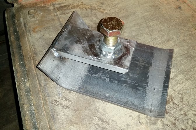

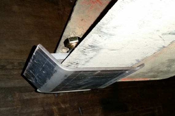

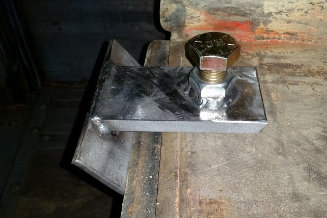

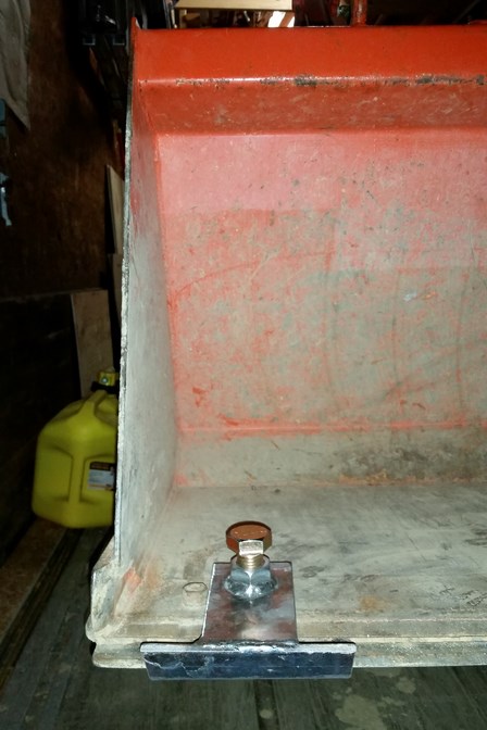

I just picked up a tractor a few months ago and I plan to use it to move snow, but was a little concerned about tearing up the gravel area in the parking area off the driveway . I figured I'd make something along the lines of the skids on a snowblower and mount them to the bucket. I first thought about welding something on the side that would be adjustable and removable but decided on something simpler that would slide onto the bucket instead. I figured keeping the cutting edge up a 1/4" should work fine. I guess we'll see once the white stuff starts falling!
Here's what I came up with...
It's 1/4" plate 6" wide by 8" long. I used my press to put the bends in the plate. 7/8" bolt to secure it to the bucket.

Just checked them out and looks like the same "Ski" concept I have. They look like a quality product. Only issue I see with them is I have an edge blade bolted on my bucket so they wouldn't fit. I was wondering if the 6" I made would be wide enough...seem so as the Tamers are a lot narrower and appear to work fine in the videos.
Pepsiboy...I made these with some scraps I had hanging around. Probably better off just buying the Edge Tamers which look like they were designed to fit a standard bucket.

Nice build.
Is your driveway paved or gravel??
If paved, your design will work fine.
If gravel, you don't have enough clearance between your bucket edge and the ground. You'll scrape off all your gravel. On a gravel drive you need at least 2" of clearance and that will only work if the driveway is very, very level and smooth. If it has a crown in the center you need even more clearance.

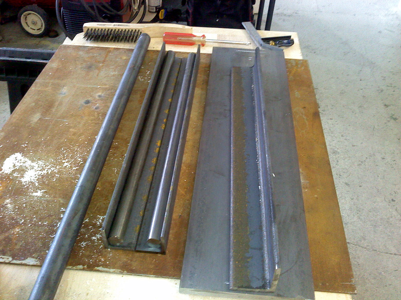

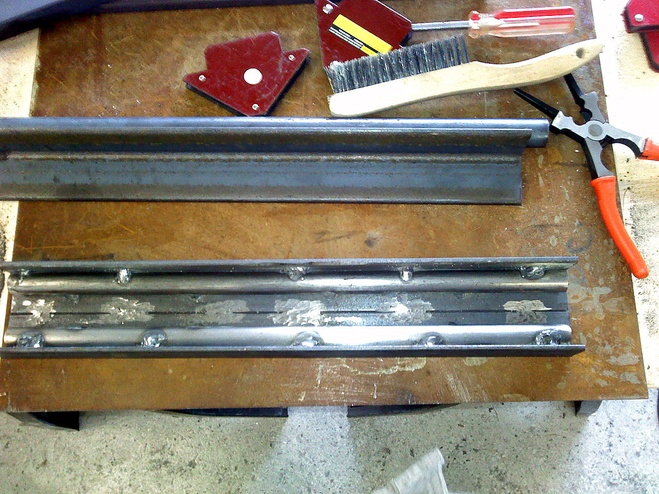

Wyobuckaroo...You've got the right idea! I bought a Harbor Freight 20 Ton Press on sale and used a 20% coupon, paid less than $200.
Here's what I made for a press and it works pretty well.
Here's a link to a press on eBay someone posted just a couple days ago. Really nice unit!!!
Supreme 14" Press Brake w Front Guide Plate Rear Back Stop 20 Ton Capacity | eBay
Here's some pics from when I made mine...
Here's the material I used for the bottom assembly.
Solid round rods and angle welded together to form the base.
Welded the angle onto the above base assembly. The welded that onto the base plate.
Drilled a couple 1" holes and welded in the 1" round stock to for the guides for the "press bar".
I used 1" square bar for the "press bar. Welded some tube to slide on guides. I also welded a piece I bent to provide a flat surface for the HF press rod to sit on.
Here it is pressing some scrap stock I had laying around.
Main driveway is paved. I have a side area for additional parking that's reprocessed asphalt. It's flat and fairly well packed so I think it will work out OK.
