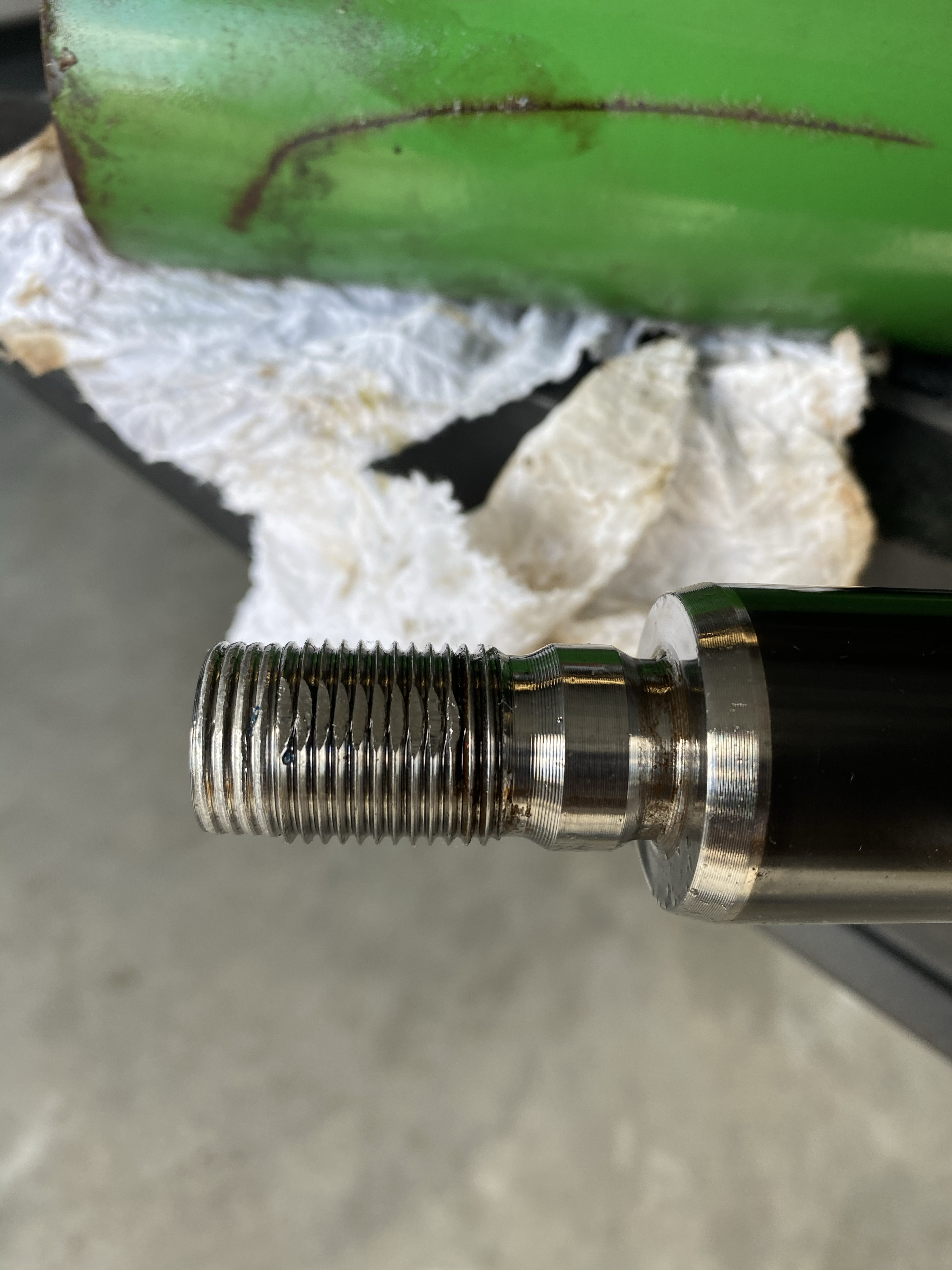

Well I started taking the hoses off & noticed the left drains no oil so I pushed the rod up & oil shot out telling me it seemed to hold pressure.
I remembered the right cylinder draining out yesterday. So I left that one and went to the right. When I took it off I could hear something rattling.
The rod pulled straight out of the cylinder, threads were stripped.
Now the nut & packer is still in the cylinder with no idea how to fish out??? This keeps getting better & better. Heading to JD place to price cylinder & get options on what to do.

The rod price ranges from $200/$800 depending on the cylinder.
The cylinder cost showed to be $700. Evidently they have multiple cylinder types.
They said the hydraulic shop can fix the threads, I may try that this week.

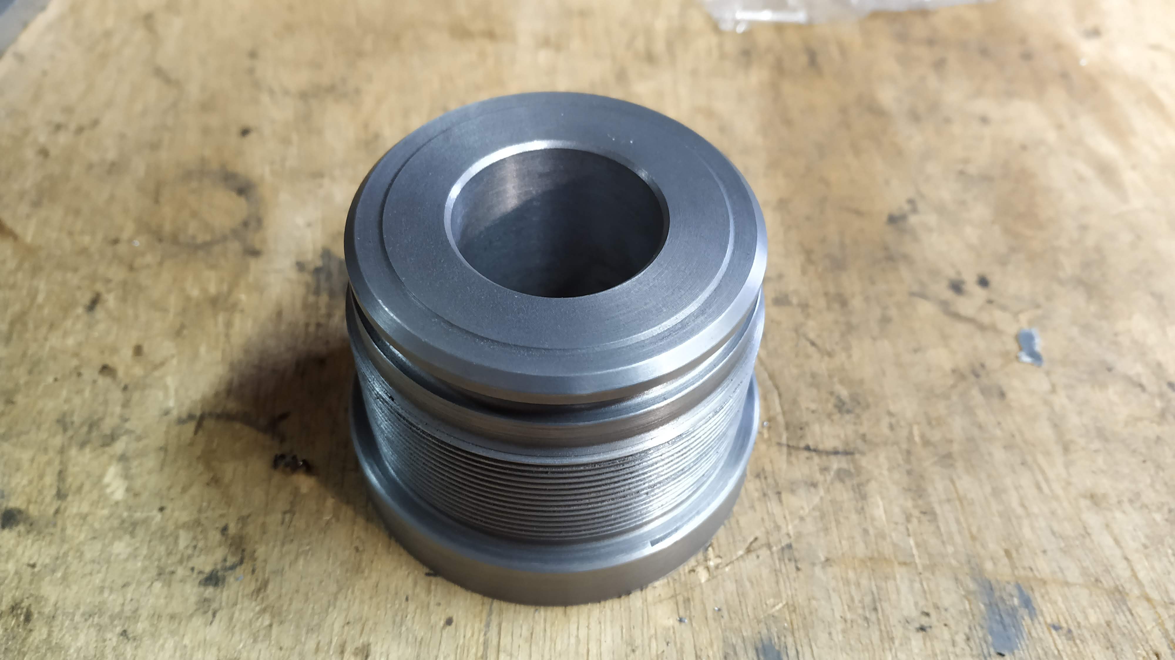

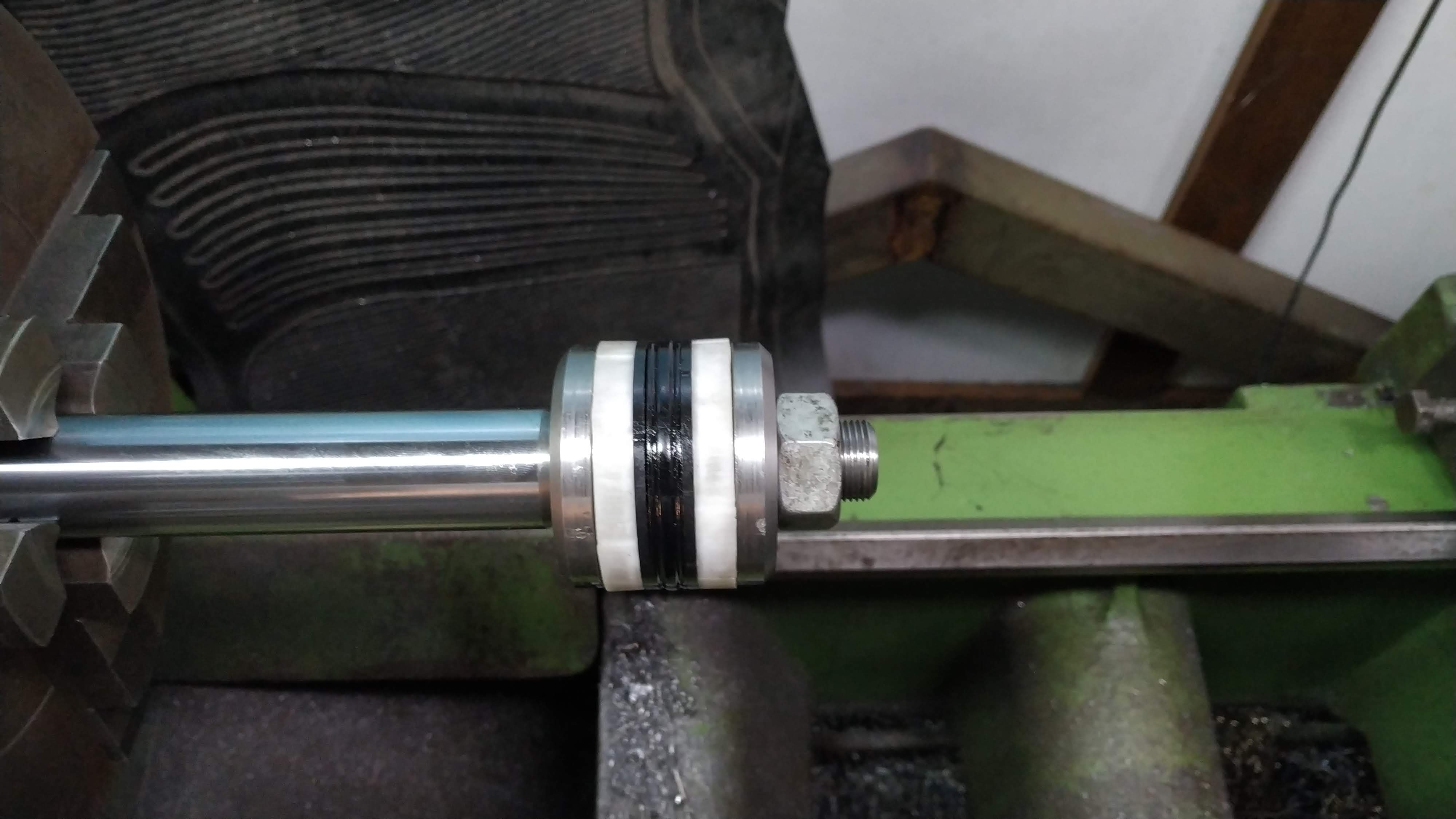

To me this is the gland:
And this the piston:

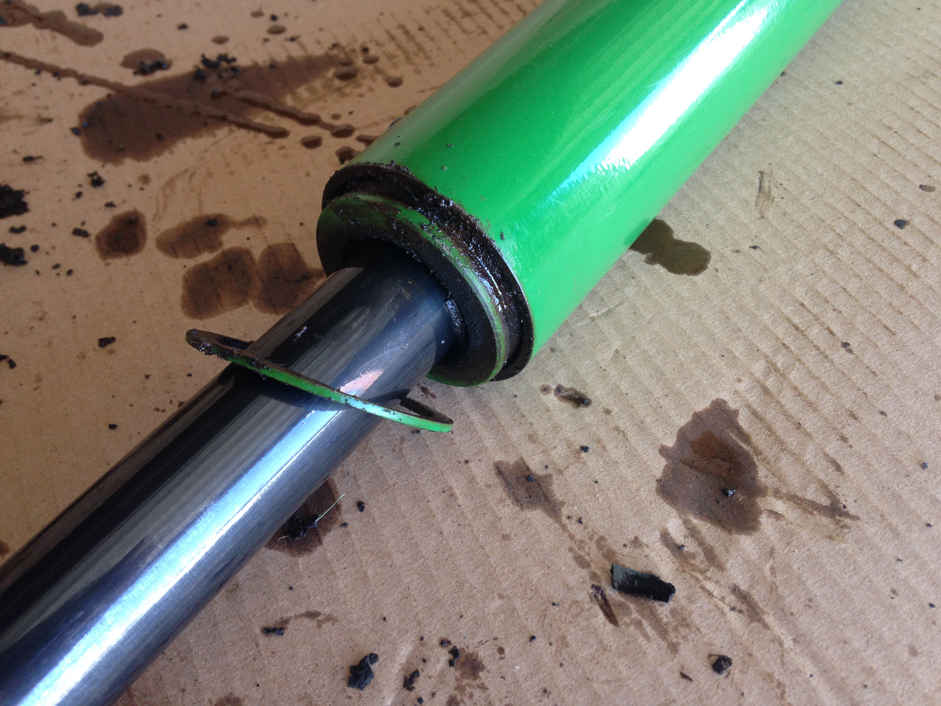

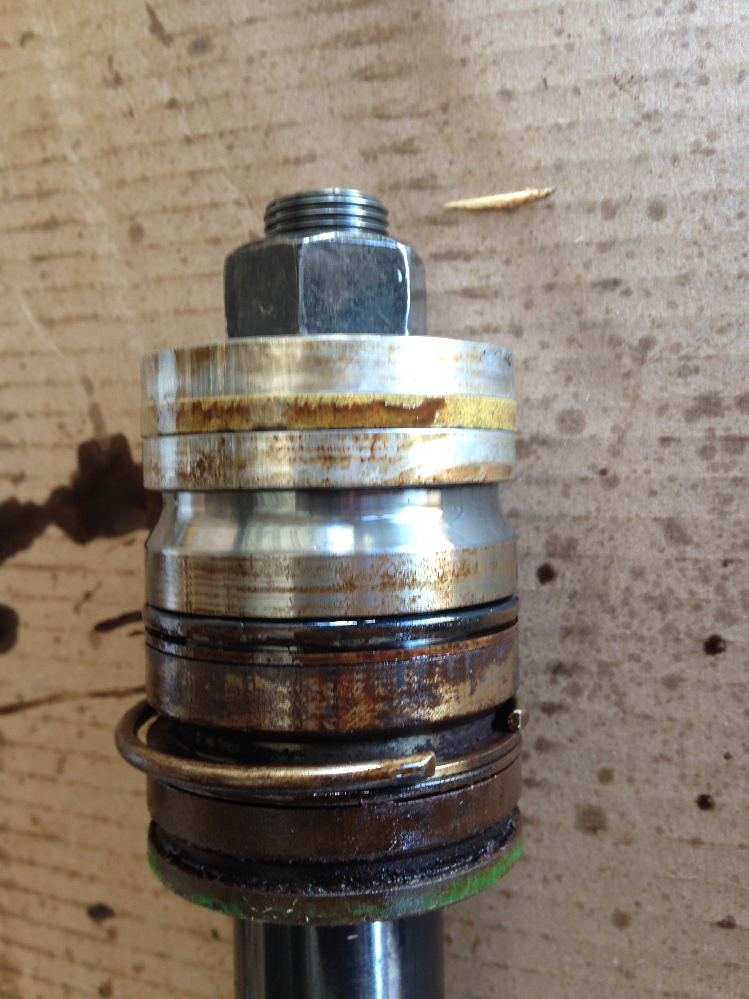

This is on a JD 512 loader. There is an external snap ring keeping the gland from going into the cylinder. To remove, you drive the gland in & insert a plastic ring (in seal kit) in a groove inside the cylinder where the external snap ring on the gland locks in.
Here’s a pic from when I’ve rebuilt these before.
/ Bucket rolled backwards #30
If an inside puller is not avail to you there痴 a way to pop that gland head out using hyd force. First make sure retainer ring is out (and use the plastic groove filler if needed), then cap off both cylinder ports, then stand up cyl barrel on the floor and fill with water within 1-2 of top, insert hyd rod end and slam it with a good sized dead blow hammer. If all goes well the gland will pop out

If and when you get the gland/piston out, install new O-rings and gland I wouldn't hesitate to re use those threads, run a die over them, add some loctite of you favorite color (I would go with red) and put it back together, I'm betting it will last a good long time if you don't repeat what you did to damage it.

Get a piece of smaller diameter rod longer than the piston rod. Weld a bolt to the end that will accept a washer just a little smaller than the threaded end of the piston rod. Put the washer on and double nut the bolt. Feed it up through the piston and let the washer drop down to grab the piston. Use that as a slide hammer to remove the gland and piston. If you can find a rod long enough with a threaded end or all thread you can skip the welding part.

Thanks to everyone for the replies & ideas. Tried the hydraulic method but the caps I picked up didn’t fit on the cylinder to cap off the ports so I’ll try again tomorrow.
We have some large all thread I can use if I can find a washer to fit. That’s a good idea.
Reckon I can use a die over the threads or need to get someone professional to do it?
If the threads look good, go for it. If the threads are trashed you likely need to either build up thread area with weld, machine and rethread.....or have new hyd rods made
/ Bucket rolled backwards #39
Would there be any problem with putting the mostly stripped nuts on and welding them? Sure you can’t ever take it apart again but the rods are pretty much junk anyway if it doesn’t work.
/ Bucket rolled backwards #40
Yep. I'd do that before buyin a new cylinder.
