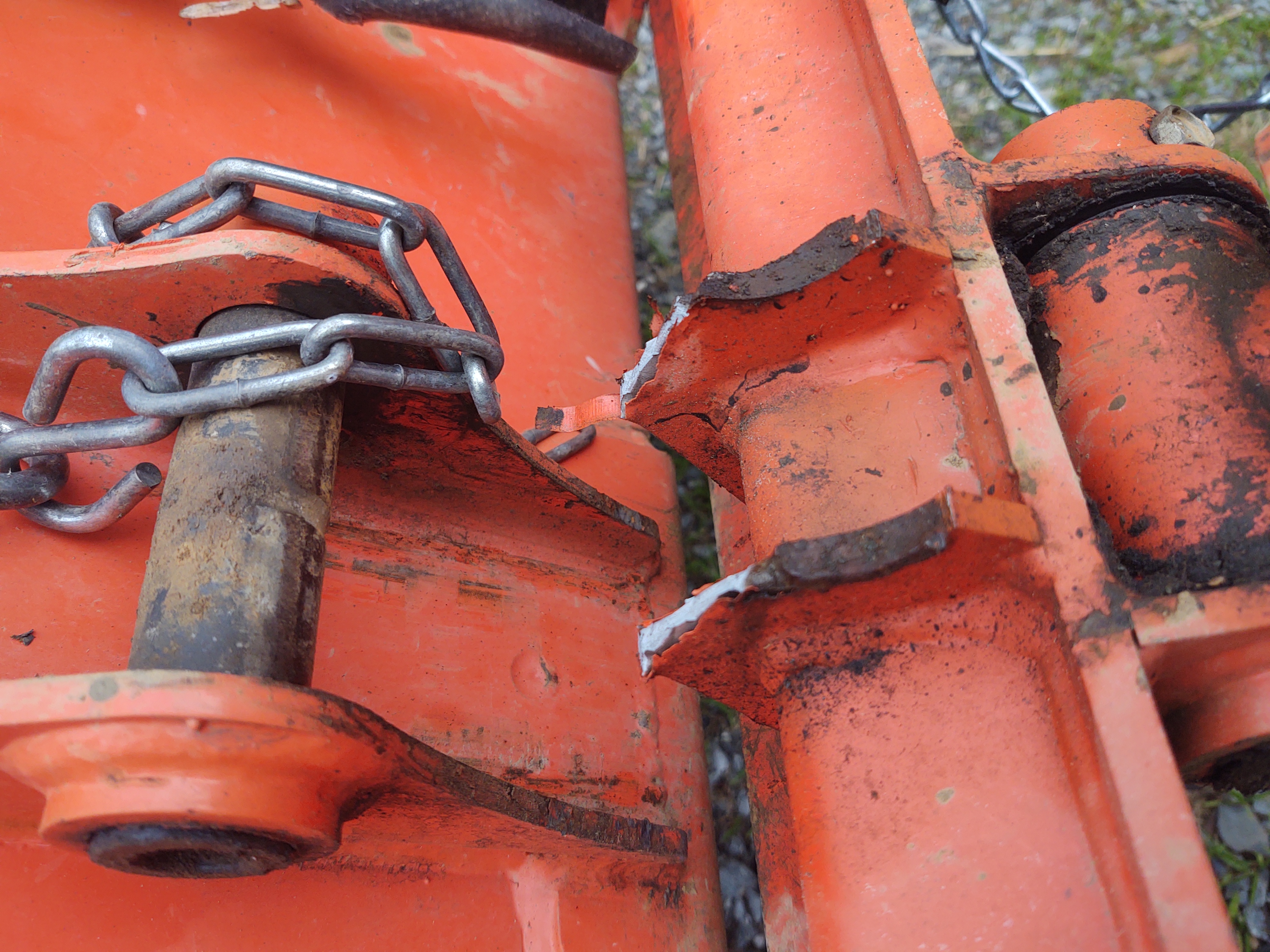

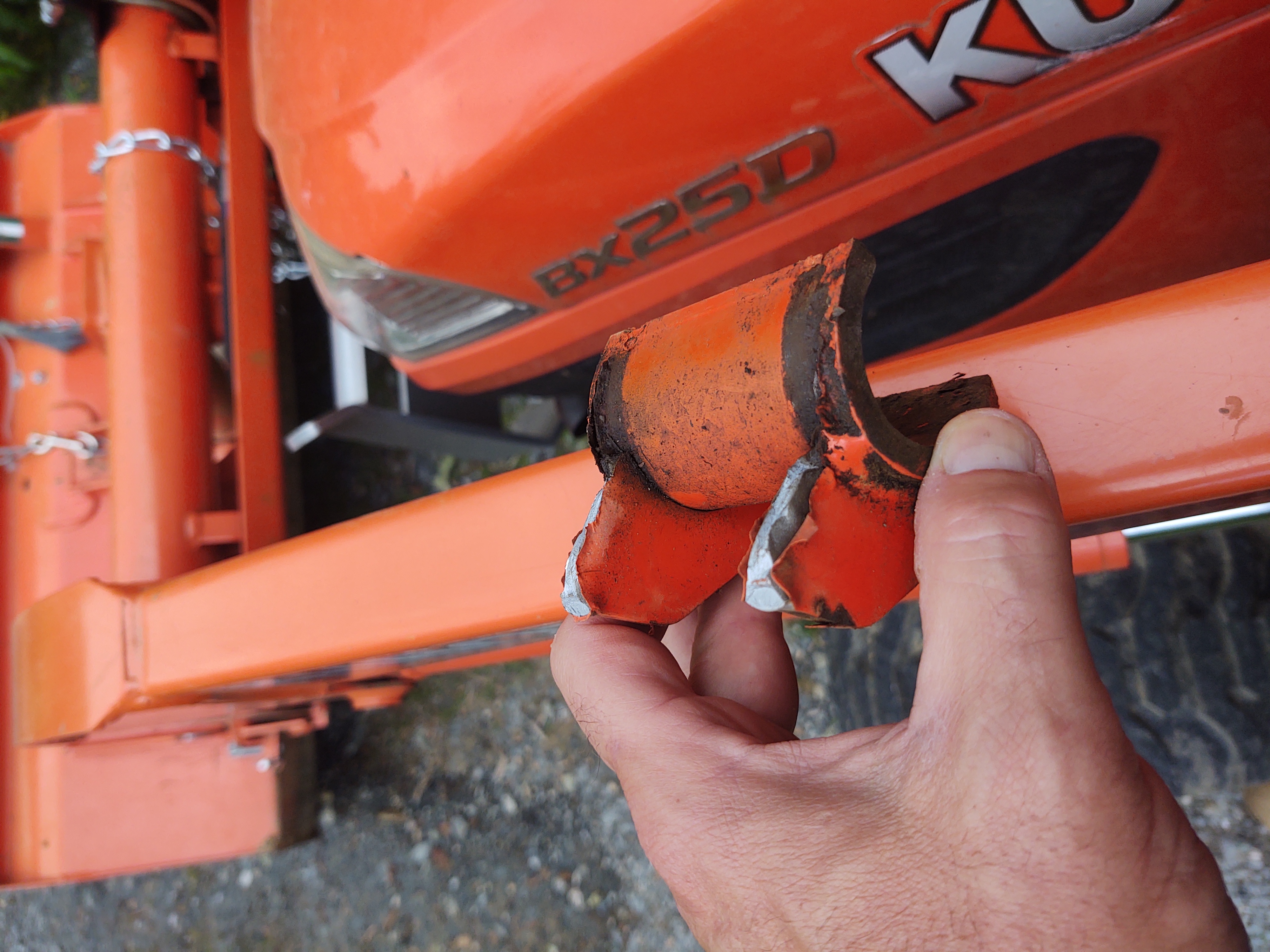

Hey everyone, I was using my Kubota bx25d today and the bucket tilt pivot point snapped. It looks like two of the welds failed but then after they fail the actual steel snapped. I am wondering what I should do about this and if this is fixable by welding or I should take it to the dealer. I don't imagine this is going to be too costly if it is weldable, and I do have k insurance, but I am not sure that this is a situation where it's applicable. IMG_20200625_182420158.jpgIMG_20200625_182454979.jpgIMG_20200625_182420158.jpgIMG_20200625_182454979.jpg

I'd take it to the dealer since you have insurance. If not a claimable repair, weld it.
/ Bucket pivot point snapped #3
It seems that that should be covered by insurance, if not by Kubota itself as a manufacturing defect. it appears that they did not properly weld the area that broke first and is rusted underneath and that caused the rest of it to shear off.

Thanks, that's what I was thinking. Actually, the dang thing looks like they tack welded that point, which is crazy because that one point has alot of stress. The only issue is that the closest dealer is over an hour away and I know that COVID has them mostly shutdown. I can almost guarantee I would be waiting for months for a solution. I have a stick welder, or I could just take the plate off the loader and take it to a local weld shop.
/ Bucket pivot point snapped #5
Take it to the dealer.. Not much grease on that pin... If you have a welder I would just weld it up that would be the fastest fix...........

I would weld that sucker back on, get some orange paint, and let it be done.

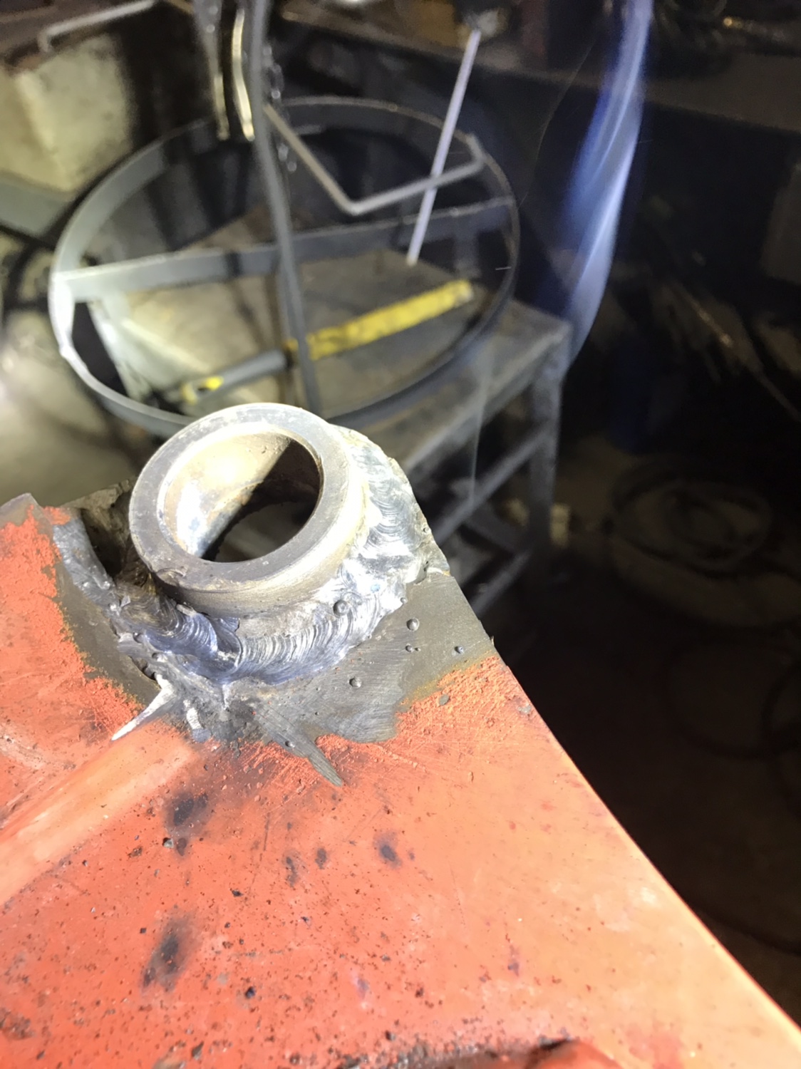

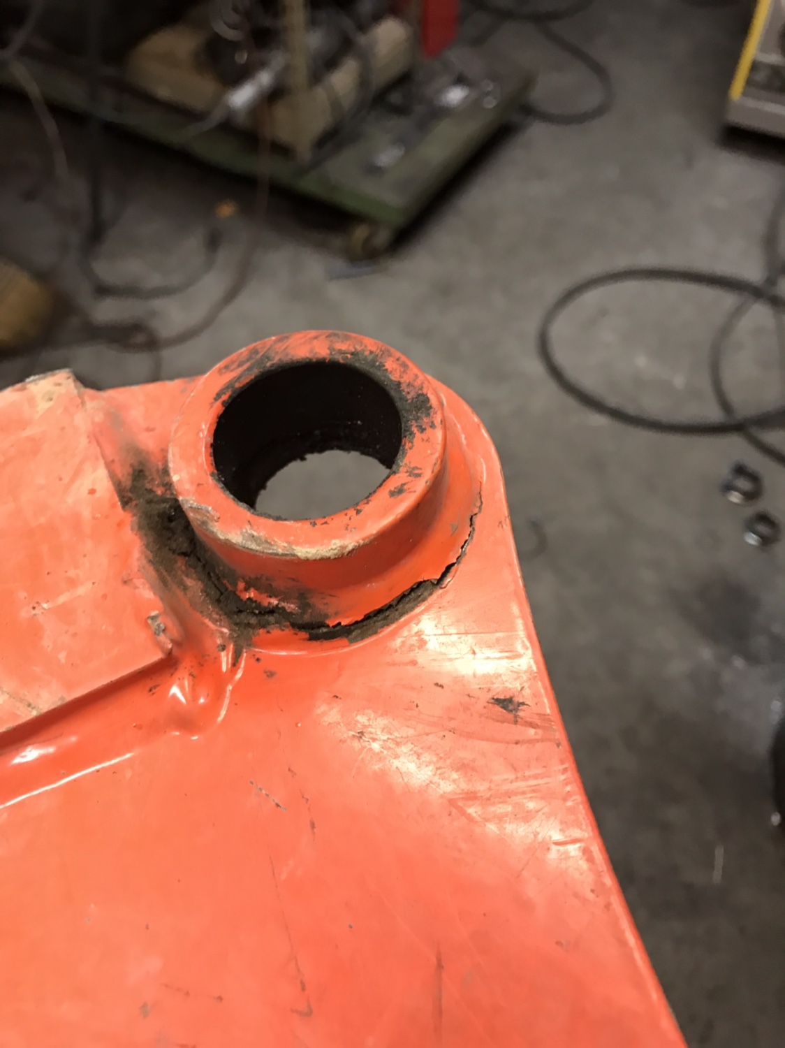

If you’re a good enough welder I’d fix it. I’d have it fixed and digging dirt before you got to the dealer and back. Add in the wait time and a return trip back and that option isn’t looking very good. It looks like you’ll need a new tube for the pin to go through. I wouldn’t use the broken one. Here’s a pin I had to weld back on my M59. This one wasn’t Kubotas fault. My grapple came unlatched in one side and caused this problem. IMG_8821.JPGIMG_8822.JPG
/ Bucket pivot point snapped #9
Did that bushing shrink and needed to to be reamed out after it was welded?
/ Bucket pivot point snapped #10
The SSQA plate is still a little bent from the grapple experience but it went together without any reaming.

I’d weld it if it were mine. Yes, the factory did a sub par weld on it however you can make it right yourself.
/ Bucket pivot point snapped #14
It looks more like a manufacturer flaw than operator error. Your best option was to get your dealer involved first. A few better pictures may help your case and minimize trips to your dealer. What did you find out?
Attempting to repair it yourself looses any future claim of warranty or insurance that you have paid for. For that part.
