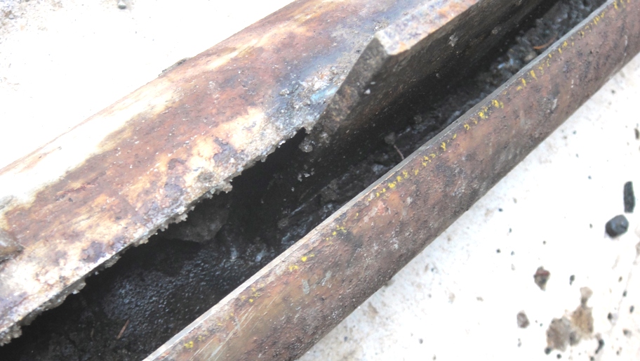

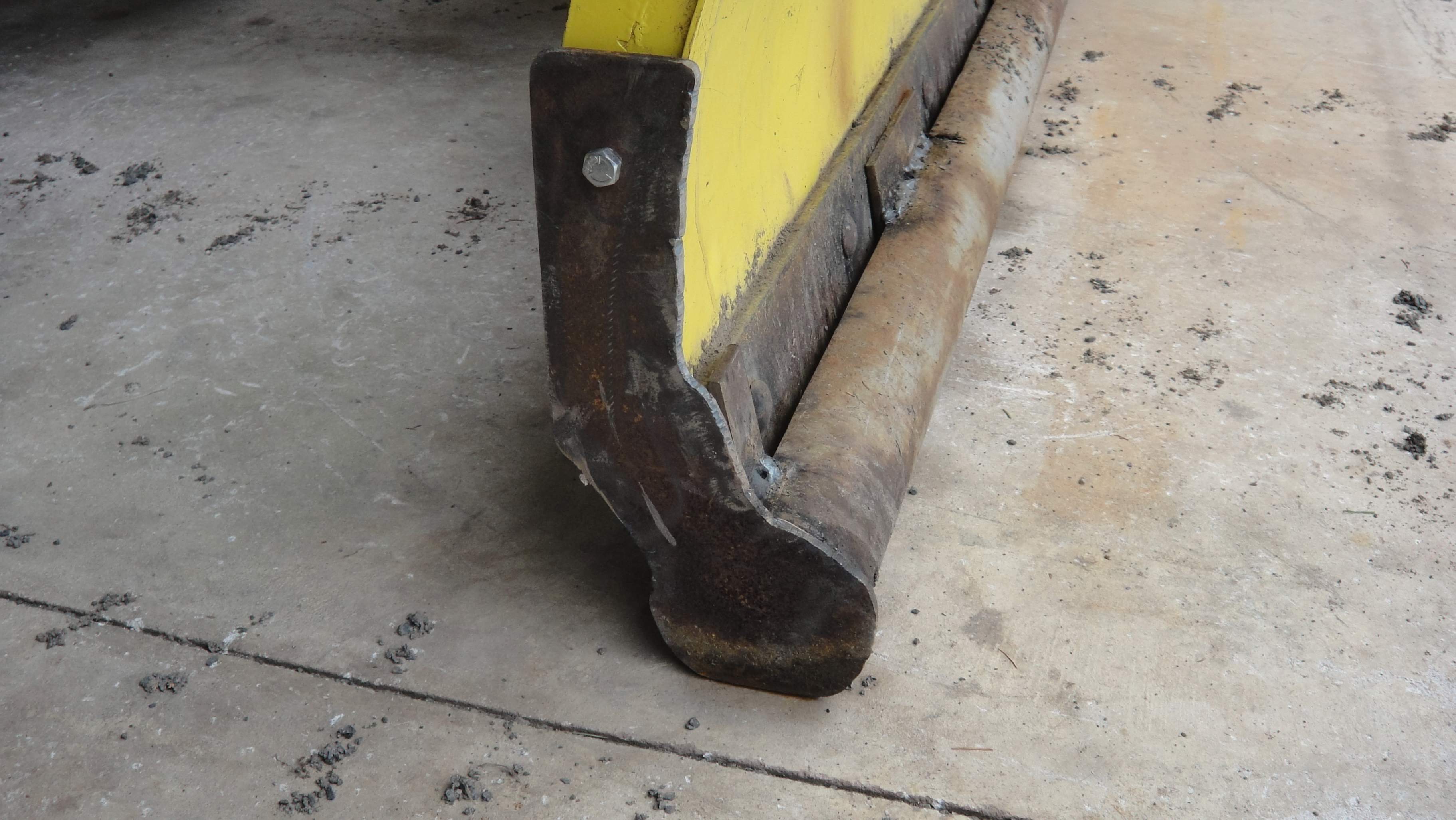

I'm working on a Meyer plow build right now. I don't have skids for my plow.....and I have read where some guys use a slit pipe placed over the blade. This does the same function as a skid - only better....according to what I have read. I'm going to give it a try instead of the skid shoes. :thumbsup:
I've read about folks using plastic tube (polyethylene) and some guys use steel tube.

OK....I read that some guys were pretty happy with a rubber edge.....especially on blacktop. My need is for some logging roads and trails.....so the "finish" is not as important as riding over roots, rocks, and snags - especially when the ground has not yet froze solid. I believe that is the beauty of the round tube over the cutting edge.

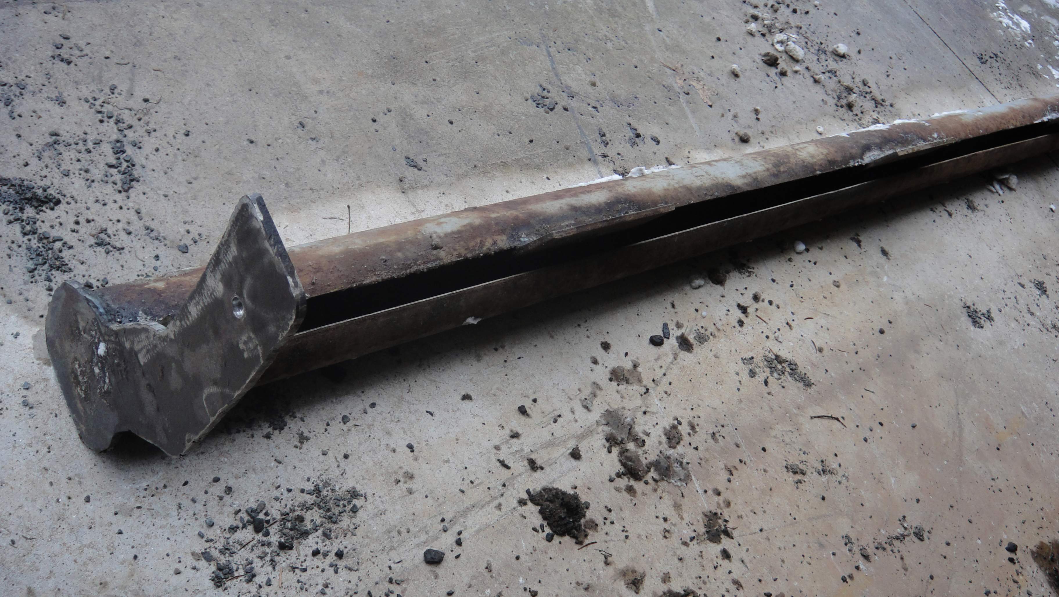

I have heard of the slit pipe idea, what I was wondering how to cleanly slit it the length of the plow. I could see sending a plastic pipe through a table saw, but the steel? Maybe it could be done with a torch.
/ bucket mounted snowplow #10
I have pondered this same question. Torch? Plasma? :confused: I'm going to the welding shop this morning.....and will ask their advice.

Have you thought of a hand held 7" grinder. I think mine could cut a pipe like that. Might be a few sparks though!
/ bucket mounted snowplow #12
The pipe idea (both plastic and iron) has been discussed on here a few times. I cut a metal pipe on the table saw with a metal cutting blade and it turned out well. I also have used ABS plastic on a back blade with good results. For the metal pipe I drilled and tapped bolt holes to fasten it on and make it removable.
/ bucket mounted snowplow #13
Just get a metal cutting wheel for your saw. Table or circular, works great.
