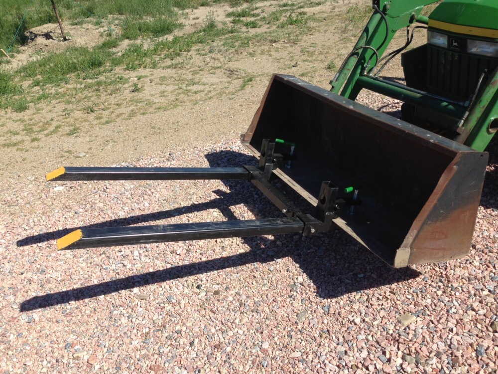

I had a welding shop plasma cut two large hook like pieces from 3/4" plate.
Had those welded to the top of the bucket.
Then took two used single forks, and welded a short piece of pipe at the top of each.
Slid those two forks with the pipe piece tops added, onto a 6' solid steel bar, and added end caps, to keep forks from sliding off.
Works great!
I just drive up to the forks, curl the bucket, and lift the forks (they are now extended from the front of the bucket).
When I want the forks off, I just set them down, and curl the bucket to unhook.
Only problem is that my lift capacity is reduced by both the weight of the forks, and the fork distance forward of the bucket. I can only lift 1000 lbs., but that is enough for me.
Much easier than quick attach.
I never need to get off the tractor to add or remove forks.

What about clamp on bucket forks?
Thanks for the suggestion, however, I'm handling logs and the log grab is attached to the pallet forks. I'm hoping to leave the forks and grab on and find a quick, easy way of scooping up rounds once I have cut them from the log, that doesn't require detaching the forks.

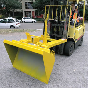

Google forklift tilt bucket. We use them at work with 2 or 3 yard hoppers. Would work well for firewood.
Good idea, thanks, but I will also need the FEL bucket for general other work at which time it will be attached to the FEL in the conventional manner but for firewood duties there are times it will be on and off many times a day. Also, I don't want the bucket there when doing log work.

A common "implement" for forklifts.
forklift bucket at DuckDuckGo
Bruce
Thanks for the image. The bucket would not be much good for general ground work though, so I'd need to own and sometimes drag around with me, both.
Wish I could post a picture for you, but I am 1300 miles from my forks.
Works great!
Thanks for that suggestion, which is certainly more along the lines I was thinking. However I have a log grab on my forks so rather than dangle forks off a bucket (ingenious way you've done it though), I'm thinking better in my case to mount a bucket to the forks so the log grab is there when I need it.
